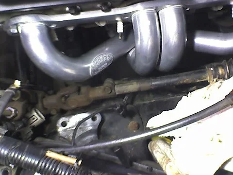

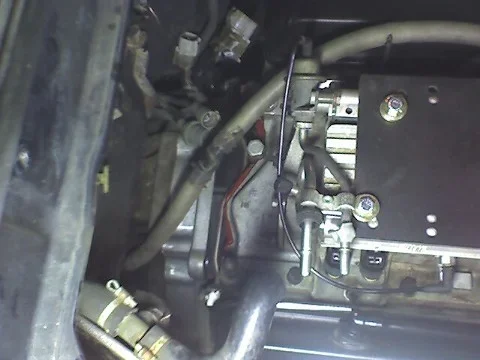

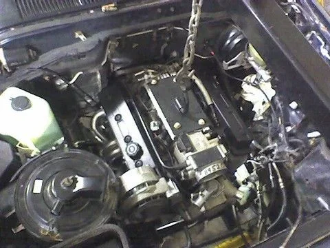

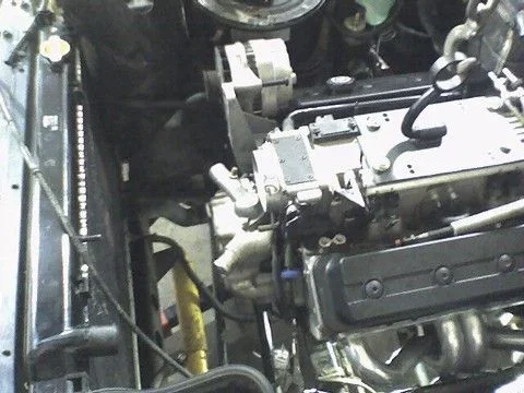

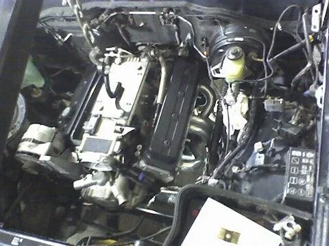

Well I have the adapter here finally. Today with the help of Landwagon (Tim) we test fitting the engine for the first time. It looks badazz, like it it was meant to be. Lots to do now! I am using the LT1 Camaro accy brackets (thanks Gary). I ran up to Summit last night and picked up a set of hooker block hugger headers. They seem to be the best choice with regards to making way for engine mounts, a/c and fitting in between the frame rails. I am drawing a few pieces of the engine mounts now that I will laser cut tomorrow. I hope to have the engine permanently mounted by mid week.
