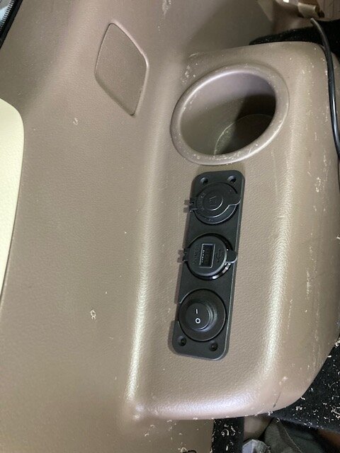

IMO one of these would not look bad and would just involve a little bit of dremel work. Having the on/off switch is very nice - just wire it to a always-hot circuit with a fuse tap (as @r2m suggested), then turn it on and off when needed. I have one in the back of my 470 and it's super useful for charging devices when the rig is turned off.

That's what I put in the back of my truck, and ran a hot wire direct to the battery (along door trim and through firewall). So handy to have!
That looks like a great spot for it. Any clearance issues with the wheel well? What gauge did you run? I'd like to go a little heavier in case I do dual battery someday. I might go with the wire under the truck and up through the floor since I've got my seats out anyway.
Did you just run positive and ground out in the back?
I posted about it here.
I used 12 gauge and connected directly to battery. The switch had a built in fuse but I added another fuse at the battery. There is plenty of room along the door trim to add a larger gauge wire if you choose. Also, plenty of room in that wheel well, I've even been thinking about adding an access port (e.g. via the cup holder) for additional storage space.
I now run my fridge directly off this outlet while driving on a trip (while my portable battery is getting charged from factory AC oulet) and when I'm parked, e.g. at the beach for a day, I'll switch the connection to my portable battery. I don't have to be concerned about my portable battery running out of juice on multi-day trips anymore.
I used 16 ga for mine but 12 ga would be preferable, particularly if you are running a fridge. I usually just use mine to charge phones, two-way radios, headlamps, etc.
FWIW, I ran 8 ga from the battery, through the firewall, then in split loom with the factory wiring under the door sill plates all the way to the back where the jack is. There's certainly room for that. 4 ga might create some issues. I grounded in the rear - there are plenty of places to make a good ground connection back there.
