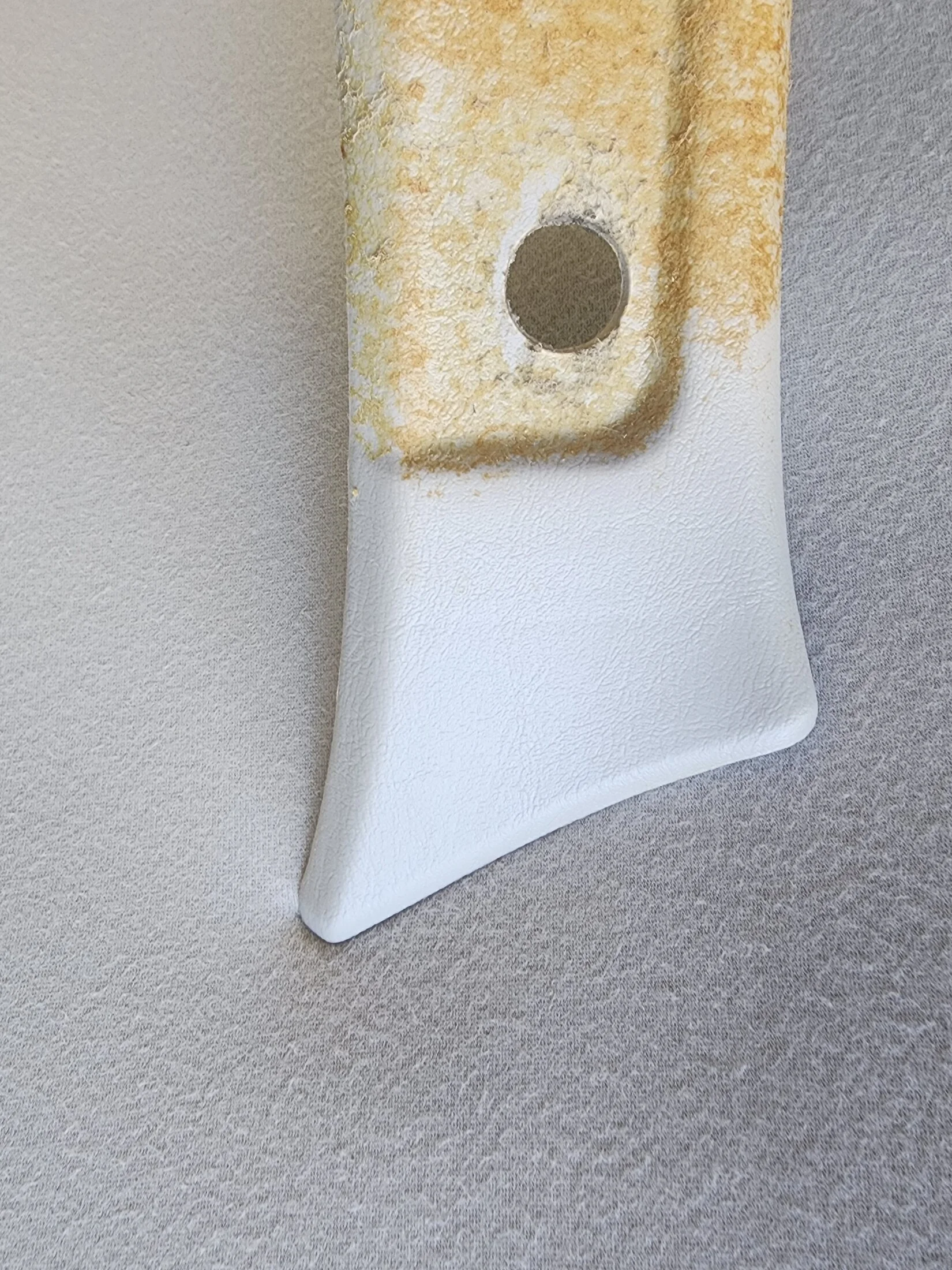

Just to add to what @SNLC mentioned about the pattern hiding under the felt, I happen to be in the process of re-doing my headliner because the SFPO decided it would be a great idea to paint the headliner black on a windy day with only 1/2 a can of paint. My only option was to re-cover the headliner. I also ordered more fabric to do the door pillar garnishes. I am not completely sold on the result so I may, at some time in future remove the new covering and spend a day with a can of acetone and bring them back to basic plastic.
The photo below shows a little of what lies beneath the felt. The material in the background is my new headliner material - the color match is almost perfect.

Wow, that is kind of ugly. Must be some sort of glue that was the original adhesive for the cloth. Hopefully there is a solvent that will cut through it and not damage the plastic. I may have to go that route too.

I think they are so much better as just plastic, super easy to clean.

What you see in IrishReivers pics is indeed factory glue. We have seen this glue bleed through the original fuzzy (felt?) fabric and show as stains. That is generally a hot humid climate thing. I have a European HDJ80 Cruiser and it only has the fuzzy on the headliner, all the pillar trim is just plastic. So Toyota definitely sold them this way.

I got a recommendation for a headliner supplier from someone here on mud but I can't find the invoice and can't remember the supplier. I am pretty happy with the headliner but would not recommend using the same material on the pillars. The material thicker is thicker than what Mr. T used and it interferes with the smooth running of the seat belts. I will be retrofitting all the pillars to the original plastic over the weekend.
