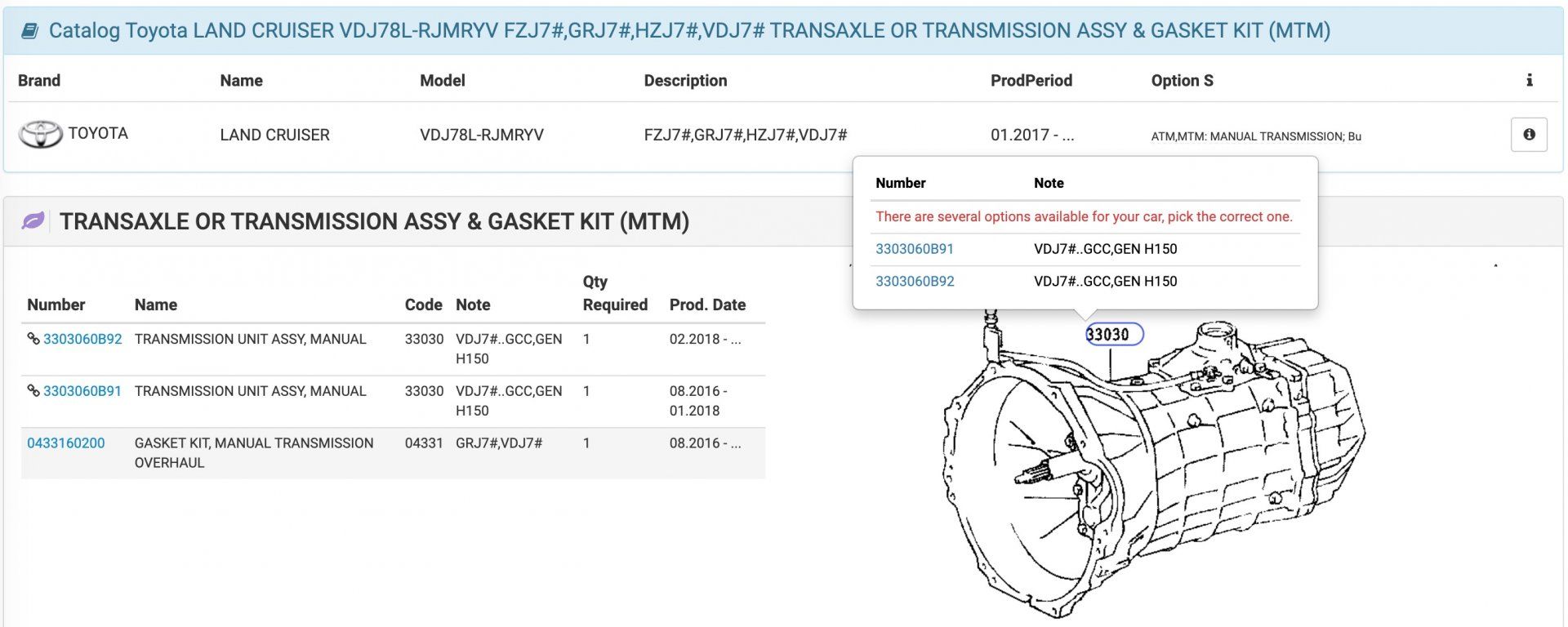

33030-60C50 is the proper part number for H152F gearbox. I’d be careful ordering the above part number as there’s a good chance it will not have the taller 2/5th gears.
I guess this is right. Thanks @Workhorse for your head's up!
The pn# 33030-60B92 is indeed listed as H150, as shown above. This means the GCC VDJ7# did not receive the taller gearbox in 2017.

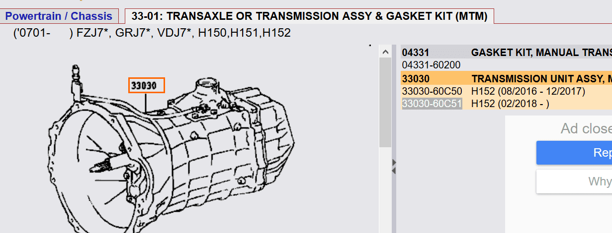

The pn# 33030-60C50, 33030-60C51 are listed as H152.
And unfortunately looks like the H152 is not available in Europe, it is only available for RHD vehicles in Australian market.
