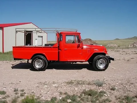

Here is the photo of my new rig. Can't wait to get it home to sunny So. Cal.
Mike
Ahh! My eyes! My eyes!

I may have to fence my front yard once that rig is at the shop.;p
WOW!
