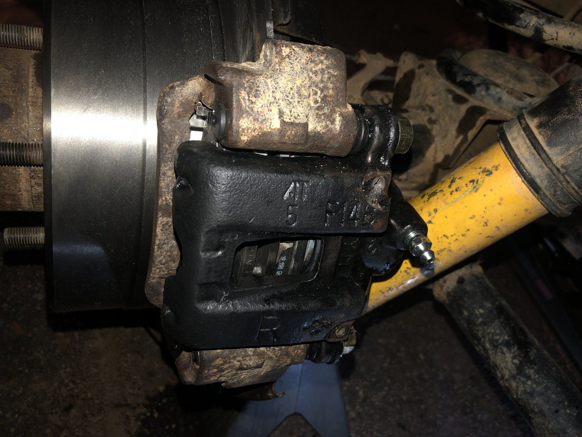

That is the rear caliper... you have to order the one with the mounting bracket if you want that also :)
EDIT: Just add an A onto the part number for NAPA... looking at their website its a few dollars more
On the DS I didn’t specify and got the whole thing, I should’ve checked this time. When I went to pick it up they said they’d have to special order the bracket. I need to inspect my bracket and see if I can use it or not.

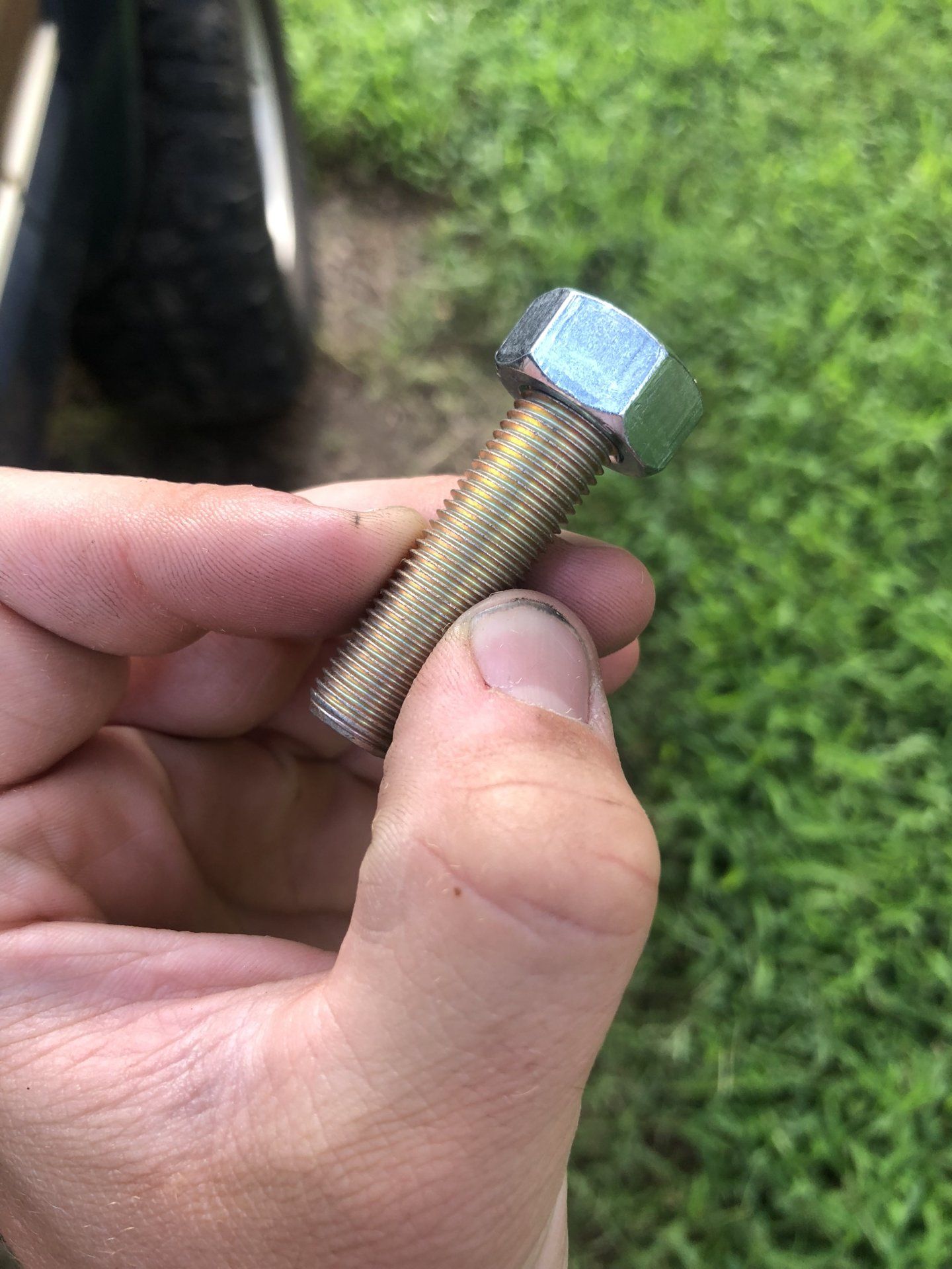

My temporary transmission bolts. Cost $23 for four studs and four nuts. I just wanted to get it assembled, I’ll replace them with bolt bolts before I run it.

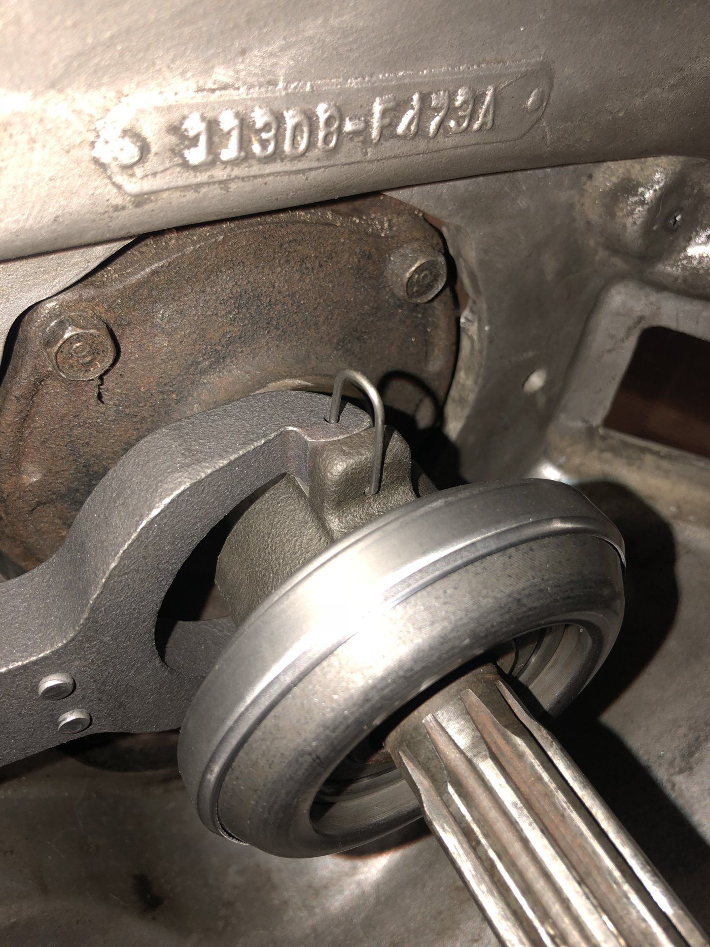

I got the throwout bearing assembled, my buddies Dad build engines for a living and he offered to press it on so it is perfect.
I do want the arm on the passenger side correct?

Pass side is correct. Eric's pulling your leg :D

Anderson, put some grease on the throw out bearing where it rides on the transmission nose, and where the clutch fork rides on the throw out bearing bracket, under the clips.
Def needs some grease up in there.
Also - be sure to fill that cavity / void inside of the hub with grease. If not it may squeal and would be a bitch to get to once installed...don’t ask me how I know.
