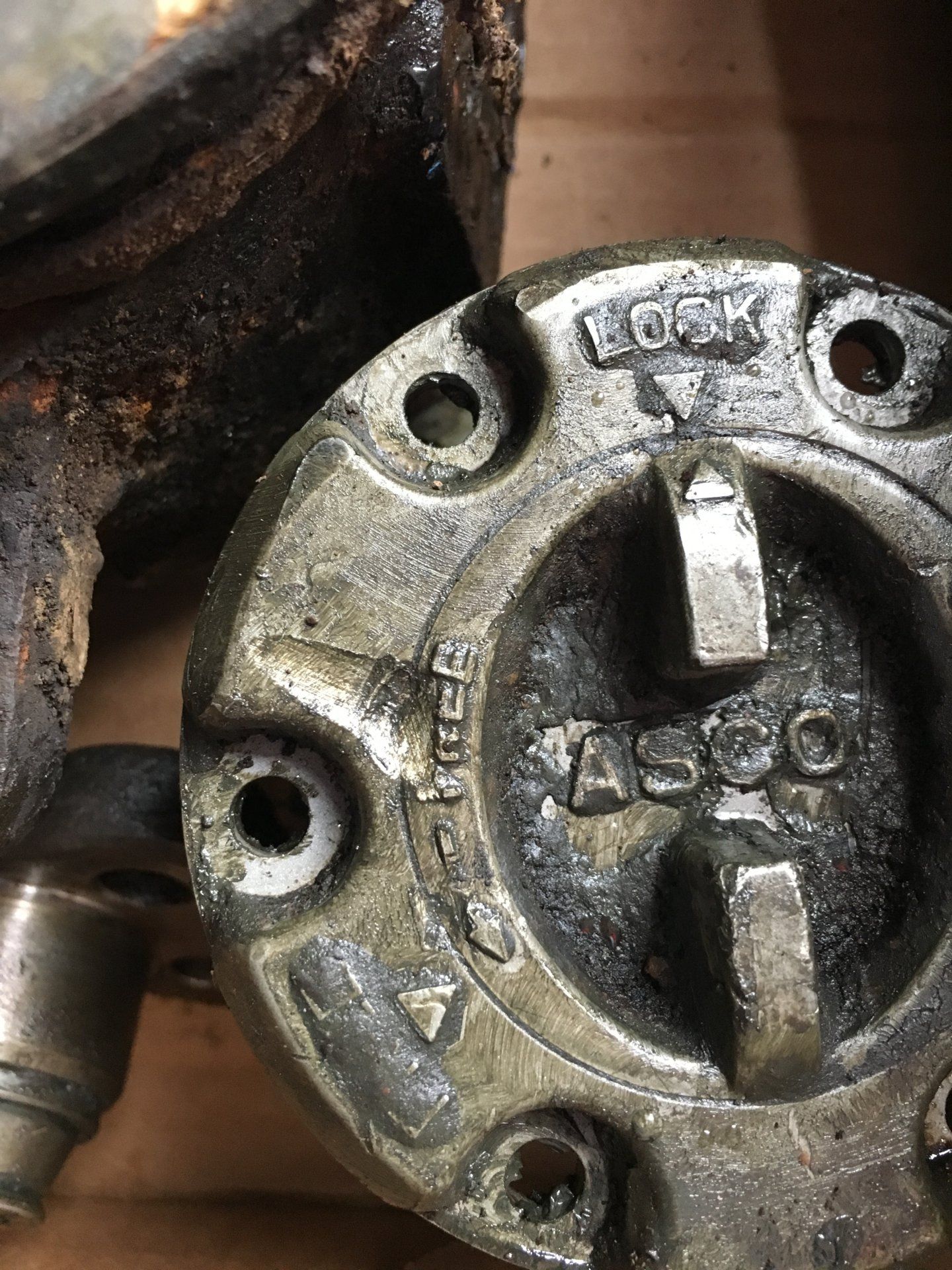

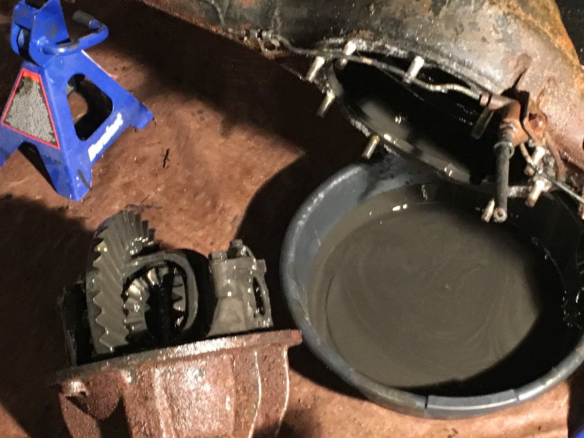

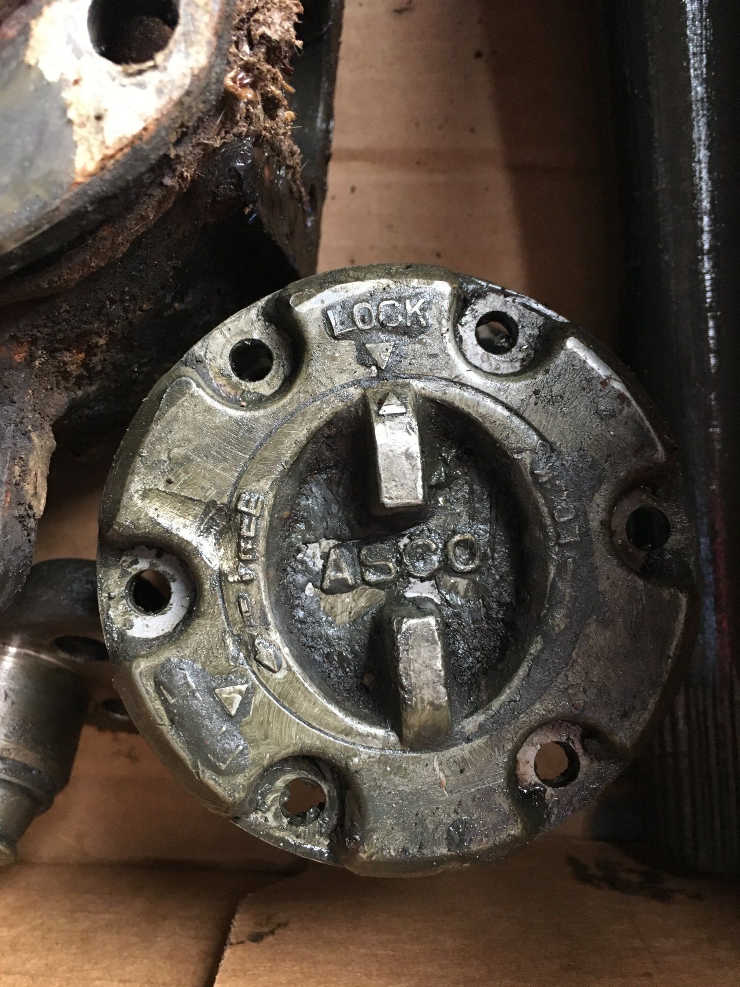

I bought a 78 axle for the 55 when I thought I needed disc brakes. Got it torn apart and one of the faces on the hub looks like it was damaged and won’t allow it to turn. I’m thinking of filling down each surface but looking for suggestions. All these parts, minus hubs, are for sale if anyone needs anything
View attachment 1644973 View attachment 1644976 View attachment 1644980 View attachment 1644981
They come a part very easy. Soak them paint them and you should be good to go.
