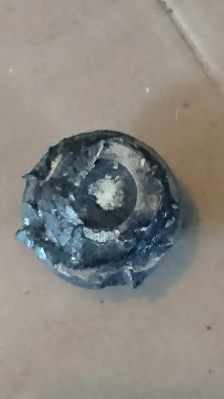

Do you think if I whack a few more grooves around the perimeter with a chisel, this transfer case fill plug will be usable for another several years?
ouch
Don't recall seeing a drain plug that buggered in the past
