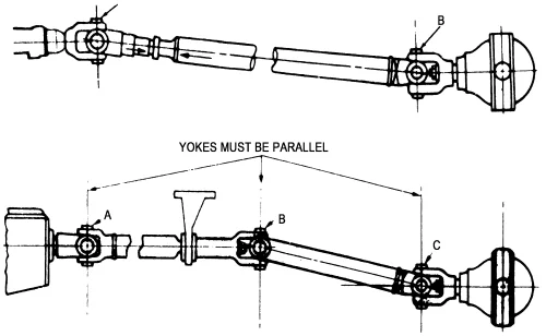

That said I was wondering if anyone has swapped the relatively long rear shaft for a 2 piece arrangement like you often see in box delivery trucks. That in combo with a significant upward turn of the rear axle, like is done in a spring-over, only moreso, would make for a lot less exposed drive shaft.

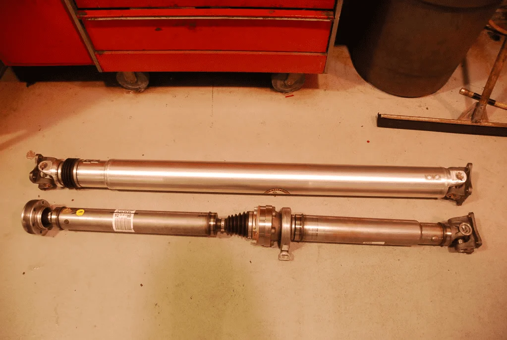

Also is the 1 piece in your pic from your 60? Custom job or did you order it from somewhere?
You’d be adding extra angle, more stress on the joint, and also more operating range for the rear part of the shaft. Also you have an H55f/toybox right? So your rear driveshaft should be pretty short already.

The drive shaft pictured is not mine. It's just a grab from the interweb.
I agree that the angle of the joint would be steep. And the amount of work involved might not be worth it. It was mostly a hypothetical question
I guess you could make the first drive shaft section short to keep the angle from being as steep.

I don’t think it’s worth the effort and extra set of joints and parasitic loss just for inch of clearance on already short rear driveshaft.
