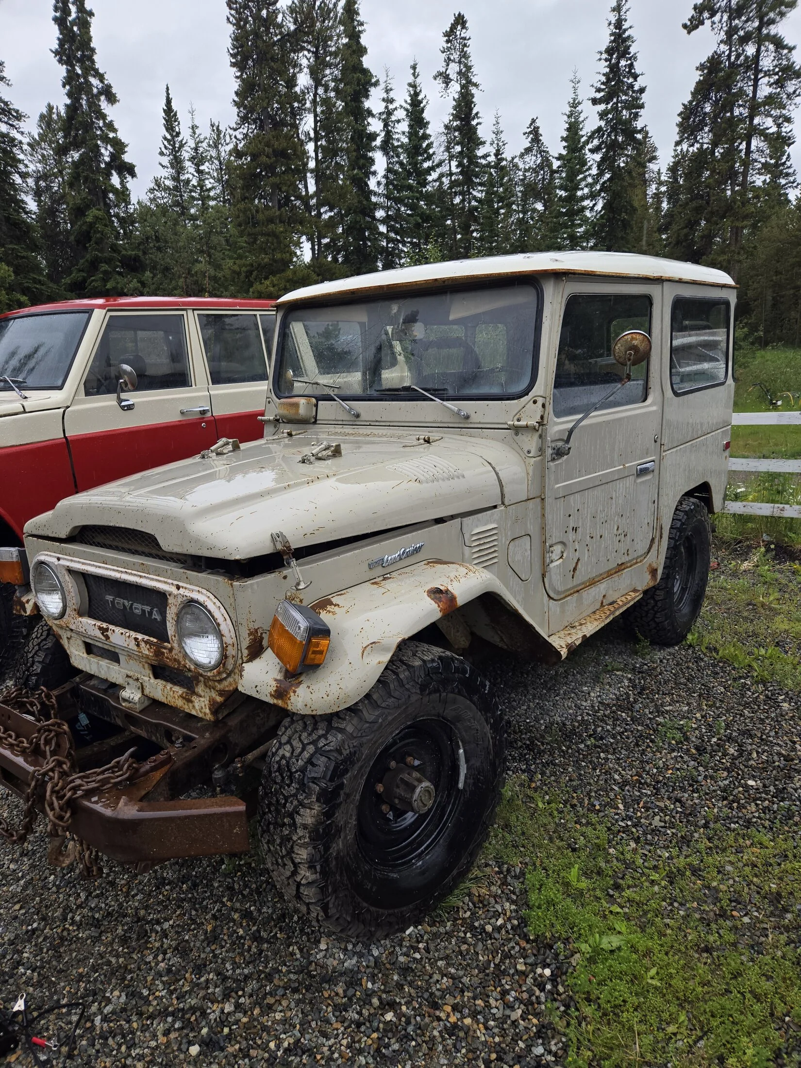

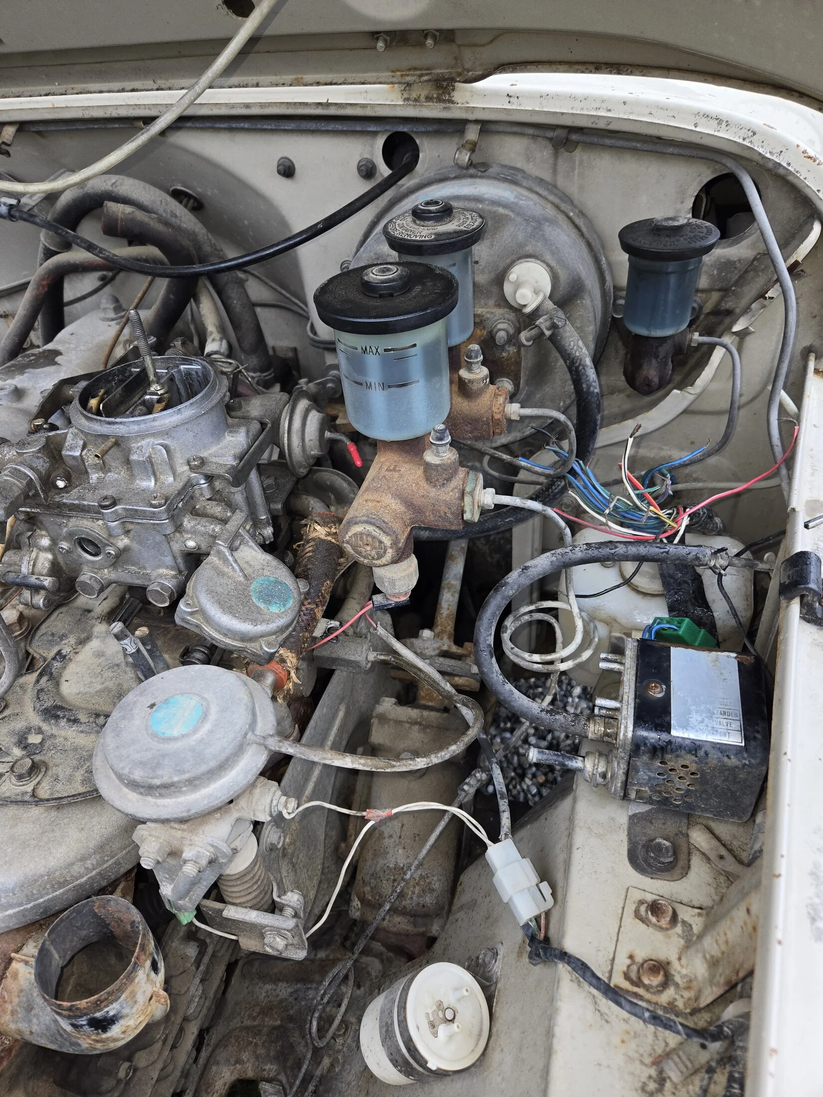

Starting on a refurb of a 40, the PO has "deleted" the EGR.
Is there a good thread on tuning post delete?
I don't want to get into a debate about reconnecting everything, I know if left alone EGR is fine, I don't think I have all the bits now, so am looking to just tune it up.
Truck itself is in amazing condition, April '75, no bubbling at the rear fenders, rockers in good original condition, no rust through on the floor pans etc. I already did the rear sill to 2x2 replacement, swapped out a broken rear leaf. I have to change the clutch master and will swap in a disk brake axle up front.

If you get an early carb, take off all that vaccum egr stuff off. Choke breaker, I forget what else. It's not needed.
you might need to get slightly larger carb jets depending on your elevation. Today's gas sucks and the original jets are ussualy too lean for today's gas. The only way to get around this is to use ethenol free gas. Then the carb works as it should. It's an easy fix to do if you decide to change out the jets
Set your idle screw either by ear or vaccum gauge. You can connect to the highest vaccum port and change your idle and see at what point you get the highest reading. If you do it by ear, turn the screw in so it sounds like it's about to die. Then back it off until it runs good. Then keep backing it off until it start to run rough in the other direction. I think it starts to "pop" and you won't notice any further increase I rpm once you reach a certain point. Zero in on the adjustment until it runs as smooth as you can possibly get.
Don't forget to cap off any unused vaccum ports as well. There should be one at your distributor, and a few around the carb, and any that were ocne connected to you egr

@dmaddox - current syptoms are very hard starting , despite fuel in the bowl and good spark. Occasionally responds well to a quick start vapour. Once running idle is a littl high, but fine. Stays started once running. When I first got it, the tank barfed so old fuel through the carb, so it may jest need a good cleaning there or a rebuild.
@charliemeyer007 ; @DesertFJ40 - I haven't checked the timing and advance as yet, but I think in order I will do the timing, clean the carb, maybe rebuild the carb. Altitude is a little high here in Whitehorse at 2200'.
Appreciate the suggestions folks, I was mainly concerned that something tied to the EGR pull was the issue, sounds more like a good tuneup and good to go, thx
EGR/desmogging may only create vacuum leaks. I agree with you here, @YukonCruisers - get the carb cleaned/sorted and the idle circuit blown out so you can confirm a clean jet during idle. Then go after timing. Valves could likely use an adjustment, but that wouldn't cause these issues, just improve power/efficiency as you know. The vacuum leaks/egr removal - after you get a good idle, even if a tad high, spritz around the base of the carb and around the manifolds to see if vacuum sucks in the cleaner (and the rpm will change) - and then address the vacuum leak. After that, will be easy to dial in timing (assuming the carb is squared away). Good luck.

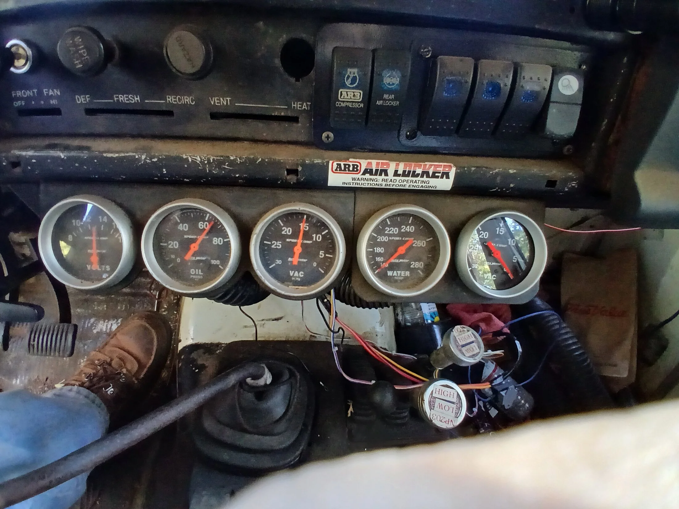

Get a vacuum gauge and get baseline measurements before and after each step you take. It’s actually quite rewarding to see numerical improvements.
Compression test
Adjust valves
Second compression test
Set timing
Lean drop carb

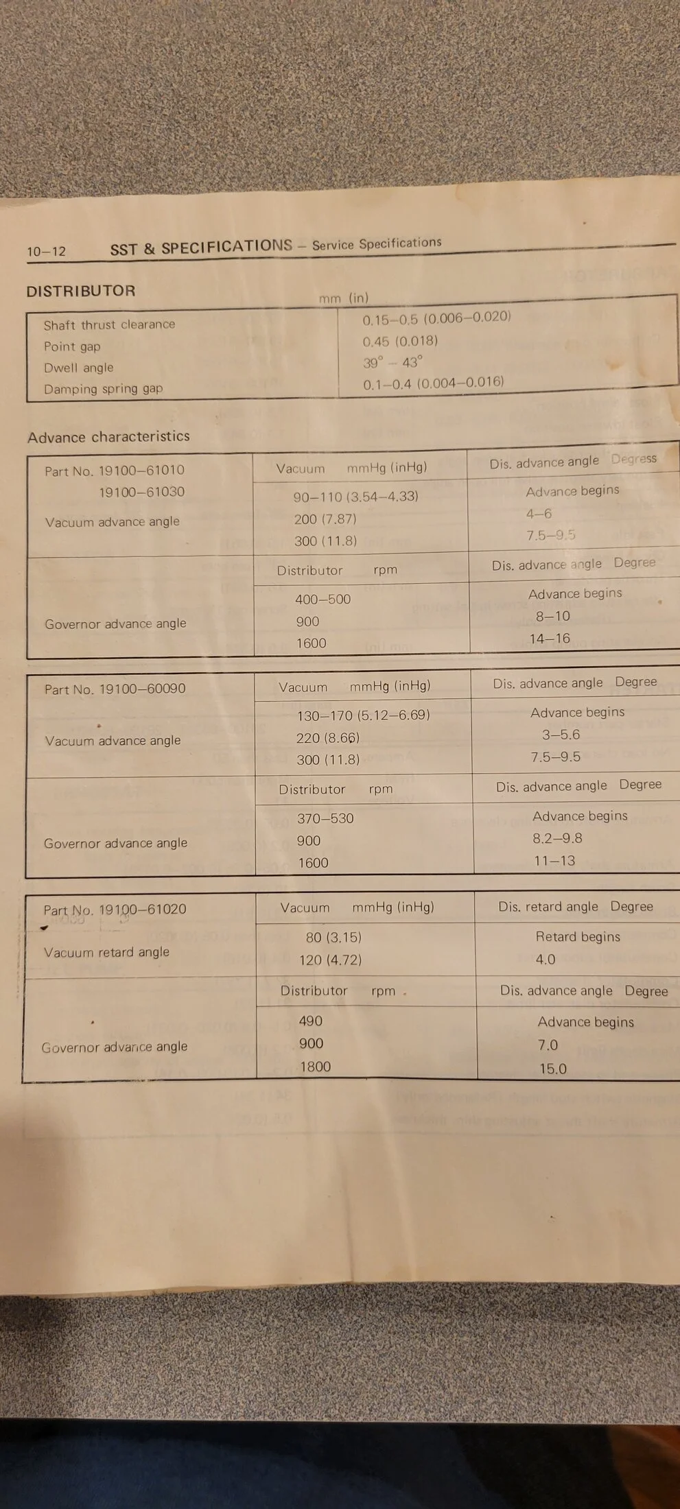

You're saying, then, that manifold vacuum is as good as ported vacuum for your vacuum advance distributor? I'm afraid I'm going to have to disagree. I do not have the benefit of an old story with a race car driver who has "science", all I know is from hooking 2 vacuum gauges to one carbureted F/2F block and driving it around for a few months. I've always had an indash manifold vacuum gauge, then I T-ed into the line between the carb and dizzy with another gauge. Now i know, sorta, how much vacuum my particular engine pulls from where and when. I don't pull a lot of ported vacuum. None at idle but it goes up as I ask for acceleration. But only goes up to maybe 8 or 10"/Hg. with a heavy foot, more usually 5 or 6" with casual driving. If you hook manifold vacuum to the dizzy, you'll be at full advance while at idle and your advance would decrease as you applied throttle. And where my manifold vacuum is weakest, climbing a long hill in 4th, my advance will be least as well. Which might keep pinging down, now that I think about it. I wonder if it might be better to run without vacuum advance than get vacuum at the wrong time. And how much vacuum does a dizzy diaphragm need to give how much advance? That's something we need to know.
And the spot where the BB disappears is more like 17* BTDC than 10mmHg.

Okay so I had to find that article (actually a forum board) where I read about it. One of the guys name is Dave Rey. He was mechanical engineer that worked for GM doing ignition systems and created his own version of an HEI distributor. The other guy I can only find thst his name is "JohnZ". Another GM engineer. I'll try and paraphrase it more, hopefully tomorrow, since it's getting late where I'm at..... But I will post his reasoning behind manifold vaccum advance being superior to ported carb vaccum on the next post below.
Apparently though, the ported vaccum is best only for engines running the the egr or emissions systems. I can't explain it all right now, and the posted article from the forum board may be a bit confusing. But, what you observed running you vaccum gauge and seeing the drop when you give it gas to verus when you're at idle goes exactly to what this guy is saying. Have a read!!! :)
And here's the original forum post. The part we are wondering about starts to get answered around the halfway mark of what I posted below
Manifold vaccum johnZ
I also like your gauges. Very mad max like :steer:
