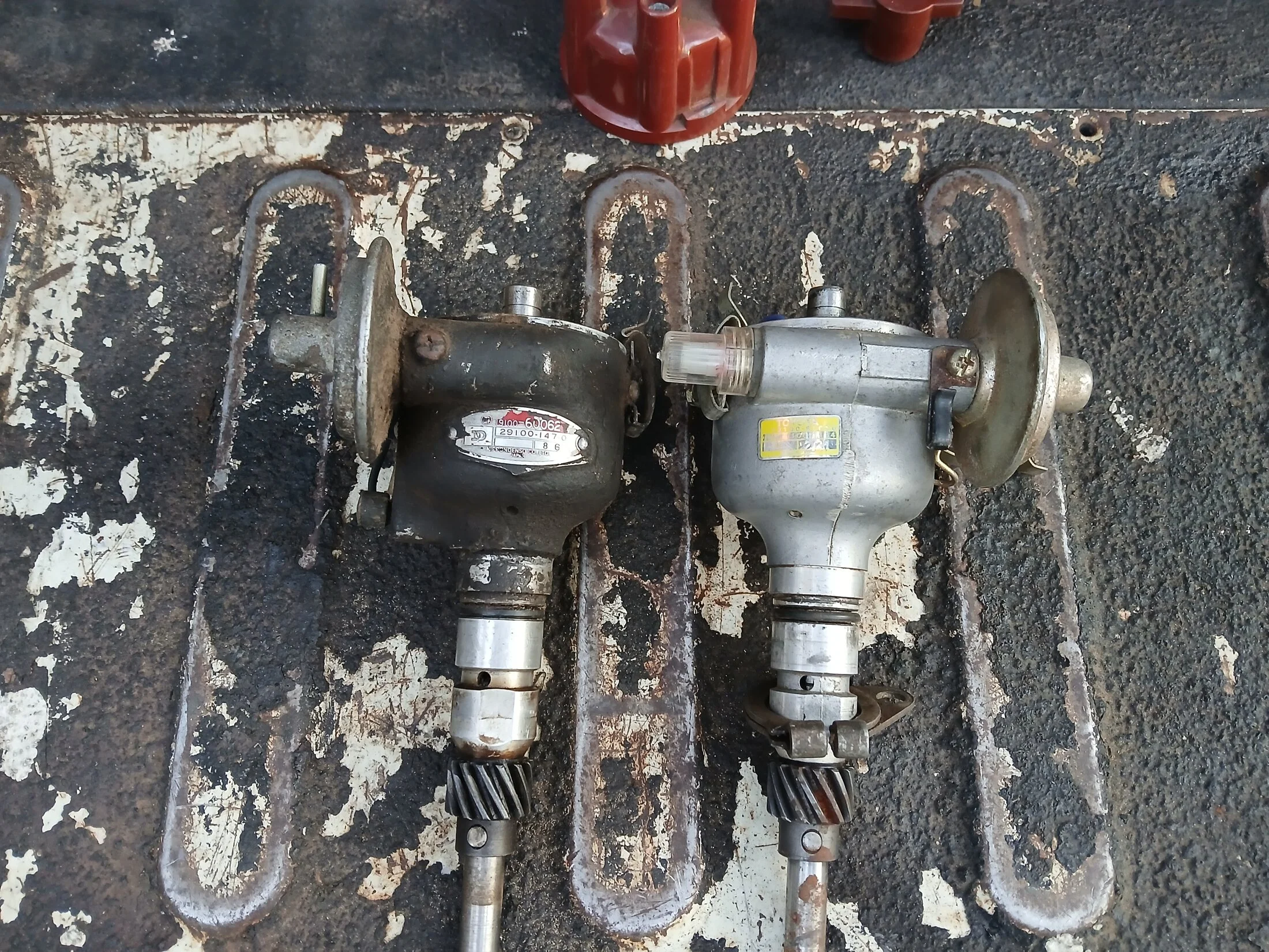

Two dizzys, one vac advance, one vac retard
Not only could it be the vacuum retard, but the diaphragm in the vacuum can could be leaking internally. If it’s running better with the vacuum to the distributor disconnected, I’d start with looking at distributor.
Sounds like you isolated it to a distributor issue by pulling the vacuum line. You can test the diaphragm by just sucking on the tube and watching the guts move (or not) with the cap off. Years ago on a 1970 I changed from a retard to advance type distributor with an external adjustment like the one on the right and it dialed in and ran really well.

You have not indicated whether your distributor looks like either of the ones @Pighead was kind enough to post pictures of. And your latest post is still ambiguous to me. So I would suggest either posting a pic of yours, or acknowledging which one of the posted ones yours looks like.
Just to follow up on this thread- it was indeed the distributor. Apparently, on some of the DUI distributors, the cap can be indexed in two different locations. As I always do, I just happened to choose incorrectly.
For this model, you want the notch in the slot closest to he wire leads.
