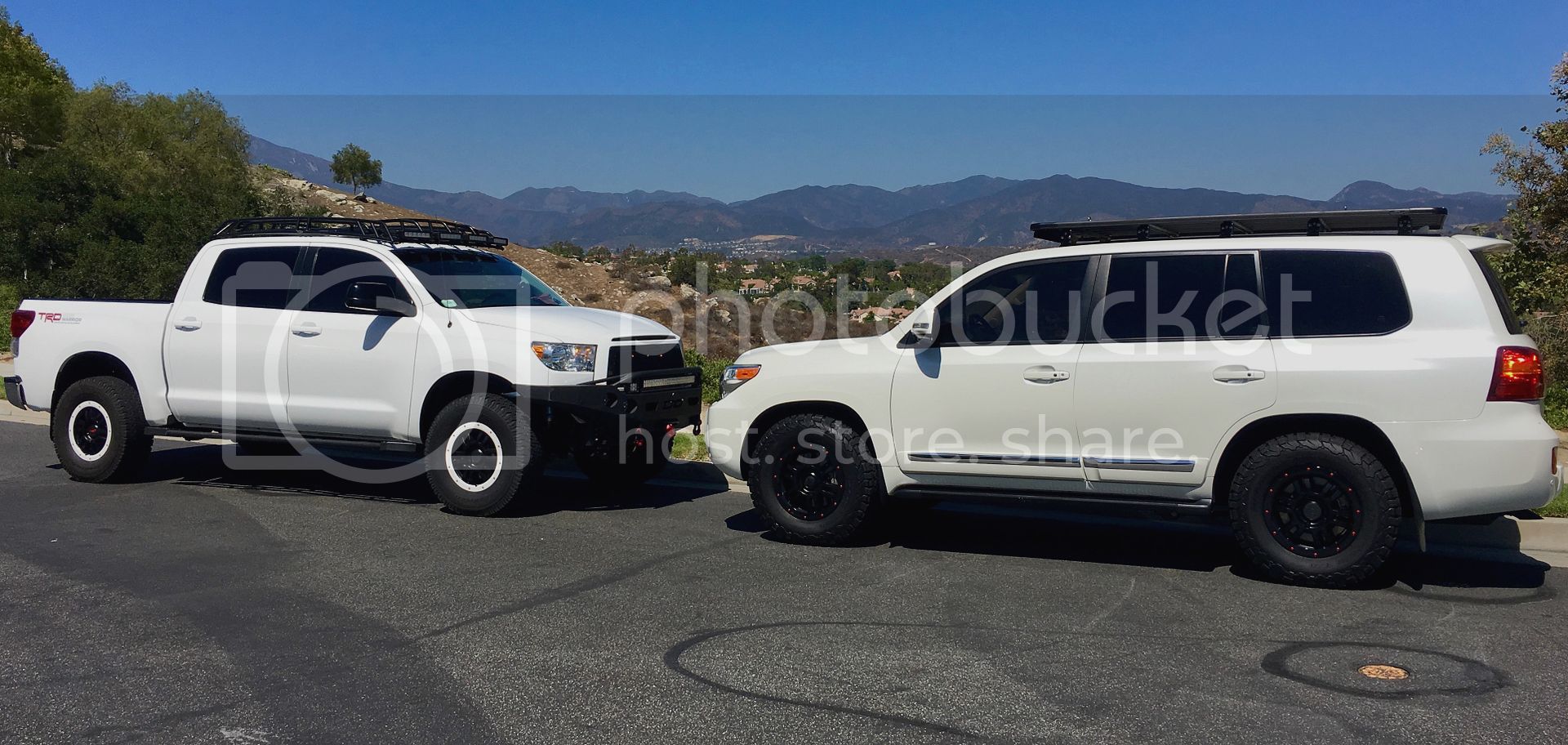

Love the get both idea! :rolleyes: Nice setup you have there. After reading the posts from owners, I'm thinking the Tundra is actually a pretty good value. Basically a Land Cruiser drive train in a truck configuration. Add a shell for enclosed gear and I think that's hard to beat for the price of admission. I'm finding nice 1 owners in the high 20s-low 30s. I am going to miss the tight/technical trails the 80 has gotten me through, but I really think it's time to thin the heard. I also have two young kids and the ability to put a couple KTMs in the bed seems like fun too.

Ha! I showed this to my wife with a big grin and my eyes wide open. She looked me straight in the eyes (like my mother used to do) and simply said, "No."
But, I think I may screen shot this pic and post it on the the LR4 forum and pretend that this is a pic of my new LC. ;-)
