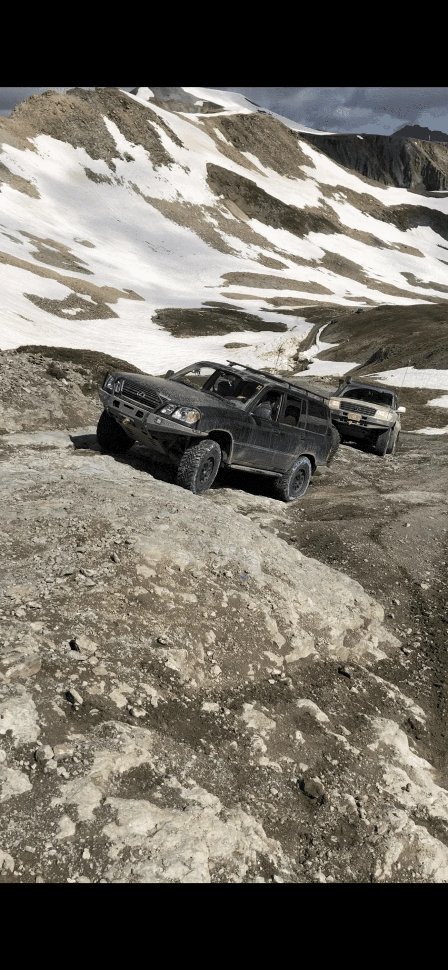

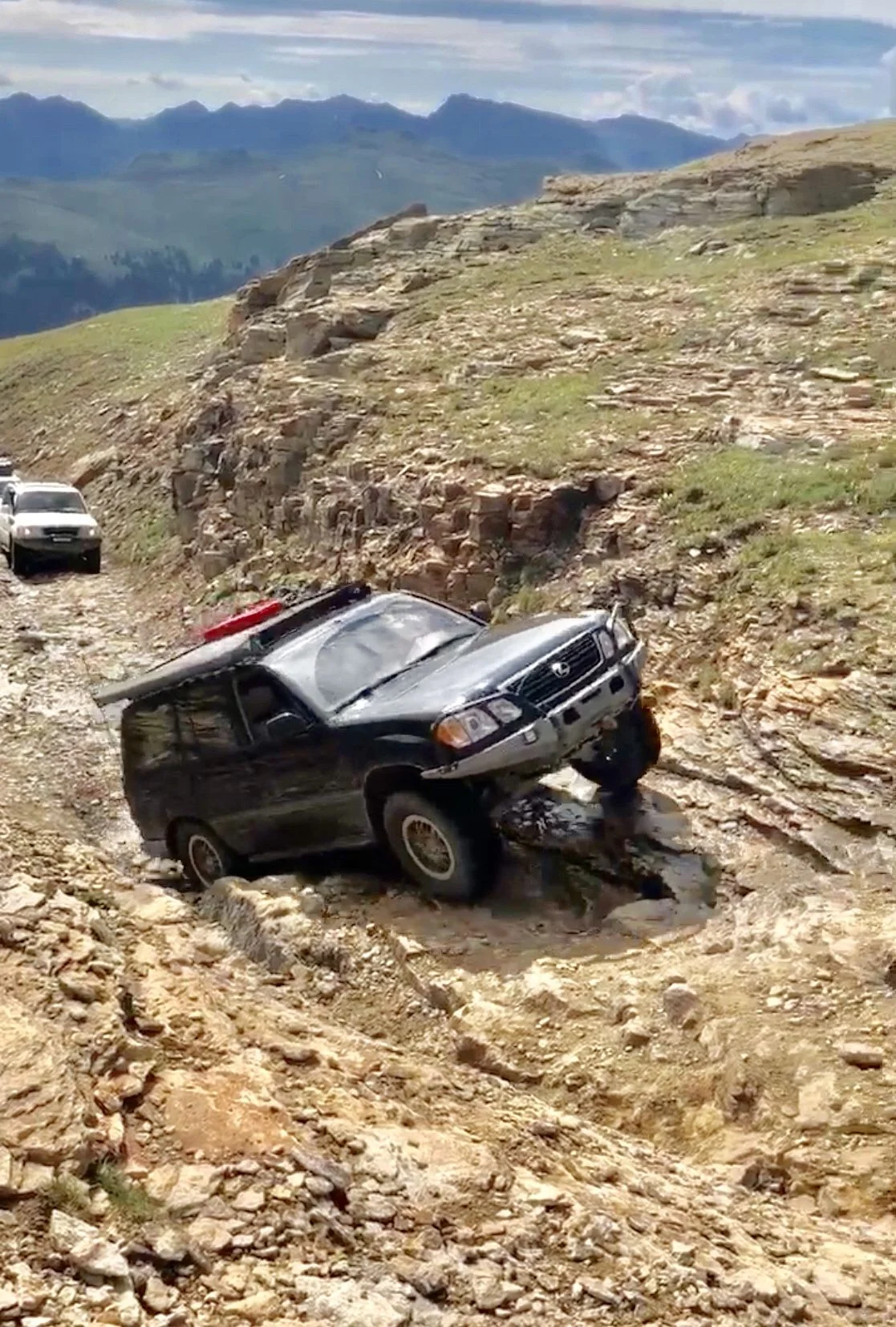

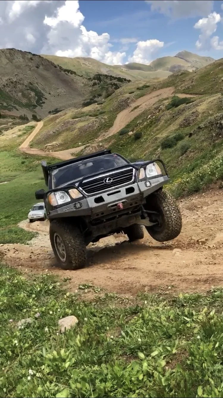

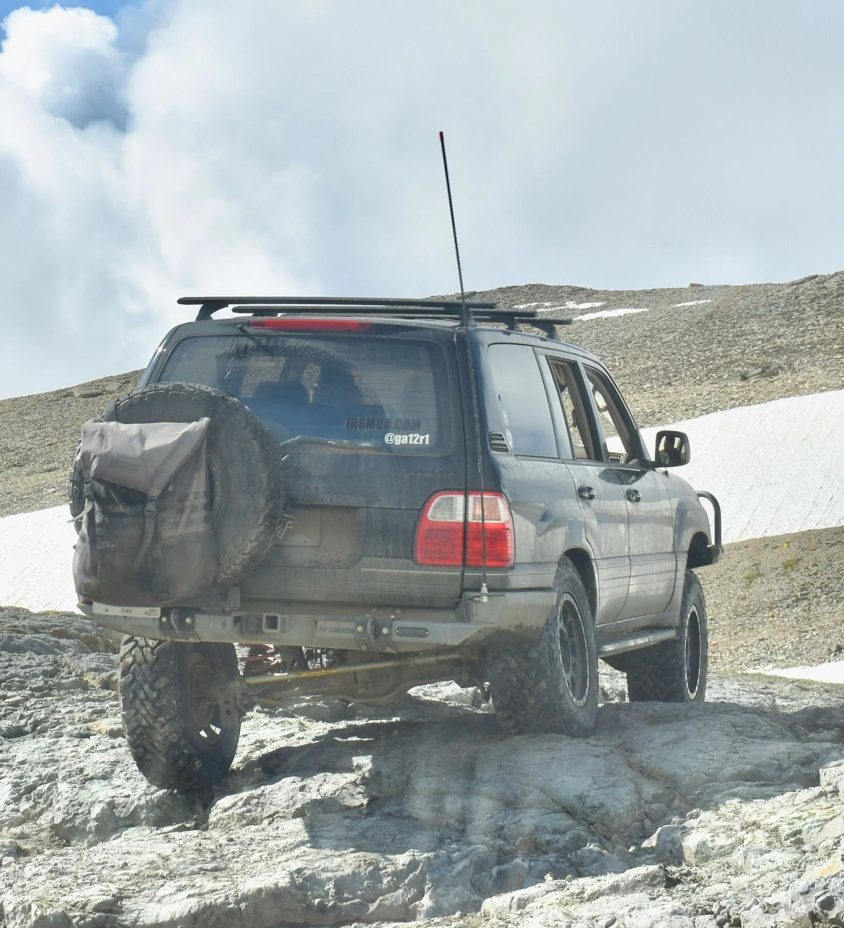

Great uses:

Let the terrain guide you basically. I use rear uphill as most of the weight bias is there anyway. I add front on ledges where there is double climbing or the rear is on loose stuff or muddy. This is my go to on climbing outta of a mud hole. The wash out or gully may need one or both depending on the slopes and if it’s also up hill. All out mud is usually fully locked since there’s no traction and locker chatter from steering input is a non issue. If I’m repositioning with traction I would usually unlock the front even if I’ll need it to progress (air locker up front = easy fast engagement) The rear take a bit of cycles to engage and disengage.
I avoid bouncing and spinning tires as the loads increase and can break stuff, lock up and save time and breakage.
