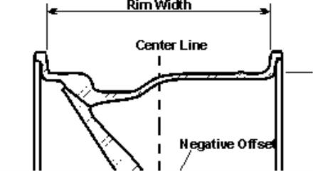

Sorry, for this post, I gave you the factory backspacing, which is 4.5. The wheel is 8" so the offset would be .5" from center, to the negative side or a -.5".

See explanation of how to calculate:
Wheel Backspace & Offset - Truck Wheel Sizes - Truckin' Magazine
The factory 80 alloy wheel does have a zero offset. The wheel's width is measured from the inside of the flange. The total width measurement will be from 8.5-9" depending on the flange material width.
Take an 8" width wheel. Divide by 1/2 (zero offset) to get 4". Add in the flange width of approximately 1/2" and you'll have roughly 4.5" of backspacing.
