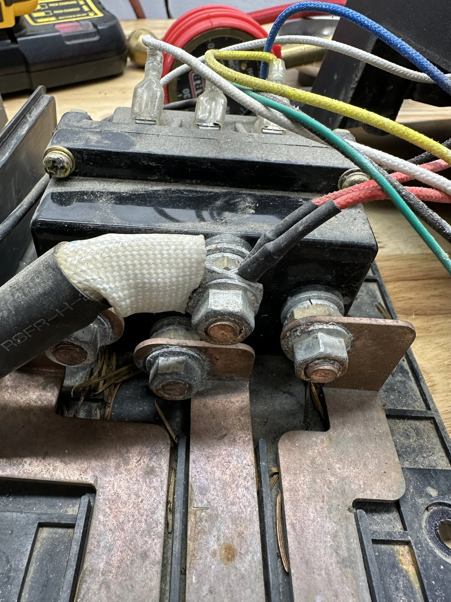

I clearly exceeded the duty cycle on my APEX and it’s now dead. I started by trying to replace the solenoid as all of the cheap Chinese winches share the same one.
However the issue is the drive motor itself. I knew this was the case as I tested it first by bypassing the solenoid. But it was worth $35 to try it.
I am going to try to fish out the drive motor from the under side of my bullbar.

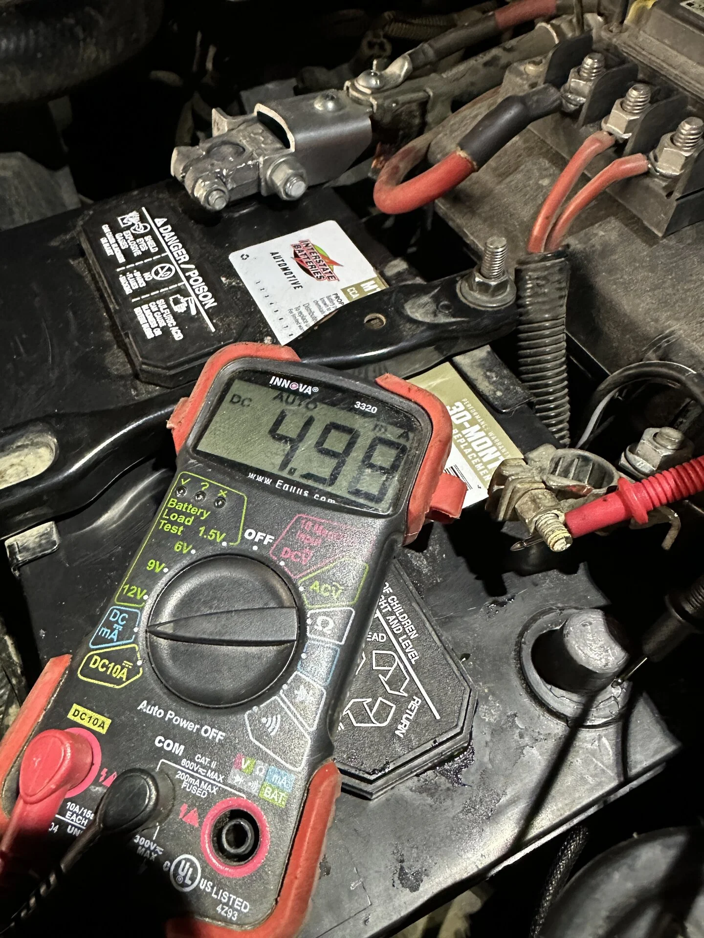

I have also checked for parastic draw with a multi-meter, that seems fine (this is milli-amps). I can certainly dig deeper but 5 mA doesnt seem like a problem:
I've also verified that I'm seeing charge from the alternate with a multi-meter, and my Victron DC charger has no issues waking up when it see > 13.5v at the starter battery.
