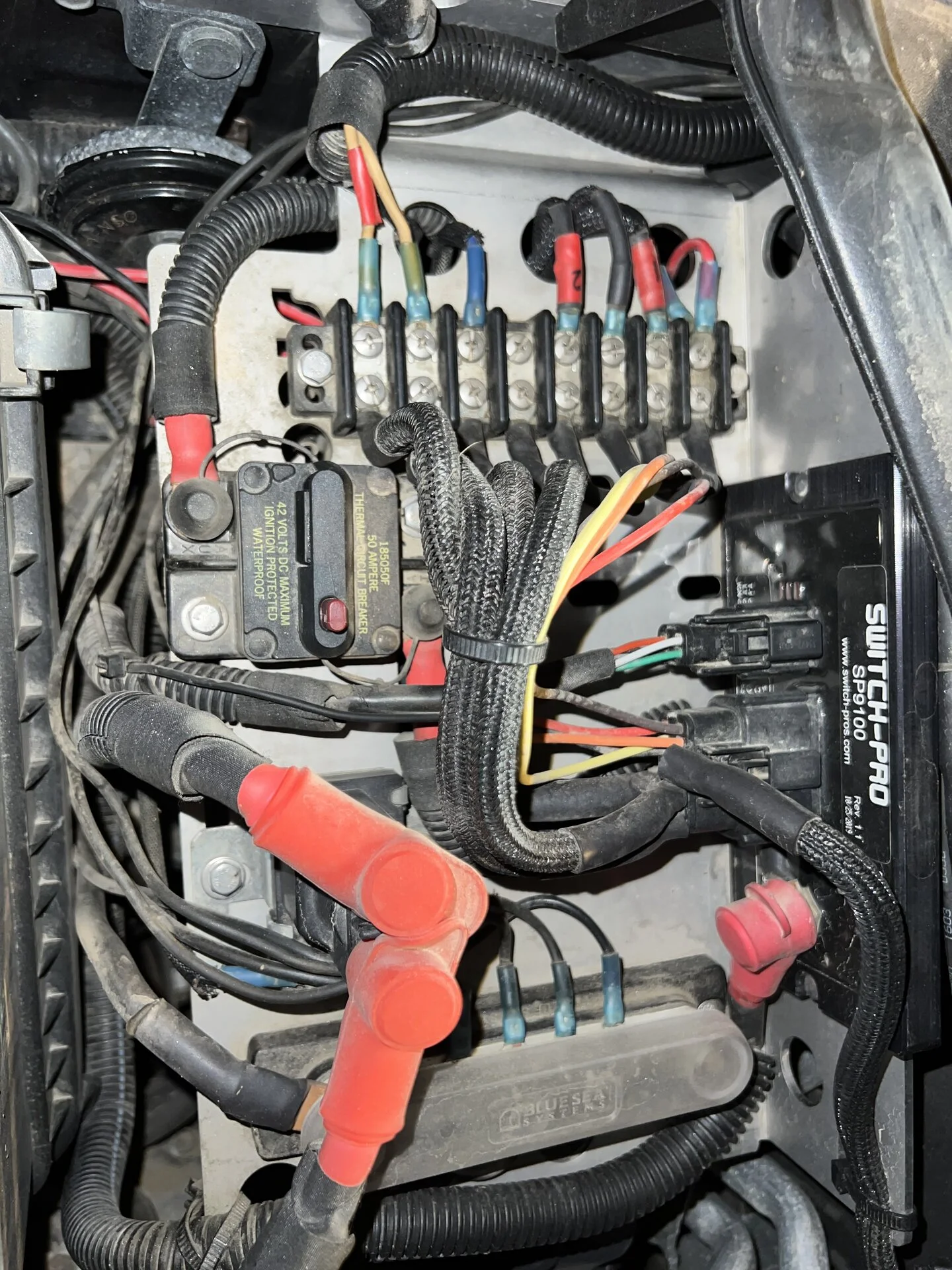

I got a screw terminal battery. Then some copper strap from the metal supply. Probably not the best solution. But it was certainly inexpensive $20?
I’’m using a generic negative disconnect and also a cheap high amp shunt in the negative side too.

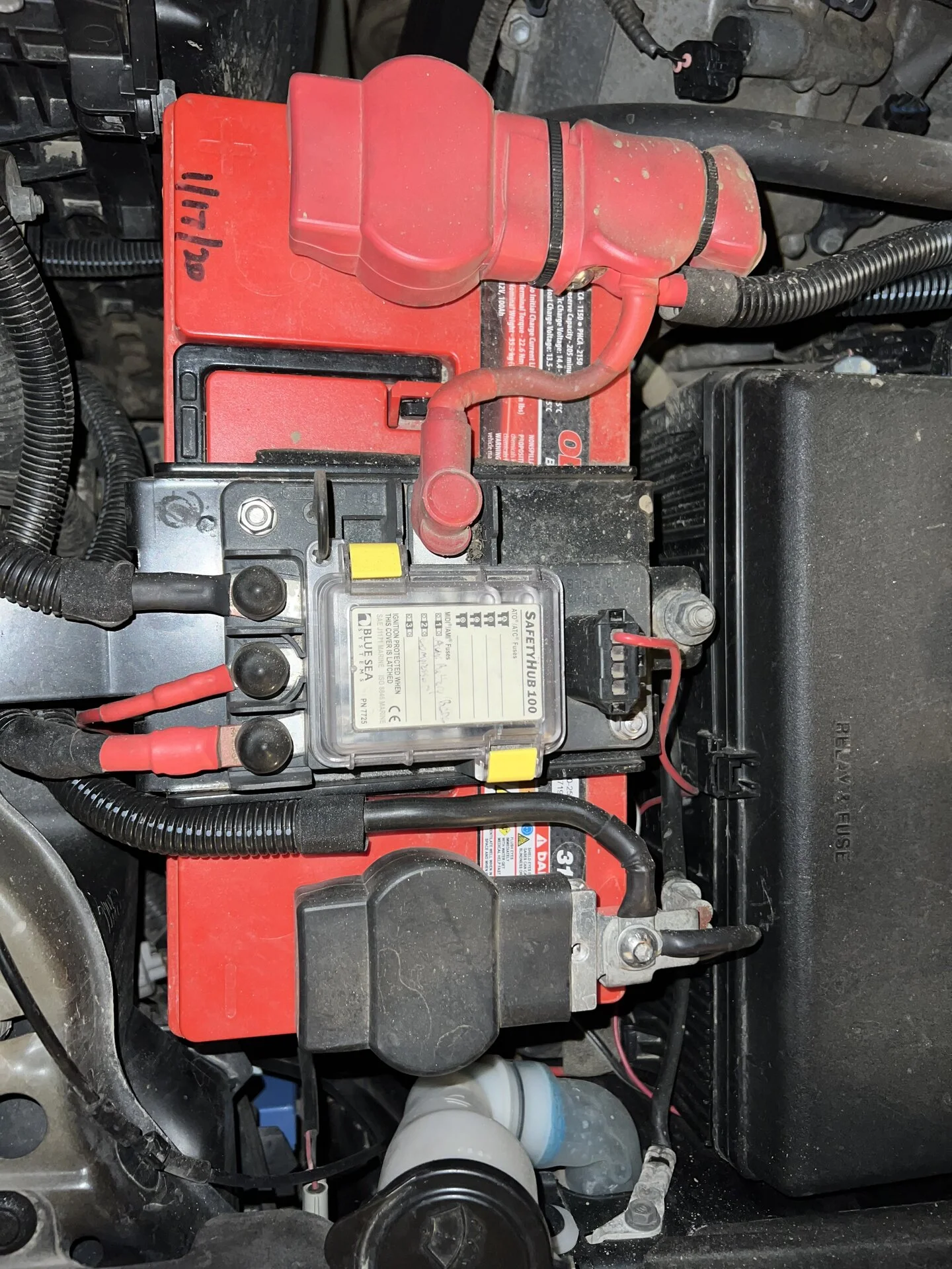

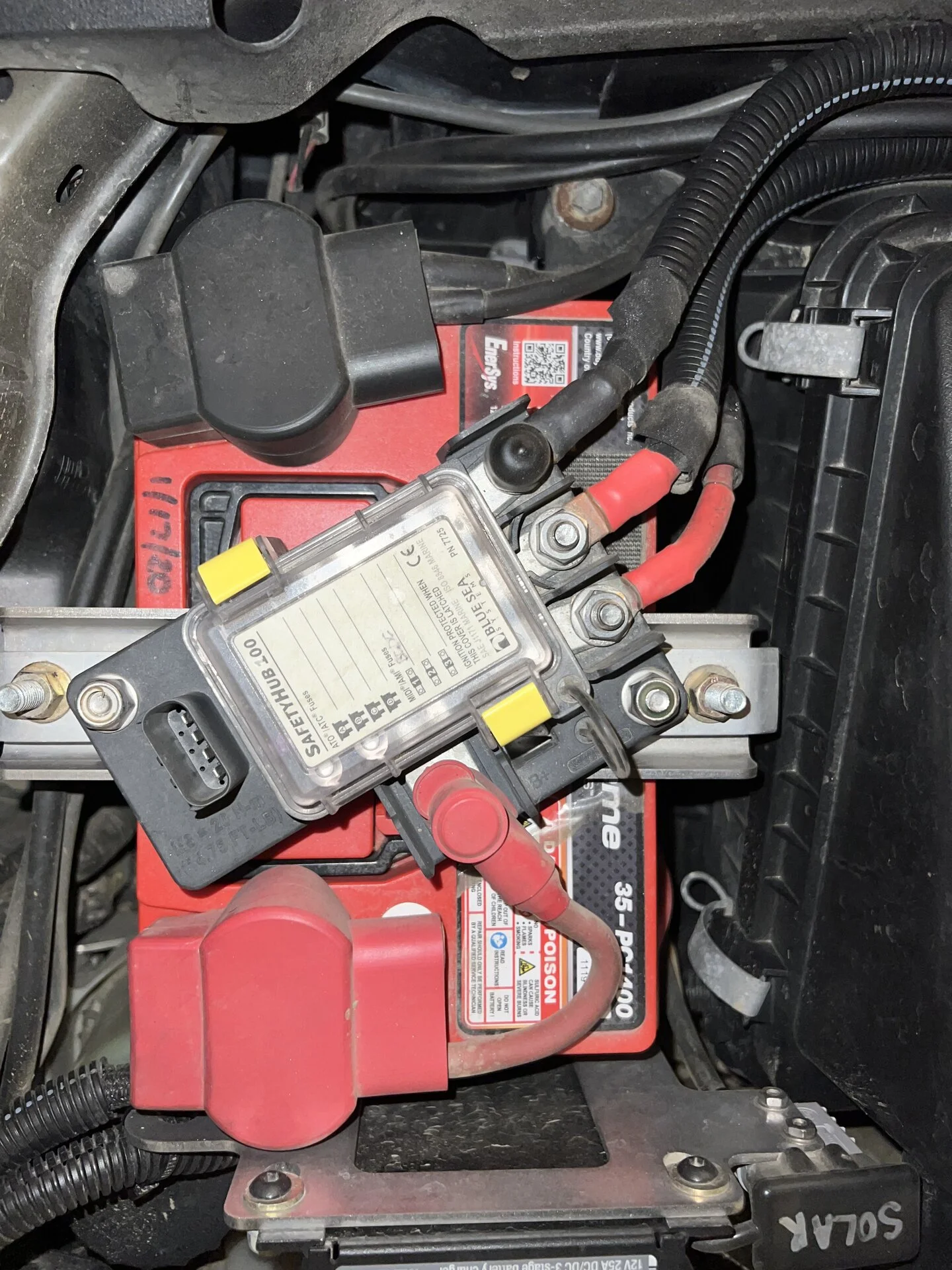

Here is what I did. Not saying it is good, but it is one approach. And looking at it just now made me realize that I've lost some of the caps I put on some of my terminals, so I need to go get some replacements. Under the coverings are Slee billet terminals on the starting battery and milspec terminals on the auxiliary.

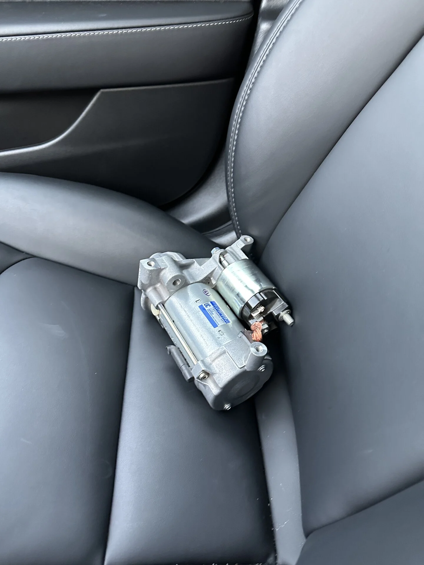

Starter procured. Thanks @grinchy
