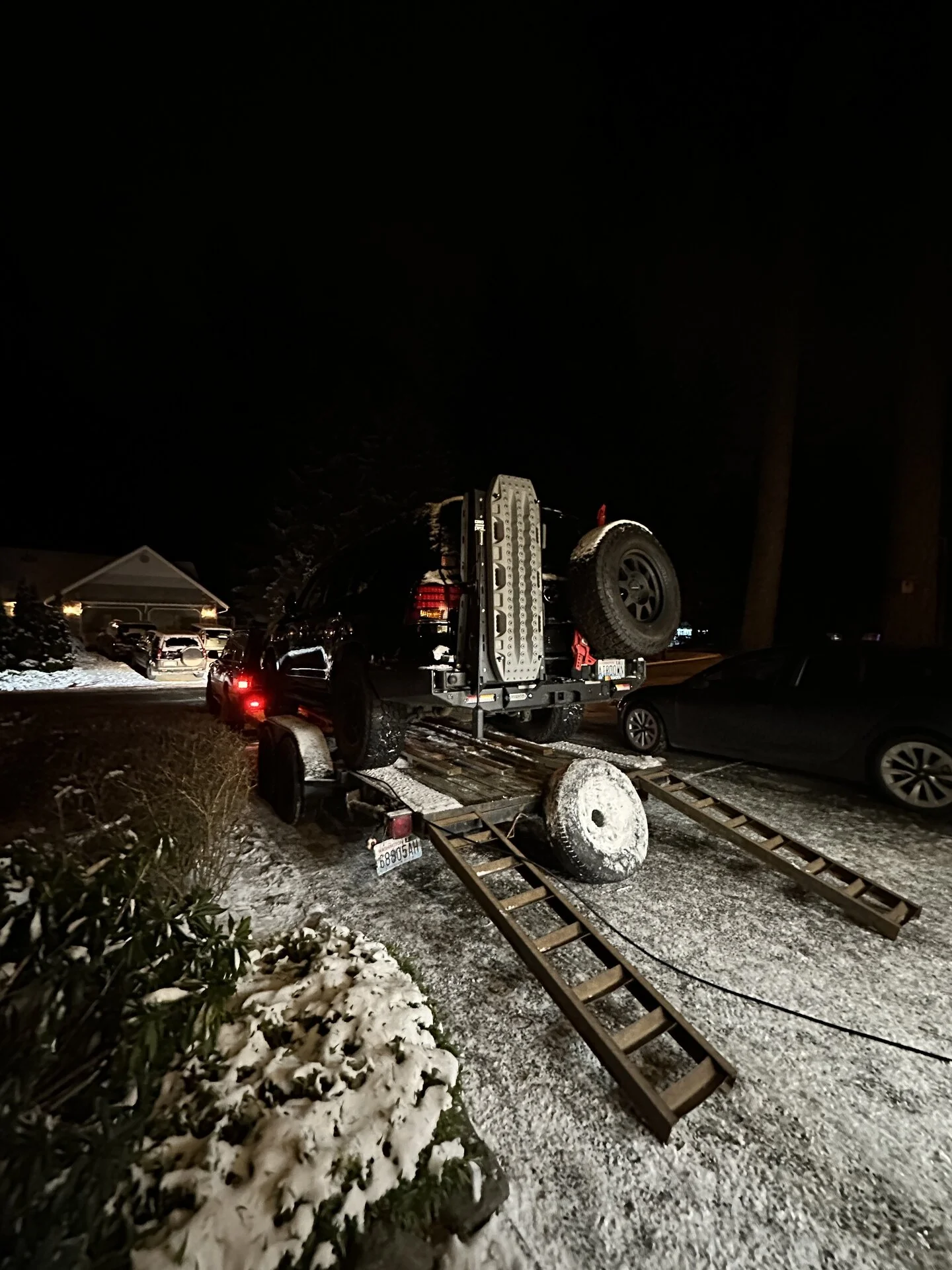

made some progress tonight with @LCMoneyPit — it’s on a trailer in my driveway at least.
Originally was going to use winch on the trailer to reverse up but we can’t find the controller so I winched on which worked great but totally flattened the battery.
I’m still on quite the slope so I need to reverse winch myself off with a snatch block so the truck is out on a charger for the night.
Trying to laugh, it could be worse 💁🏻‍♂️

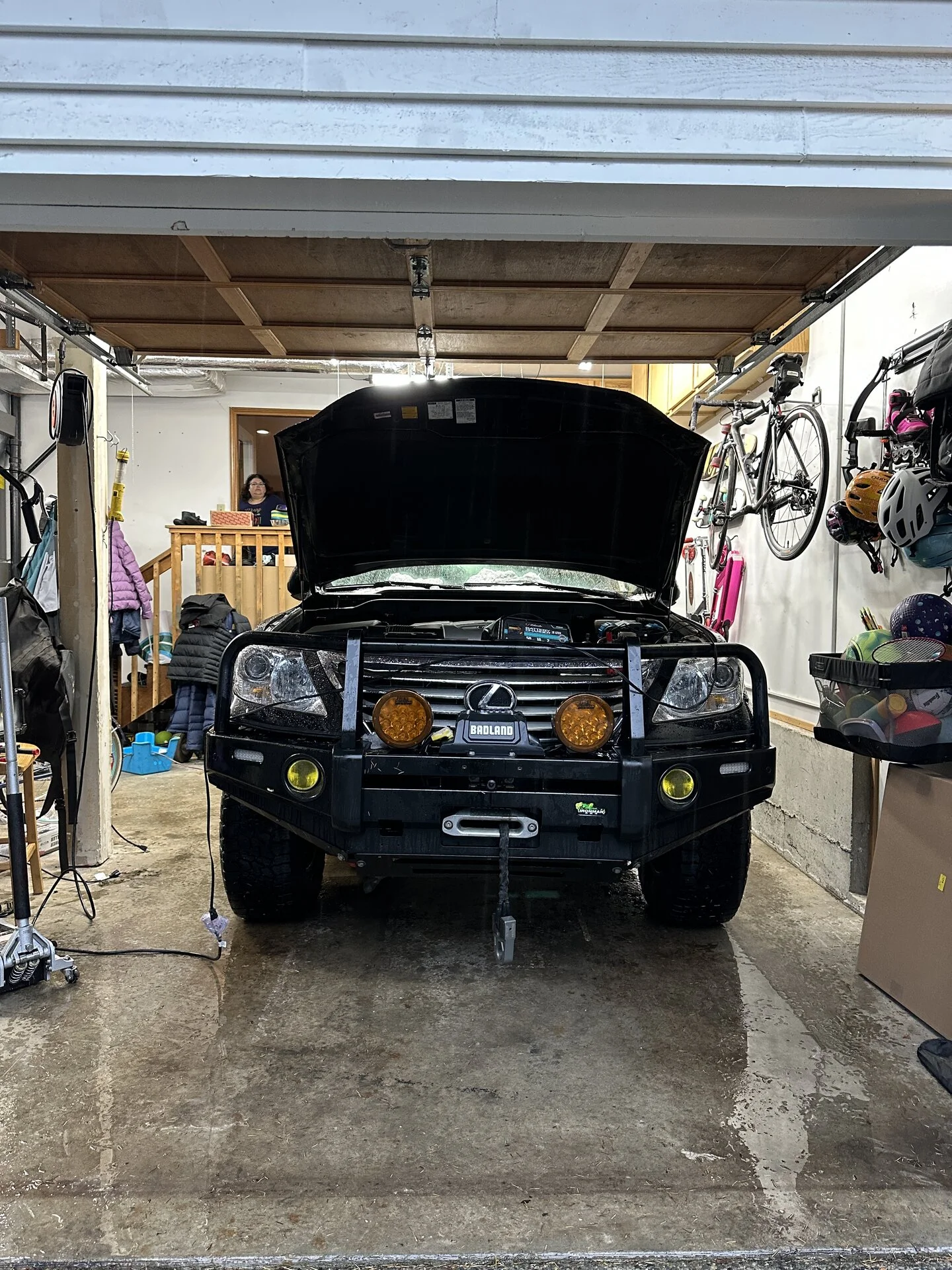

I had the truck backed in the garage to finish up swapping out the rear differential fluid. When I finished I pressed the start button and nothing.
After what was possibly a panic attack I popped the hood and checked the battery - 12.2v. I put the NOCO on it and after a very long crank it started.
I got the truck situated in the garage just in case and swapped in my old X2 power back in. Thankfully the truck started again.
Dudes omg 🫠🫠🫠
I’m going to be careful next couple of days just in case but hope it’s the end of the drama. I’m going to warranty out this new interstate battery next week. My theory is that maybe I killed a cell winching it in the trailer.

Yes, this theory is likely. I've now very cautious when using electric motor draws with batteries in low states of charge. Things like starters, compressors, and definitely a winch. These inductive loads will find power however they can get it. Power is volts x amps. With a battery in a weak or low state of charge, will pull serious amps to replace volts. It's the amps that will kill electric circuits and contacts - and possibly battery cells in your case.
I know it wasn't possibly in your case, but I only run heavy draw devices like compressors, with the engine on.
Same here, everything but my winch is on switched power for that reason.
