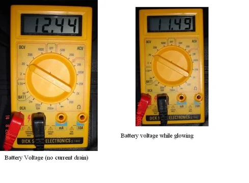

    A cheap multimeter like this would do the trick and then just place it across your battery terminals (on the correct DC voltage setting and with the probes on the appropriate terminals of course):
    A good battery should read about 12.6V after a "settling period" (mine reads 12.44V here but I'd already been draining it by doing a few "glows" - and glowplugs do draw a lot of current!) and around 13.6V if you were to check it again after "going for a reasonable drive" or "after charging via a plug-in mains-powered charger". (In case this isn't clear, - both these figures are for "Engine/charging OFF".)
    So when your engine is on (and running) you should be able to measure a higher voltage than either of these values (more than 13.6V) if your battery is going to be getting charged by your alternator.
    Measuring 14.4V while your engine is running would be "about normal" but it should NOT rise beyond 14.7V. (If it does, then your new chinese regulator is probably unsatisfactory.)
