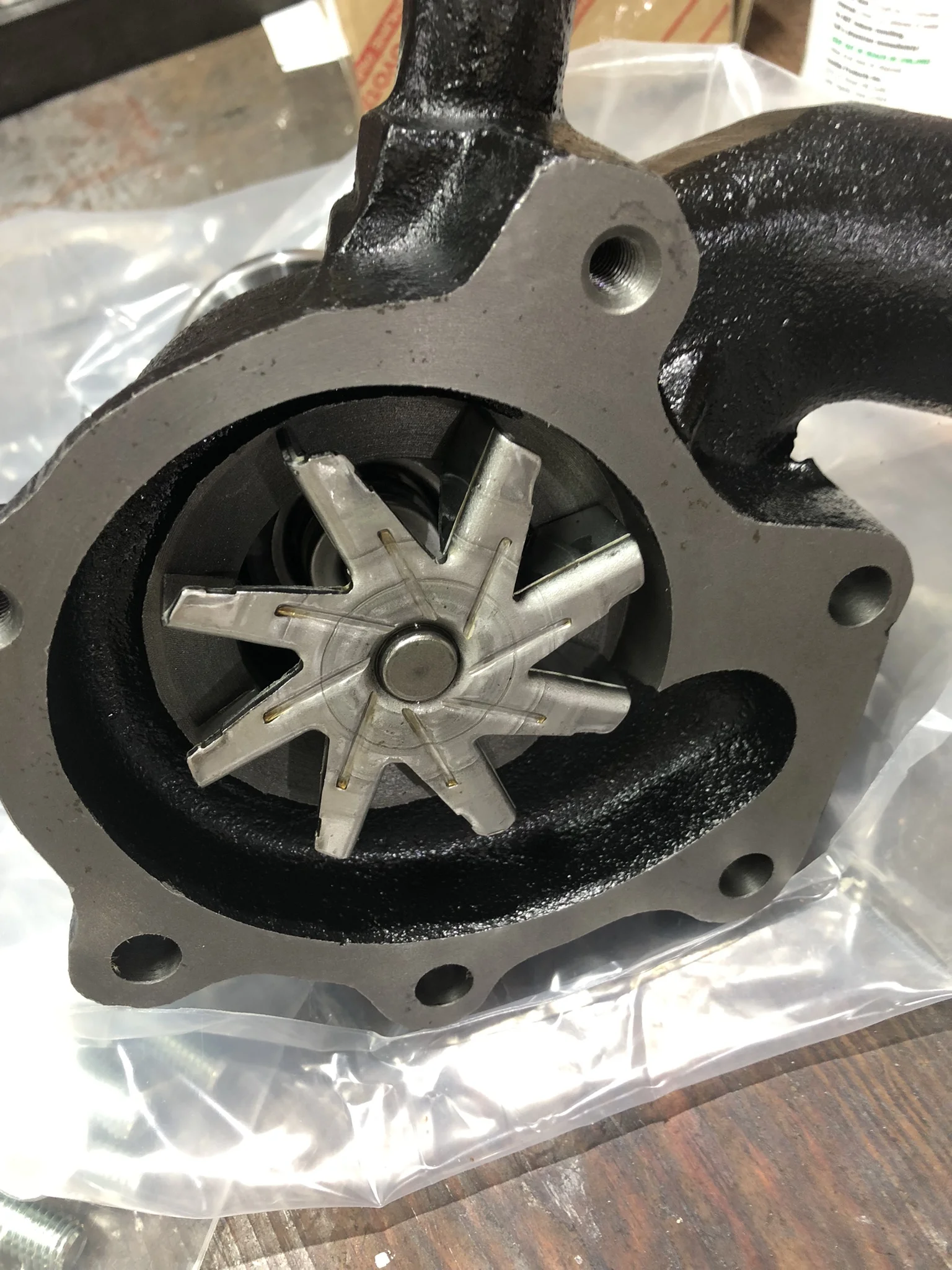

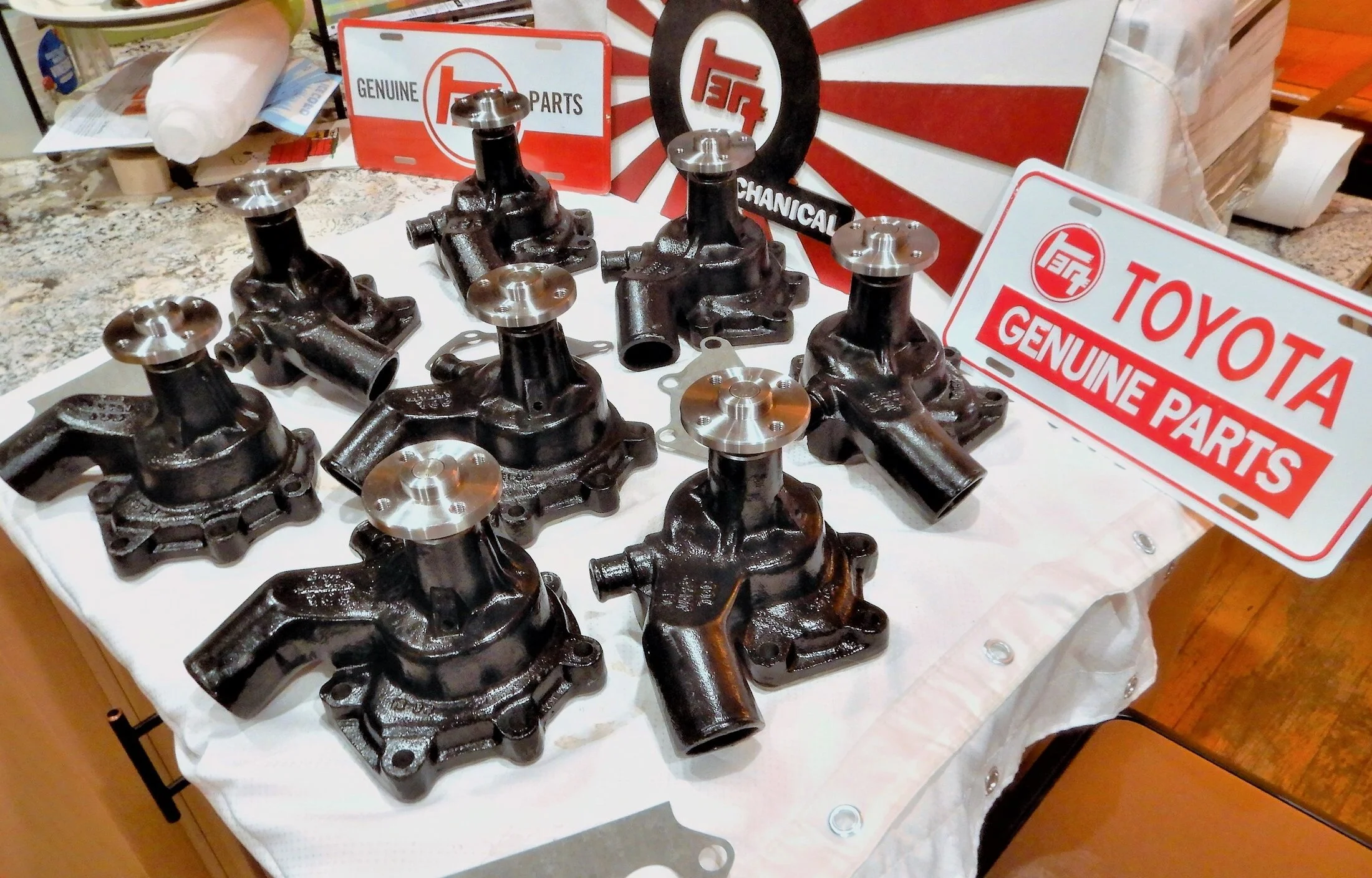

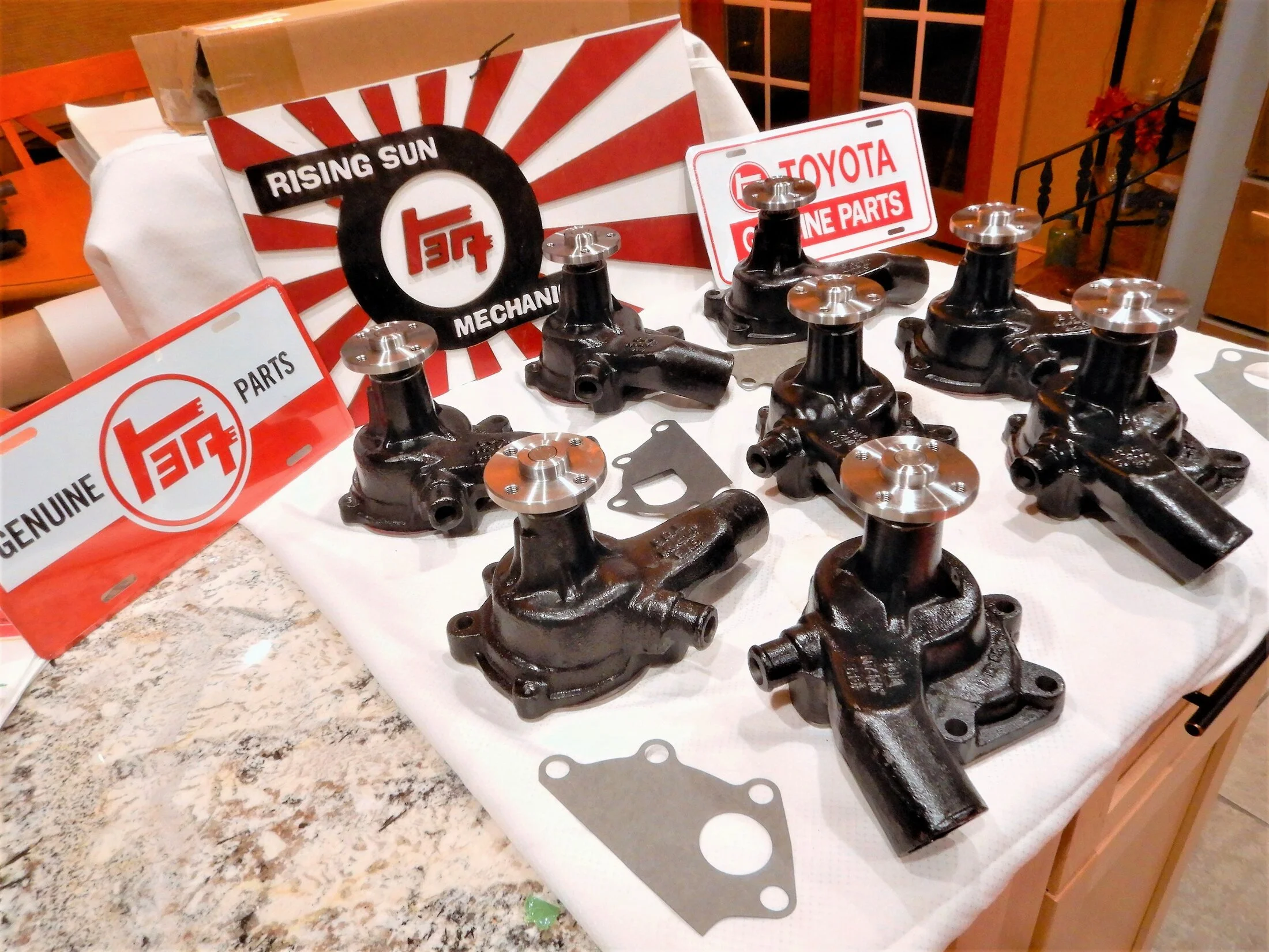

Fwiw, we used to stock the OEM Toyota boxed 16100-60080, we stock our last one in 2013. I *think* I have a new OEM boxed pump in my hoard pile. Photo from our old site. Slight differences from the GMB aftermarket offering.

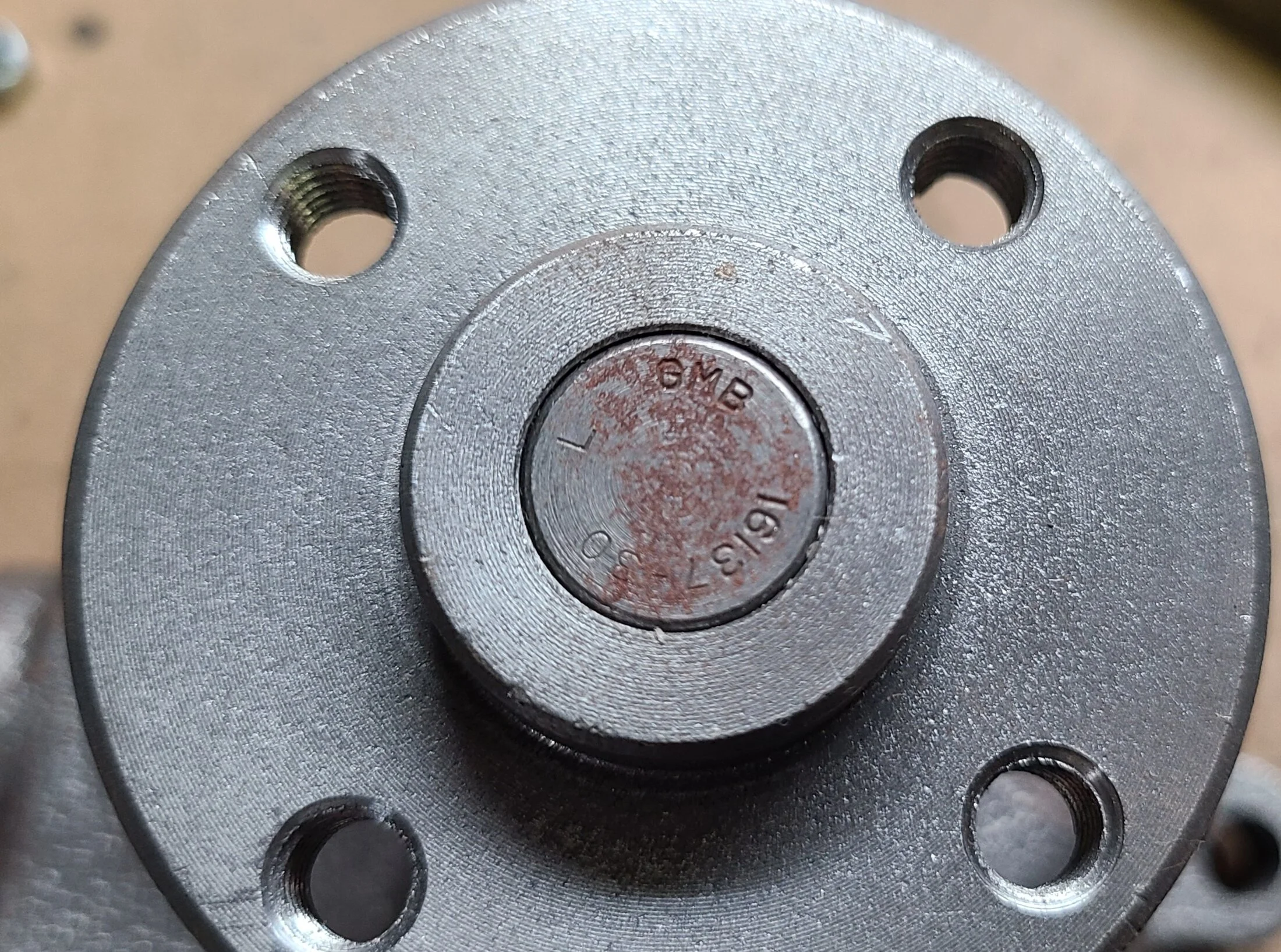

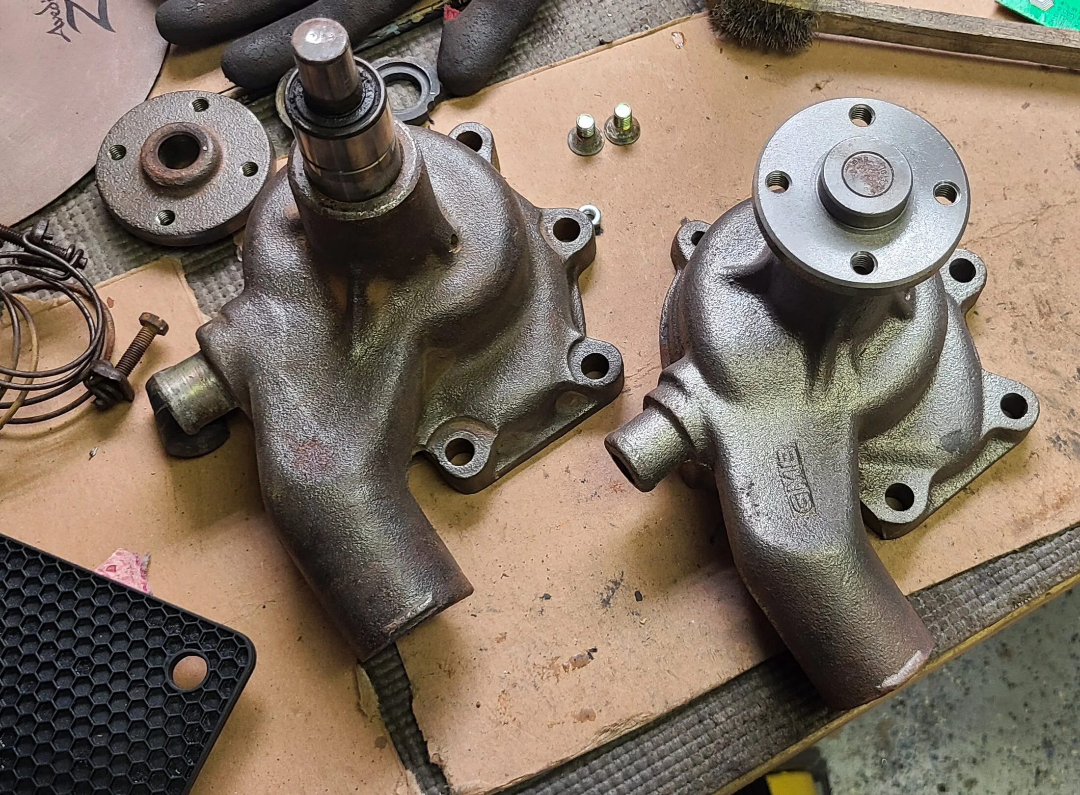

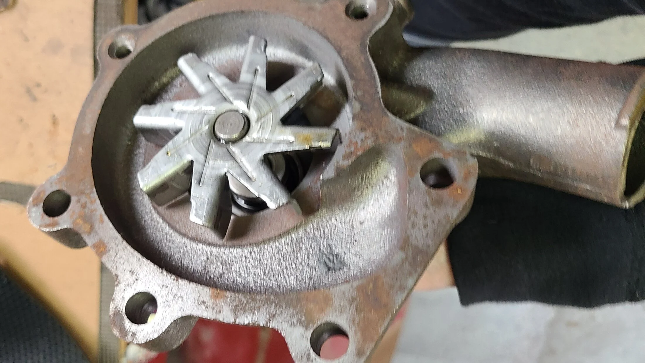

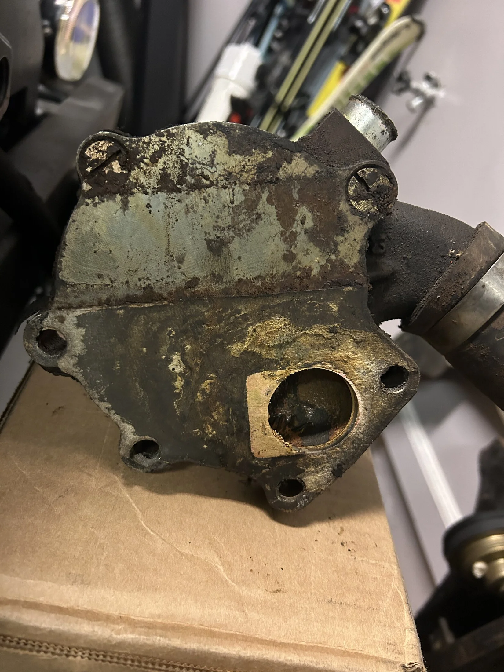

Are they the same height? 5-5/16" / 135mmLots of knowledge of GMB water pumps here. I scooped up this water pump that has a different stamp in the housing from all the ones posted in the pictures above. It clearly sat in storage awhile judging by the oxidation on the surface flange. Is this just an older logo? No stamps indicating country of origin. Just curious what I actually have. For reference, unknown manufacturer water pump I took off my truck.
Same height. Same bolt pattern. Same hub.Are they the same height? 5-5/16" / 135mm

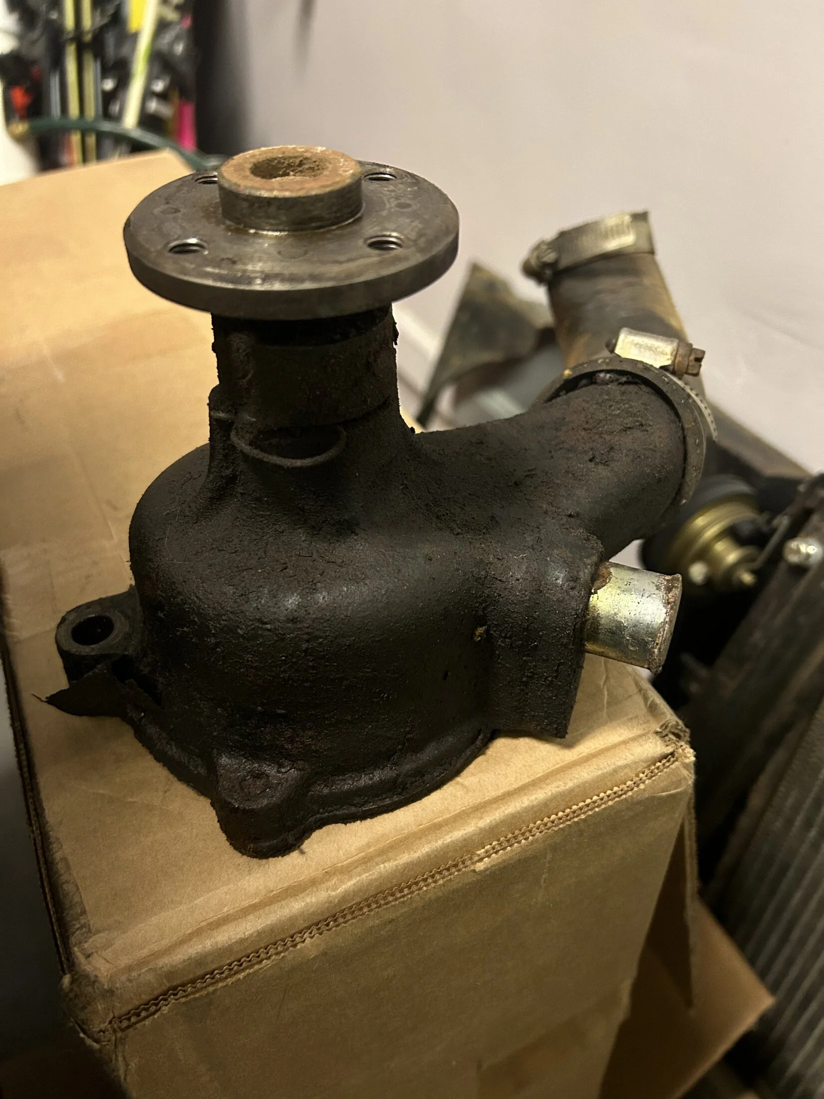

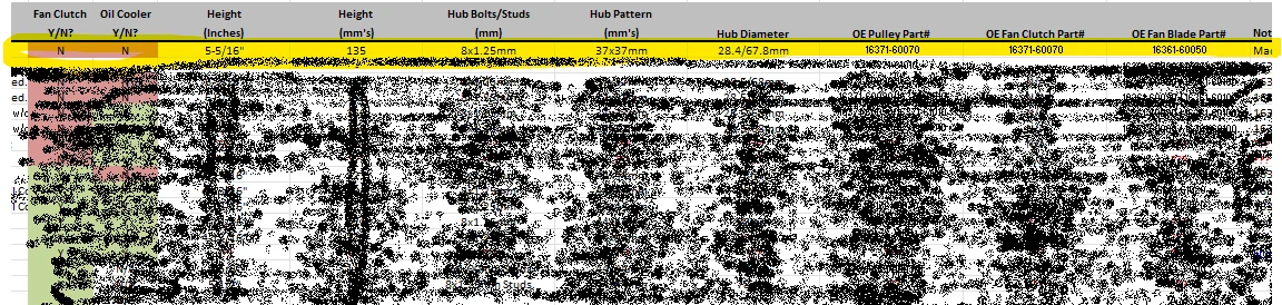

The 16100-60080 is not the only cast pump offering from Toyota/aftermarkets. Do they measure the same as this:

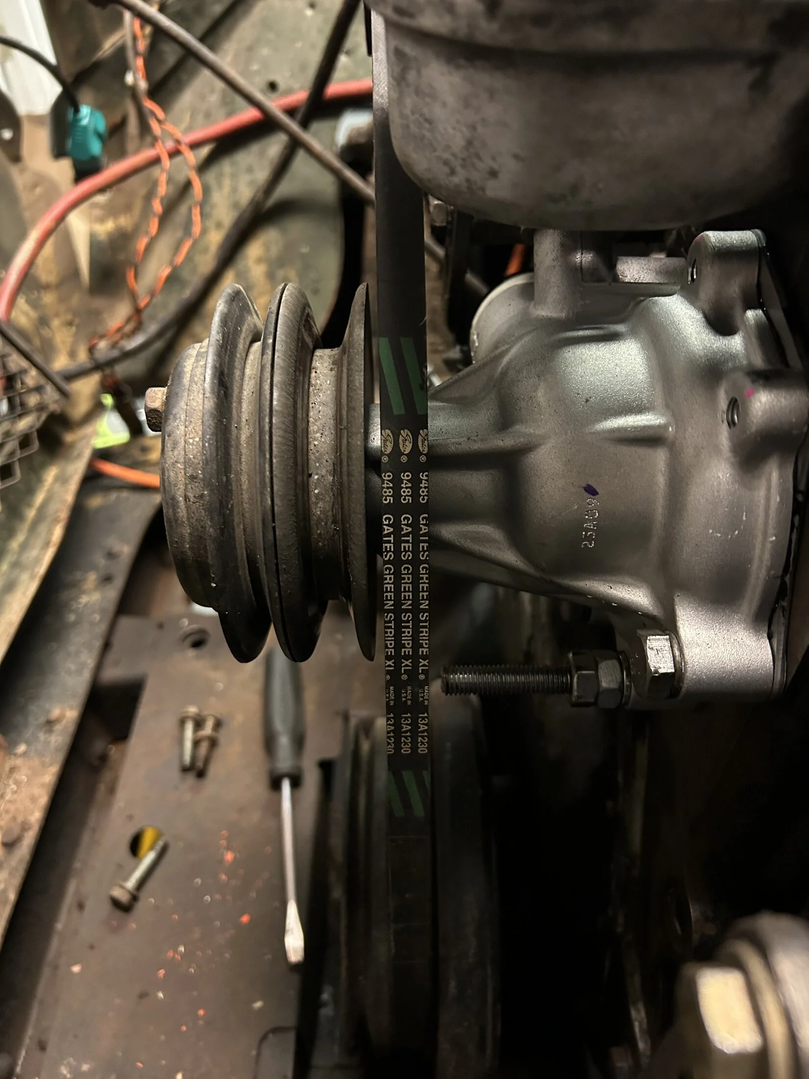

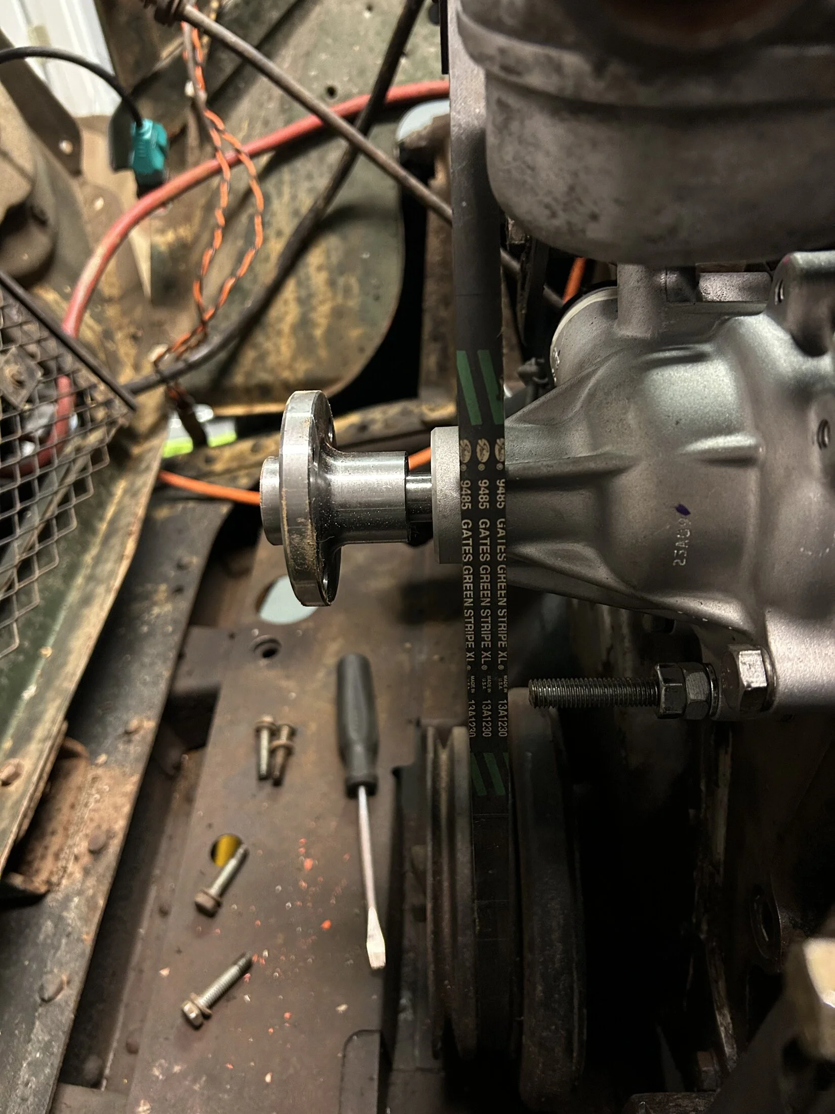

Benefit of getting the pulley though is you gave yourself some breathing room with parts availability! If you can run a newer 2F pump, that is great! Keep the old pump still if you can though. Could be a good rebuild core for you or someone else later.So, I just recently went down this rabbit hole. I was replacing the radiator in my 9/72, that had a ‘75 era 2F transplanted into it sometime before me. As I was replacing the radiator, I thought, I should replace the water pump, thermostat, and associated hoses, since those pieces had been there for at least the 21 years I’ve owned the truck. I ordered a boat load of parts and just thought the wp was the std 2F, no clutch, no oil cooler pump. Then when I bolted it all on, I noticed the pulley was now an 1inch off. Long story, short, I had a the original cast iron wp (probably from the 1.5F that came with the truck.) so, I ordered some fancy, bling pulley to try and get belts back in alignment.
However, after reading all this, should I just have tried to re-build the old wp or just left well enough alone??

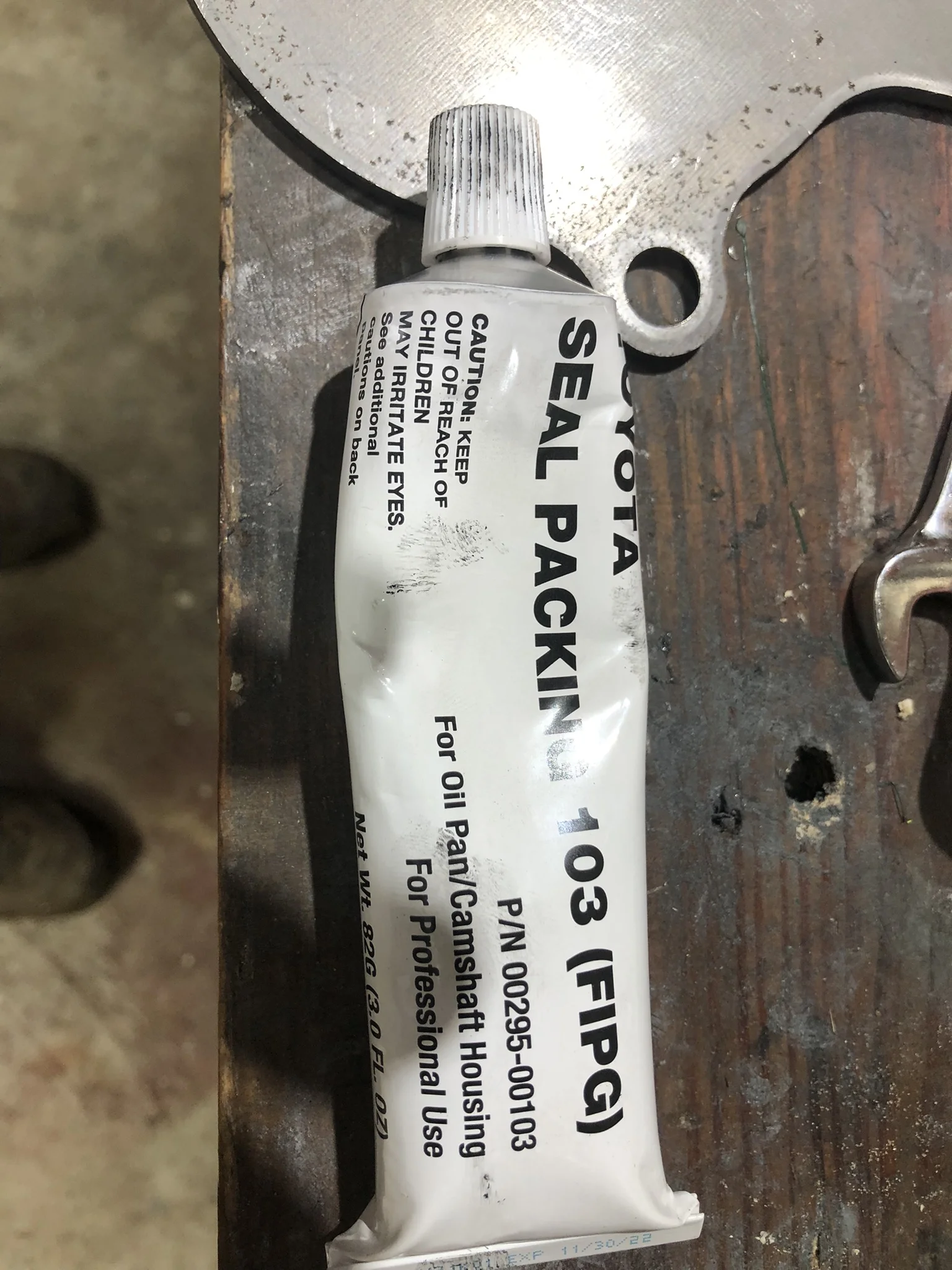

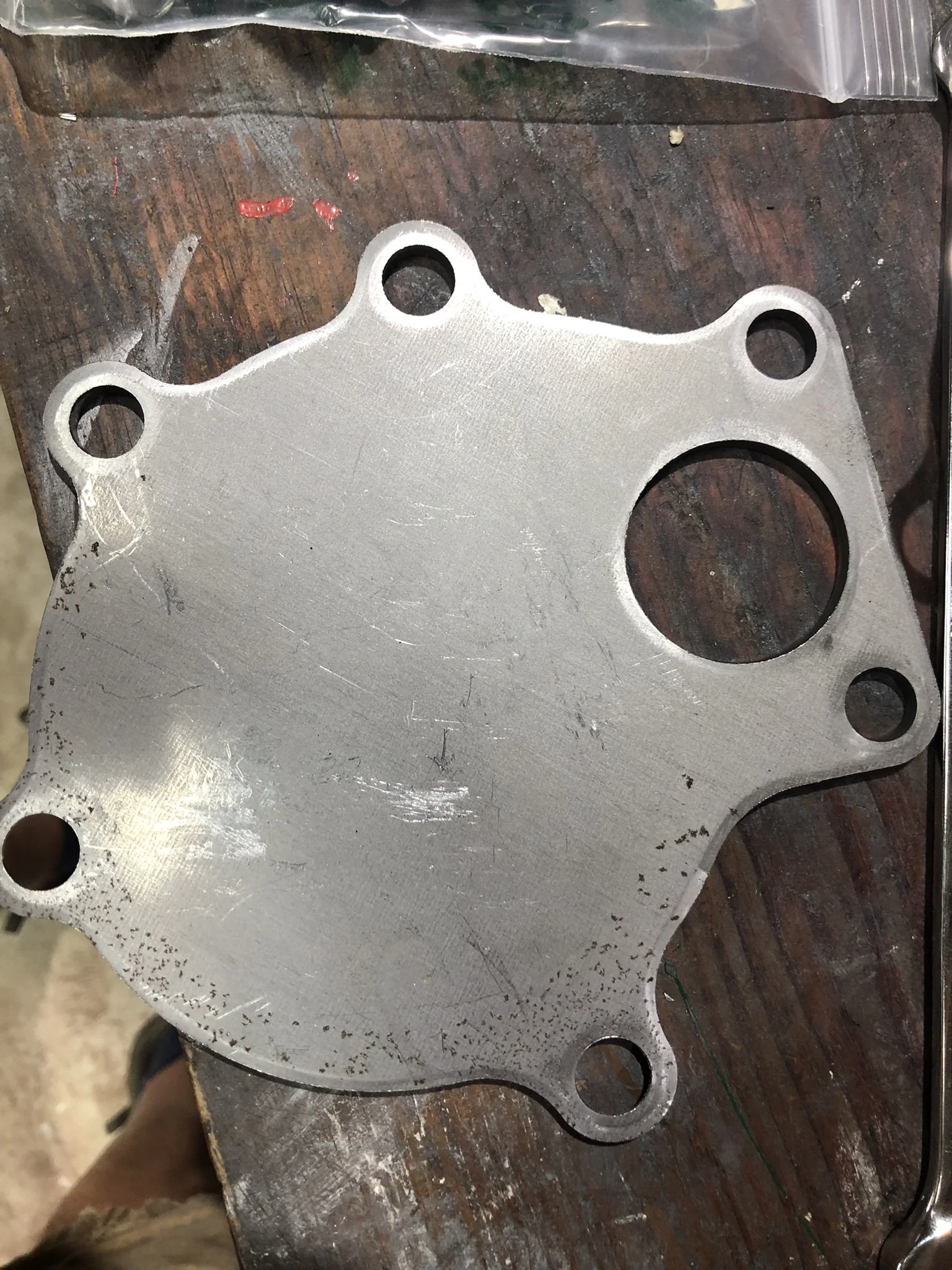

I would. I didn’t and I had a small leak develop. Had to rip the pump back out to fix it.Curious: Even with the great reputation of the GMB pump, was it still necessary for the end-user to pull the backing plate and seal the inner gasket before installing?
If you decide you don't want that old pump, I'd be happy to take it off your hands. I tried to rebuild the pump that came off my truck but it had a weird seal cup inside that wasn't anything like the listed replacement pump seals out there. I found a suitable replacement pump but would love to take apart an original to check it out.So, I just recently went down this rabbit hole. I was replacing the radiator in my 9/72, that had a ‘75 era 2F transplanted into it sometime before me. As I was replacing the radiator, I thought, I should replace the water pump, thermostat, and associated hoses, since those pieces had been there for at least the 21 years I’ve owned the truck. I ordered a boat load of parts and just thought the wp was the std 2F, no clutch, no oil cooler pump. Then when I bolted it all on, I noticed the pulley was now an 1inch off. Long story, short, I had a the original cast iron wp (probably from the 1.5F that came with the truck.) so, I ordered some fancy, bling pulley to try and get belts back in alignment.
Sure. If all works out, then let’s do that. While I love hoarding my fair share of cruiser parts, it would be great if it can go to immediate use or provide some benefit.If you decide you don't want that old pump, I'd be happy to take it off your hands. I tried to rebuild the pump that came off my truck but it had a weird seal cup inside that wasn't anything like the listed replacement pump seals out there. I found a suitable replacement pump but would love to take apart an original to check it out.![]()
