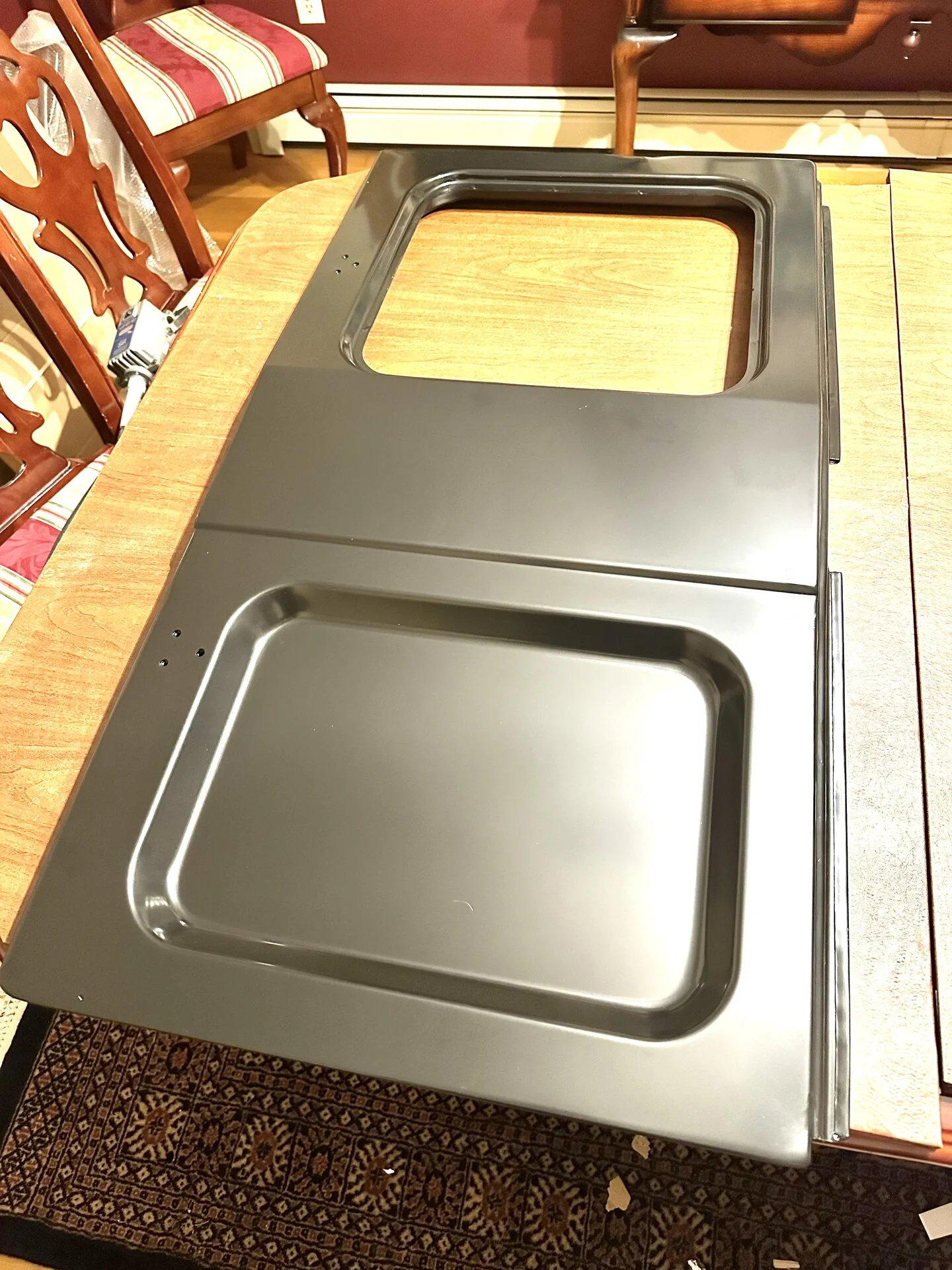

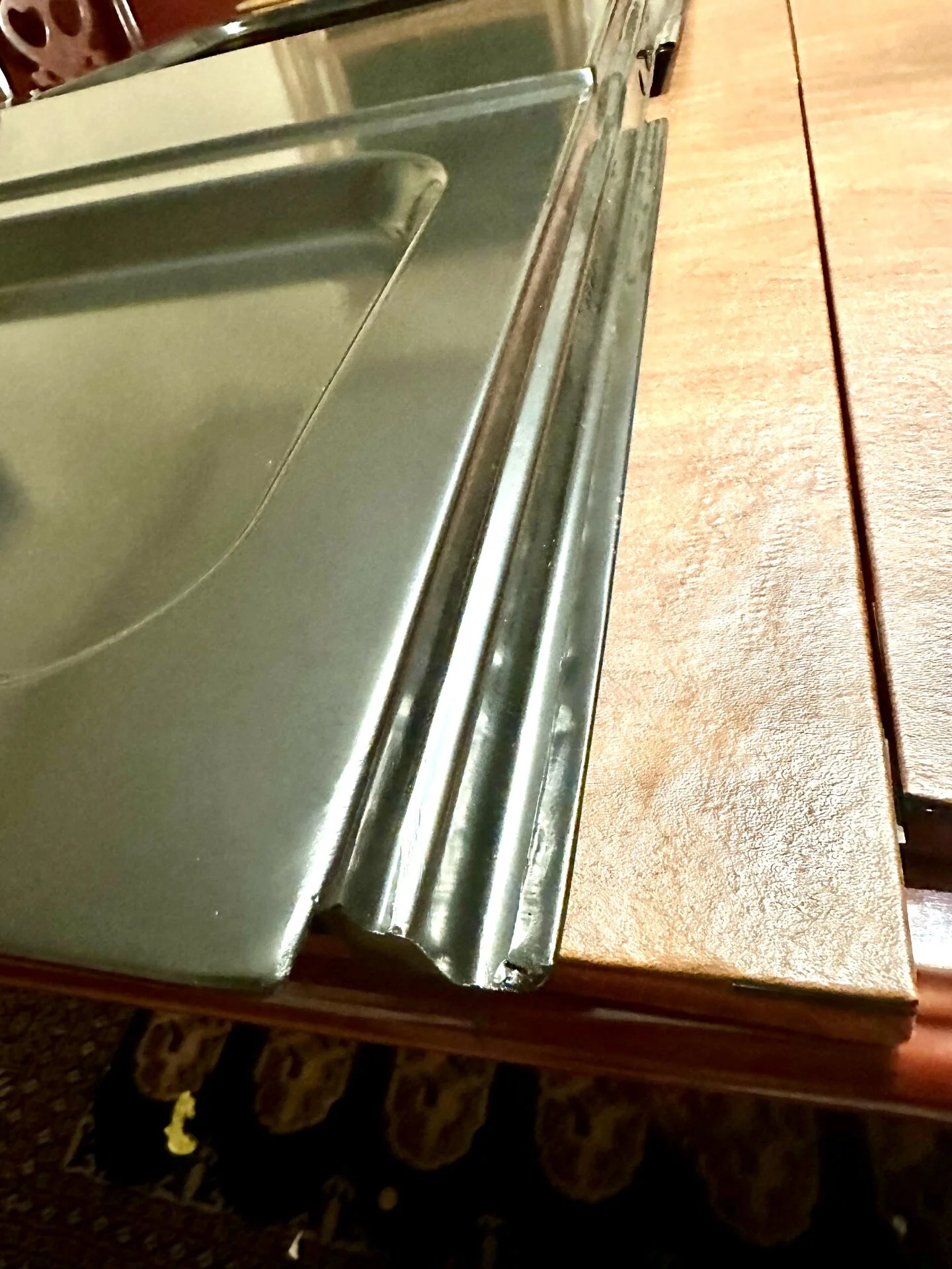

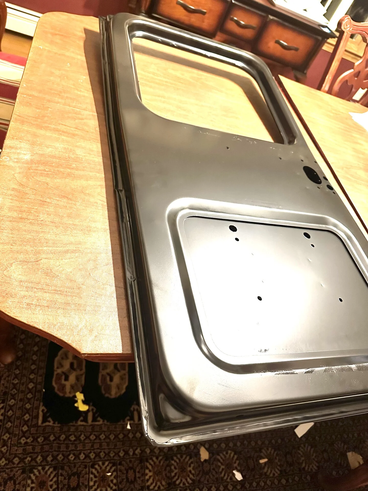

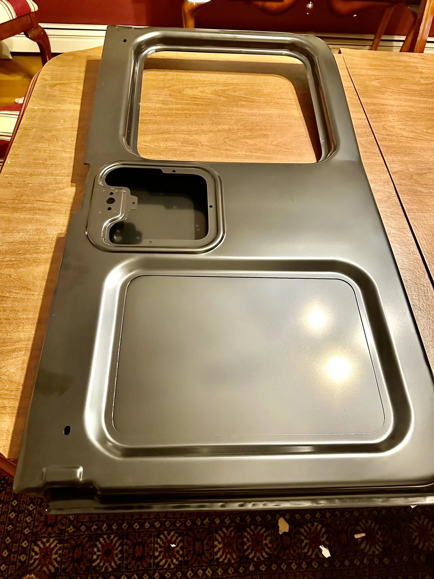

Hi all,
I’m in the process of adding a hard top for a 76 FJ40. Everything I’m finding locally is too far gone for the level of repair I’m willing to put in so I’ve decided to try out a hard top build using parts manufactured in China from Jiangsu Juncheng (I’ve read some positive reports about their front doors). My plan is to try their side panels and ambulance doors and weld an aftermarket rain gutter kit to a fiberglass top sourced locally. The ambulance doors came in today. They were ordered direct from the manufacturer through Alibaba. The price was 900 for the two doors plus 200 shipping. My only hesitation was them getting banged up during shipping. When they arrived the packaging job was terrible. They were essentially put in a box with zero padding. By some miracle I dodged a bullet and the doors were essentially unscathed except for one small ding that can easily be repaired. My first impression is that the build quality is excellent and appears to be the same gauge steel as front doors. I believe these are the same manufacturer as sold by Topnault. I have Topnault panels on order now and will post more on fit later.

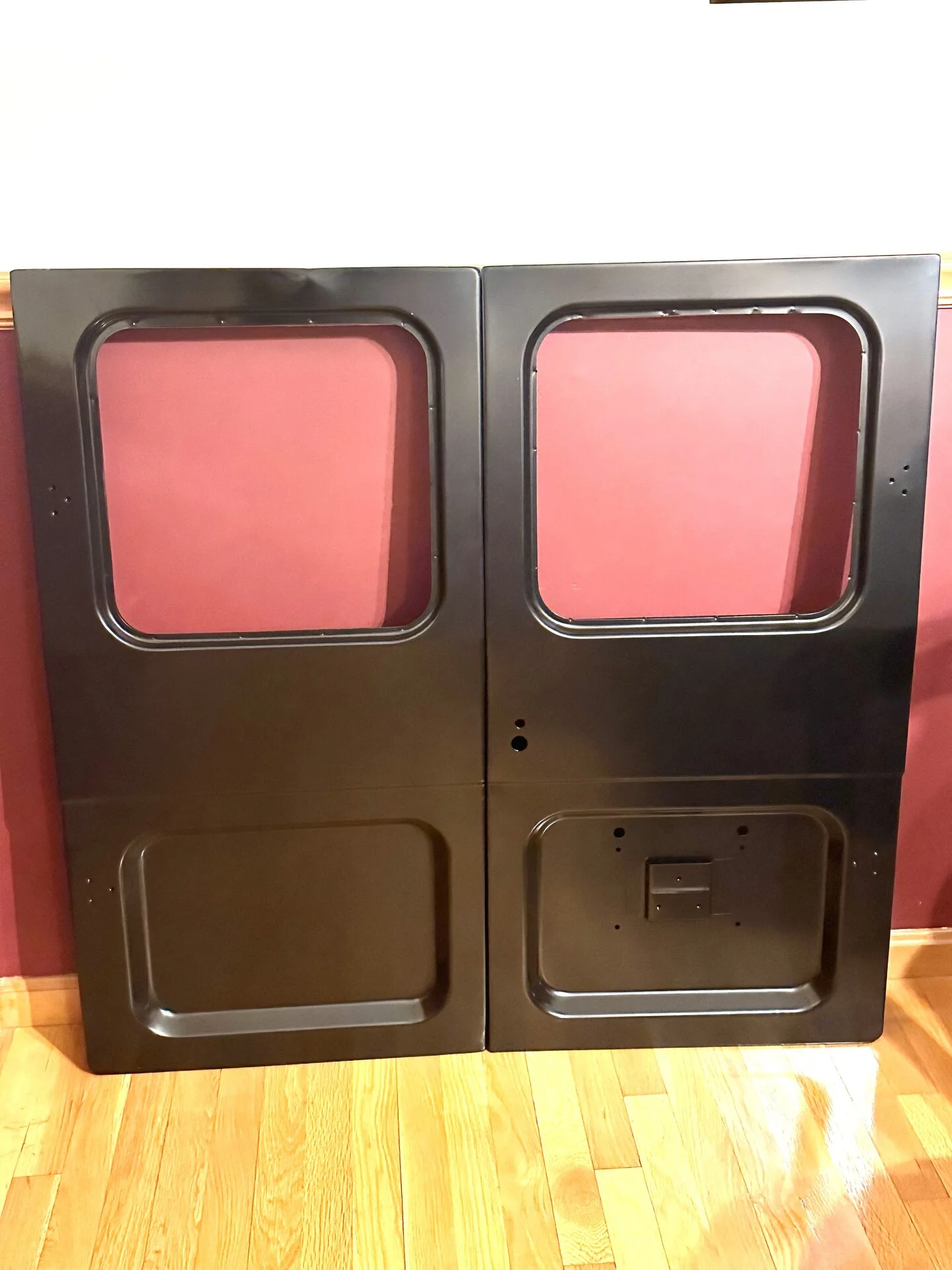

They look really nice, i'm in a similar process.. i would like to turn my FJ40 1972 Softtop into a HardTop, i have a few parts, but the main parts i need are the ambulance doors and the upper side panels ( Both sides)...i'm really thinking ordering from china as well, thanks for the pictures of the doors.

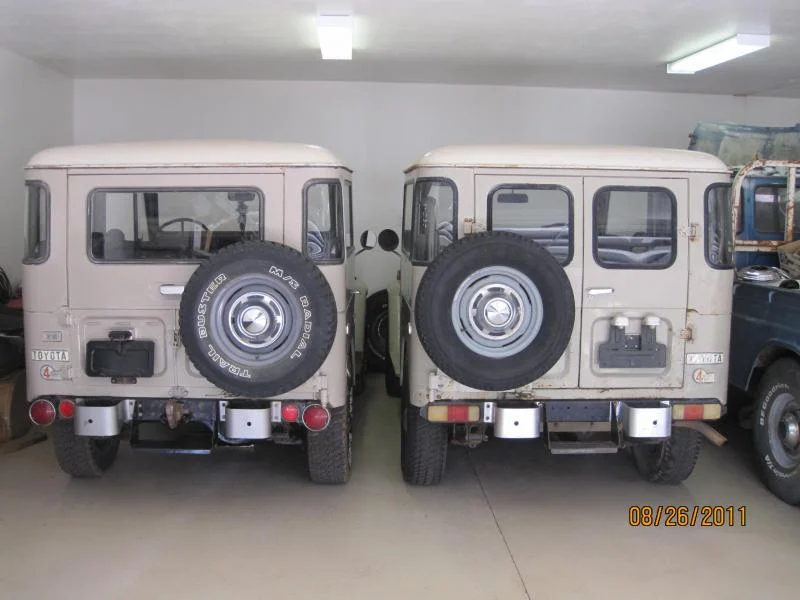

Would be easier to add a hard top if you used a hard top with a hatch. Here is 10/75 with ambulance doorso

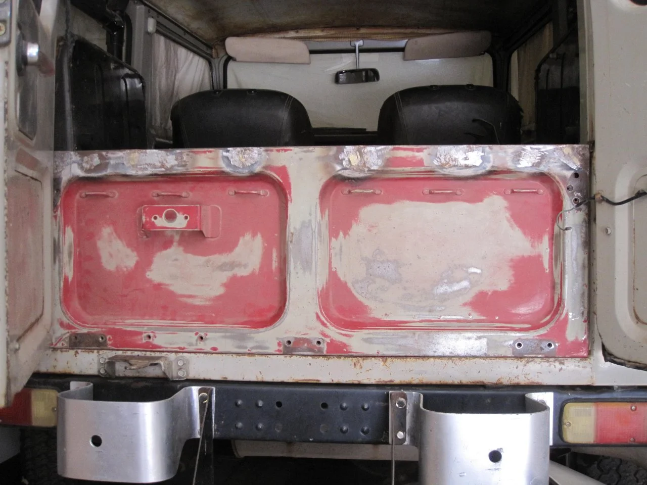

A tailgate fits flush in the notches down the sides and across the bottom. To make ambulance doors work on a 72 will require work to get the doors to fit flush since the opening is narrower than the back on a ambulance door model.
Can't really see it but this is a 78 hard top with 68 hatch on a 73 factory soft top.
Hatch fits as long as the header for the hatch is used. Would require attaching the struts and striker along the back sides of a ambulance door top. Notch on a hatch and ambulance doors is the same. The tub on the other hand is different and requires more work on the tub. Mid 1960s to 1/75 US models were universal and were made to use both hard top and soft top.

No. The hard tops sides are the the issue. The tub on models that use ambulance doors match the notch in the hard top from the mid 1960s on. Barn door and tailgate models do not have the notch and just a single 90° bend at the back. Barn doors and tailgates rest against the back of the tub. Ambulance doors fit flush inside the notch just like on the hard top sides. If you look at the bottom of the hatch will see a step out to cover the top of the barns doors. Ambulance doors do not have do not step to fit against the back. They are made to be flush on the tub just like on the hard top sides.
Not sure how clear this photo is. The barn doors are a little wider than the ambulance door which is a straight line on the hard top and tub.
