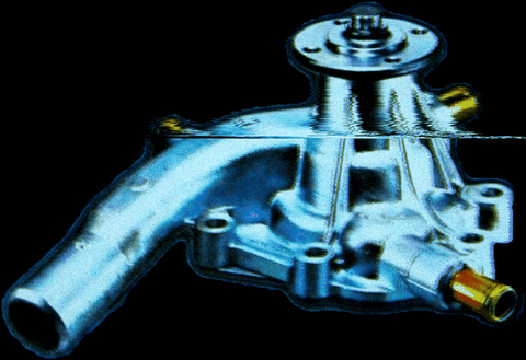

So it looks like the GMB 'Made in Japan' cast-iron water pump for early F and 1.5F engines is a gonner ? GMB part # 170-1080
First, 'JAPAN' was deleted from the casting on available pumps, even the reboxed NAPA, so I assumed GMB had moved production to Chyna... 😥
Now seems the pump is discontinued? (there are still some available, but all are without the Japan marking).
Anyone verify?
