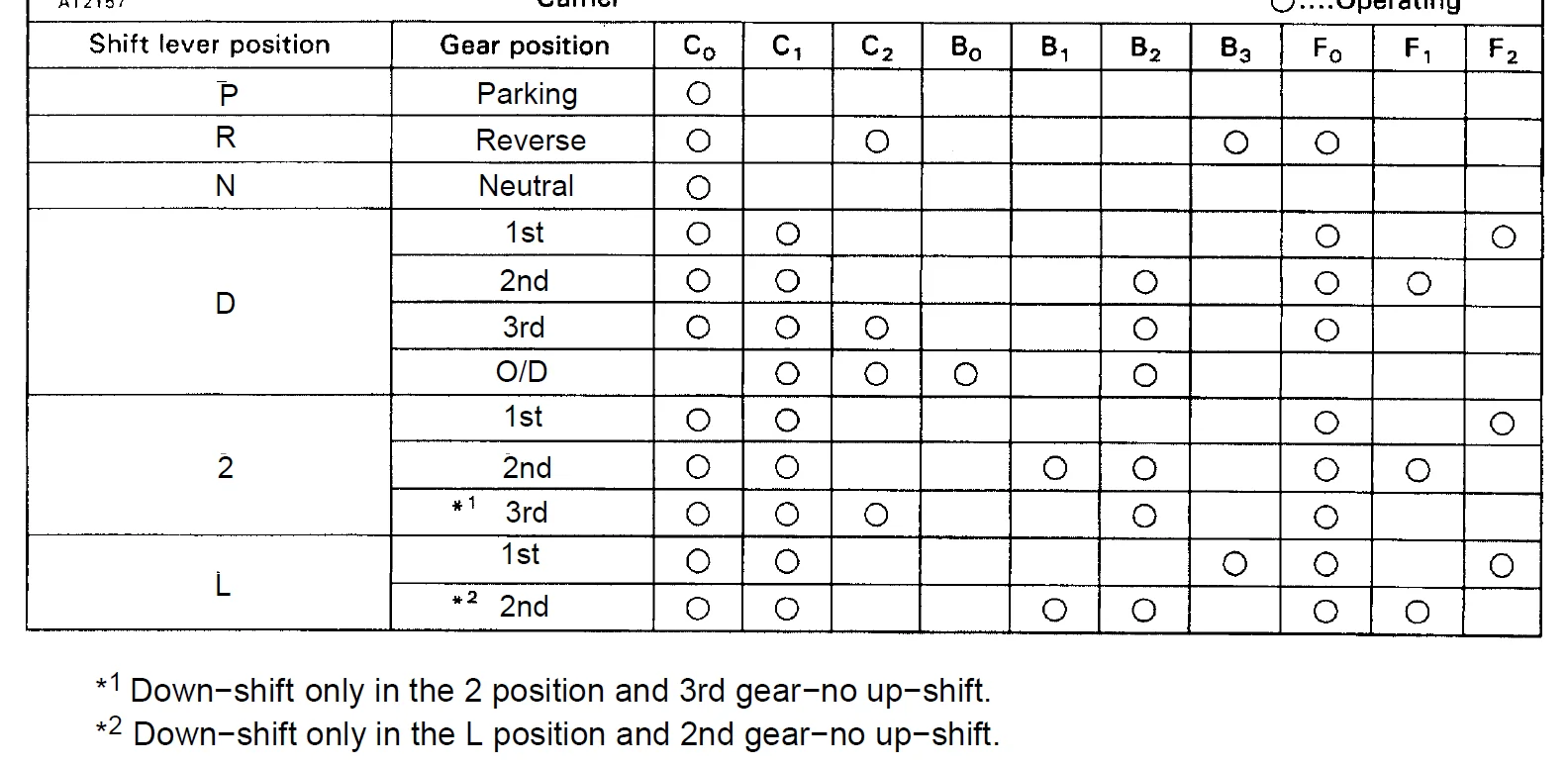

So, here's the rub, even if you select "L" (1st gear), the transmission is designed to shift into 2nd gear. If you select "2" (2nd gear) or "D" (3rd gear), the transmission starts in 1st gear, then shifts to 2nd, and then to 3rd (in "D", you also get O/D).
This excerpt is from the repair manual (RM479U), showing the normal operation:

I had my doubts when I first read the operation description, but I tried it with my '95 A343F and it operates as the manual says it should. I haven't tried my '94 A442F.
I can only go by what I see personally, and what Toyota published. I'm all for new information, but there's not much published that I could find.
So you're saying that with the transmission shifter in L, your transmission upshifts?? If that's the case, then what is the purpose of L?
Did you check the tranny fluid level? Not enough fluid in the tranny would have the same experience in my A440F.
I can't begin to guess why the transmission is programmed the way it is. When I was an axle engineer, my next door neighbor (in the office) was the transmission engineer. He was constantly reprogramming transmissions that were supposedly finished, to suit customer requirements - and we didn't build custom transmissions.
