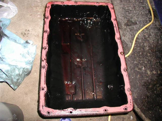

Just put a small bead around the entire metal flange that's on the tranny pan. There's 19 holes...just put the bead about an 1/8" wide between each screw hole and then a bit around the screw hole.
You've got about 15 minutes from the time you apply it till you need to install. YOu can torque right away. I put the FIPG on, lifted it up to the valve body, put two screws in on opposite ends (you'll need an extension on the cross member end) and then added bolts opposite of each other torquing per FSM specs. Don't over torque these bolts. The FIPG does a good job. 30K miles so far and not a drop from the pan.
Good luck.
-onur
ps: the pic below is the old stuff on it. I didn't take a pic of the new FIPG when I was doing this. Anyway, just to give you a reference point.
-o-
