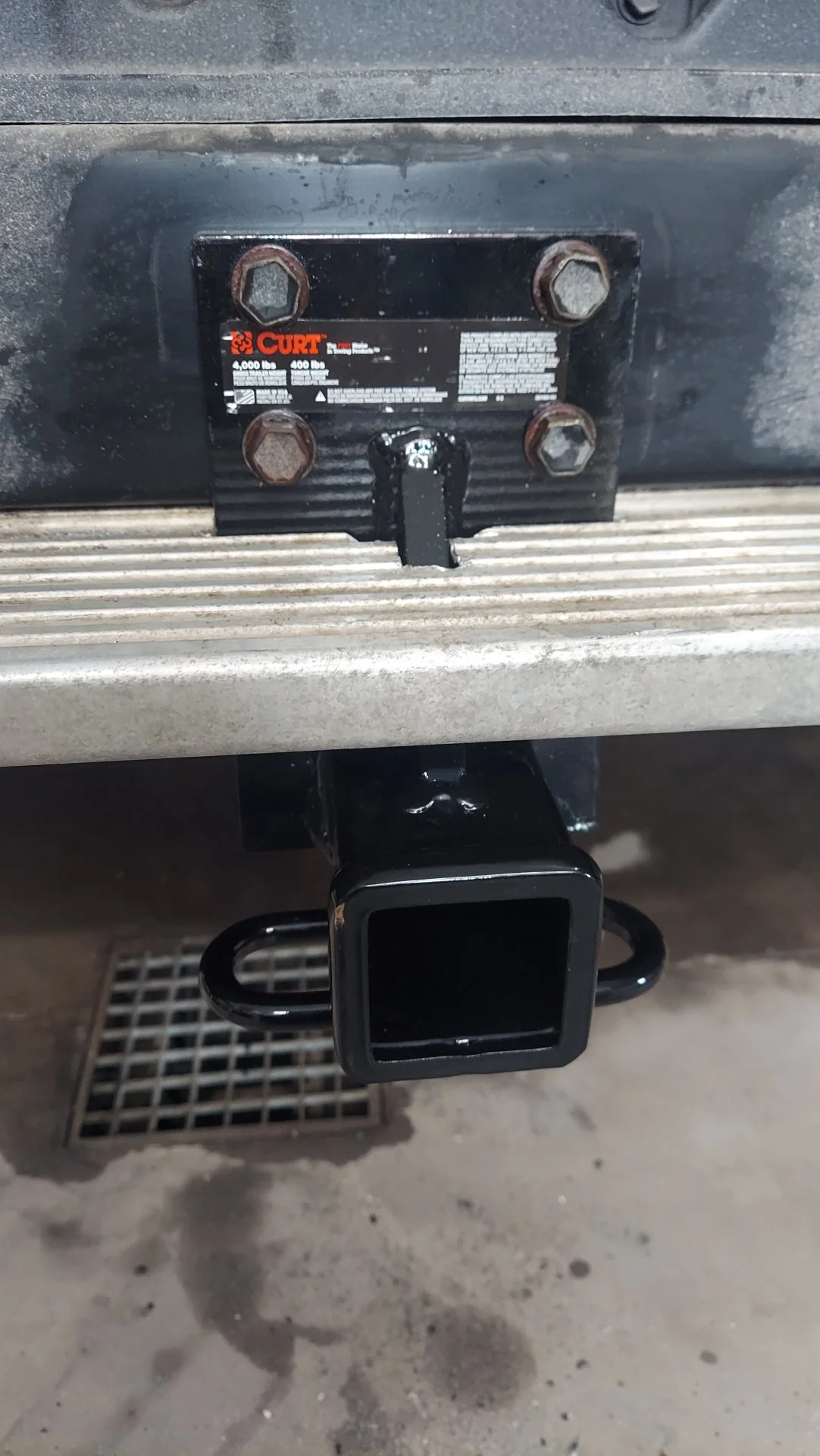

The factory frame mount in the center isn't real strong. I think the best way to setup for towing is either a custom receiver hitch bolted to the outer frame rails or the Kaymar bumper upgrade has a receiver hitch built into it.
Thanks green thing, that’s what I’ve gathered from what I’ve read so far. When you say the factory mount in the centre isn’t real strong are you saying don’t tow with it at all or only use is for light loads? I’m only looking to tow a small 3m poptop caravan probably 1000kg fully loaded.
Hopefully I can find someone in Australia willing to do a custom receiver hitch as I have chrome bumpers so the kaymar bumper upgrade would ruin the aesthetic.
The kaymar bumper saved me once already when an old lady clipped the end of my bumper one day in heavy traffic when she was changing lanes and all I had to do was remove the paint from her car that was on the bumper. To me personally, the kaymar doesn't ruin the aesthetic and the hitch is built in very well.
While I love the look of the OEM bumper, it doesn't do much for protection and is a rust magnet and also damage multiplier IMHO.
@KZJ78 lover like many others, I also installed a curt bolt on receiver hitch that matches the bolt pattern but I think that crossmember is really only designed for pulling your rig out of a ditch, not for any significant towing. I installed mine solely for the purpose of a bike rack, and it works ok for that. Surprisingly, a bike carrier with 4 bikes on it twisted the frame rail some vertically on a recent road trip, I was kind of surprised it was that weak. I personally would recommend a more robust receiver hitch mounted to the outer frame rails if towing anything more than a couple hundred pounds. There are some universal kits you could buy and install yourself or a local fabricator could easily do something I would think. I'll be going the Kaymar route eventually like @FJ73Texas said, its just way stronger and serves many other purposes. kinda $pendy though.
