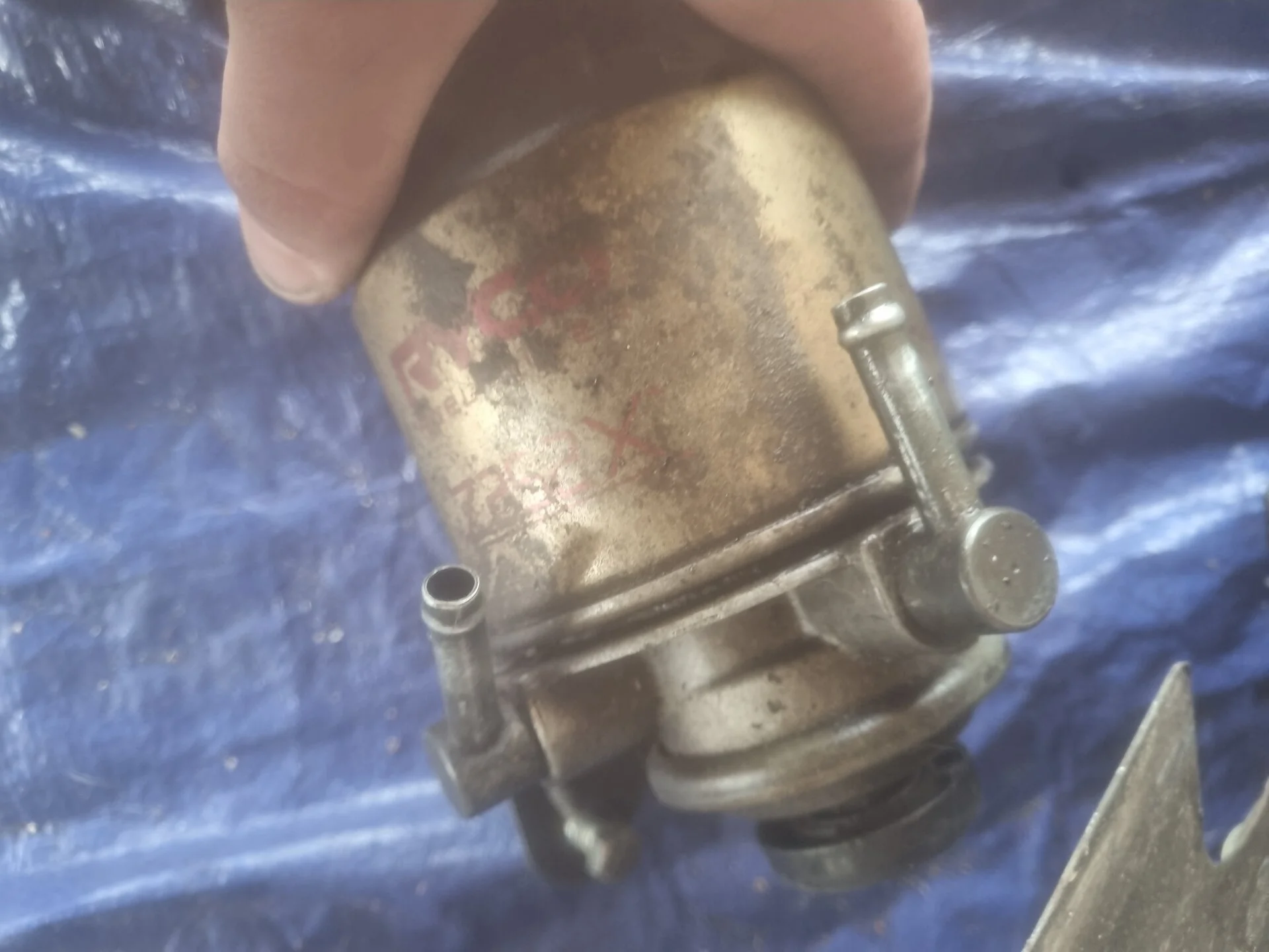

So recently I did a engine swap for my 3b and my previous one was well, not good. Anyhow
My old 3B had a rotary fuel pump so the fuel lines it had were just hoses and hose clamps. Where as now my new (to me) 3B has an Inline fuel pump but the fuel lines have Banjo bolts which along with that means my old fuel filter housing is different (seen in photos)
Is there a way I can make the inline fuel pump use hose clips and not banjo bolts or just in someway make then compatible. Because iv tried looking for the other fuel filter housing but locals parts dealers can't find anything and nothing I can find Second hand
If they're larger ID then buy brass barb joiners off the shelf from any repco/supercheap that go from one size to the other, and a short length of the smaller size hose. Or do the dodgy and put the bigger hose straight on and just crank the f out the jubilee clips.
