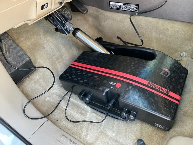

I've used a Roadmaster Brakemaster system on 3 different vehicles. It's for motorhomes with air brakes. Works great.
The important thing is this - With the key off, pump the brake pedal about 40 times to drain the pressure out of the power brake system. Supplemental brake systems are set up for vacuum systems that aren't providing boost with the engine not running. Our electric power brake system needs to be drained otherwise the supplemental brake system will be "slamming on" the brakes for the first 30-40 stops. This gets complicated but some supplemental braking systems are set to exert less pressure assuming that the key is left in the "on" position and the electric power assisted brakes will keep running. Those vehicles that need the key on to unlock the steering wheel end up running the battery down and need a charging wire from the motorhome. But fortunately, the GX470 steering wheel can be unlocked in the full "off" position, thus no battery drain. Just don't remove the key.

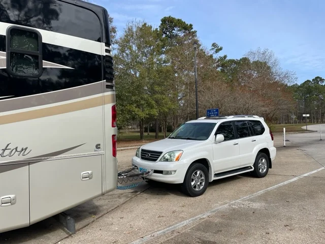

Got the GX all setup. Not cheap, works great so far. Only about 1000 miles on this setup. Break needs some help, outside of that good to go.
GX looks like a toy behind that motor home.

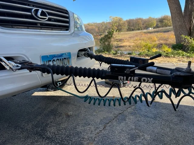

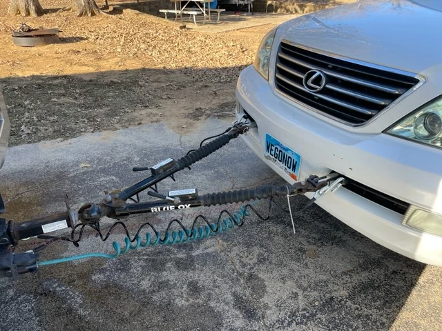

Fantastic! I am going to purchase the 09 and use the blue ox baseplate as you did. Did you do the install yourself? Anything to tricky? From your picture it is hard to see...are the holes for the safety cables roomy enough to not scratch the bumper fascia? Would it be easier if they were bent down? You have the plug under the bumper? Thanks again for the help!
PMd ya.
Keep in mind that whatever you're towing the GX with the towbar should be as level as possible (within 2-3"). On mine it would have been too out of level. So I flipped the baseplate upside down and it came out perfectly level. I had to drill one hole through the frame on each side.
