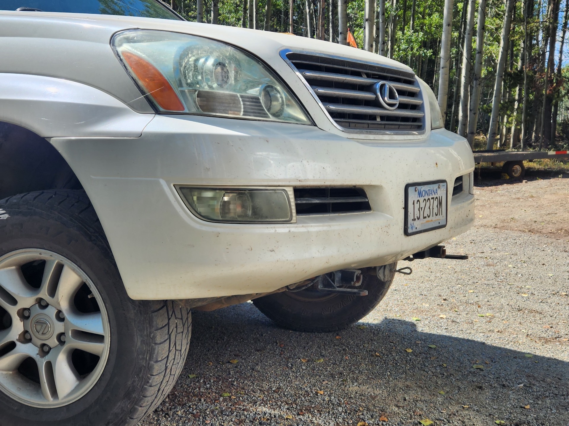

Keep in mind that whatever you're towing the GX with the towbar should be as level as possible (within 2-3"). On mine it would have been too out of level. So I flipped the baseplate upside down and it came out perfectly level. I had to drill one hole through the frame on each side.
Thanks for the tip,,,interesting idea to invert the baseplate.
The PO of my GX had cut the bumper. When I installed the baseplate upside down the tabs came just below the bumper where it was cut.
That looks great, what year is your GX? Blue ox baseplate for the 06?

Doesn’t seem to be a good place for the 6 way receptacle.
Where did you put it? i was wondering where the heck to stick it reading the manual. It seems like its easier to flip the bar and have everything right under the bumper.

just re read and saw the flipped bar needs a bumper cut. Tempting.

Ended up installing baseplate inverted. Didn’t even have to cut fascia to make it work, just a small cut to access umbilical connector and breakaway that I mounted on top of oem bumper. Height is perfect for my class C, no need for a drop hitch.
