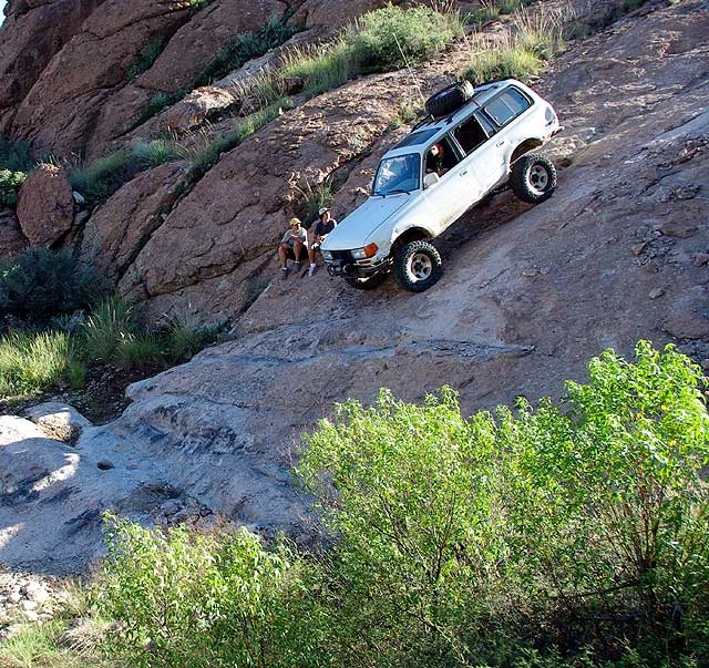

... When you're decending a ~35 plus degree rock slope with decomposed granite under your tires (ex. the 'Luge' on the Martinez Mine trail in Az), trying to keep the speed at ~1-2 ft/sec, any sudden change in speed is likely to cause you to lose traction and therefore control of the vehicle. ...

I know how it worked on the decent pictured, the setup is trans first, transfer low, CDL locked (some would correctly argue that it should be open, I didn't see the need for this hill). Brakes controlling speed all of the way, throttle just above idle most of the way down, as I came to the first hole (~15' ahead of Spike with the black tire rubber marks) I throttled up slightly. The throttle is for two reasons, first; going to need to maneuver, so want plenty of steering assist. Second; the decent is off camber to driver, the big hole is hidden by the branch, when the driver tire drops into it, we're going much more off camber, the passenger rear will rise, if the driver rear looses traction it will come around and the only way to save it from rolling into the wash below, is instantly throttling out.
So the torque converter was loaded in forward all of the way down, it's effect was about zilch.:D Unless you have a light rig with a crawler box your not going down it without brakes. If you would like to demonstrate some other torque converter action on it, come on down, it's great wheelin weather, that hill is in a scenic, fun wheelin area close to town.:D

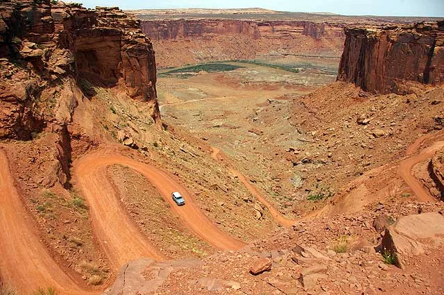

It's fun to web wheel, but remember that wheeling is different everywhere. Most Aussies use their rigs very differently than most of us do. In Arizona we are very lucky, loads of good wheeling, in very different terrain, from mountain forests to dunes. When I go one state away to Utah, have to reset my butt meter, the techniques/lines that work in Moab wont work here and vice-a-versa.
Here is a pic of a cool local rig, one of tons of them around here, they are extremely capable in the rocks. When we are on the trail, even the same obstacle, the line that works for my rig, probably wont work for his and vice-a-versa.
