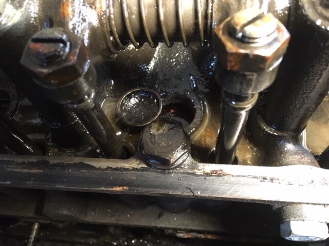

Removed side inspection cover and freeze plugs looked intact. Added water to radiator and water started flowing down out of pushrod holes from above. Removed valve cover to observe the first three (in row from front to back) freeze plugs lying along side their holes as pictured below. Plugs, gasket, and FIPG on order from Mr. T.

No expierience, but I've seen a socket used for install with a hammer, or you could remove entire rocker assembly in 1 piece I believe. Glad it's that and not a head gasket or cracked block 😉.
This ^^^
I would feel best about pulling the rocker shaft and checking all the freeze plugs up there (not sure how many are in the head).
Make sure none are loose.
Such a cool outcome! The freeze plugs did their job!!!
J Mack that's interesting. I'm still debating pulling the rocker shaft or not. I was trying to save the extra work of readjusting the valves again when it had just been done, then buttoning up to later find a crack in the head.
The videos I've watched of core plug installs look like a significant hammer hit is needed. I wouldn't want any angle to send the plug crooked. I'll mock up a swivel on an extension and visually "play with that idea." Parts won't be in at dealer for a few days anyway. Thanks.
You could always experiment w/ the old plugs.
