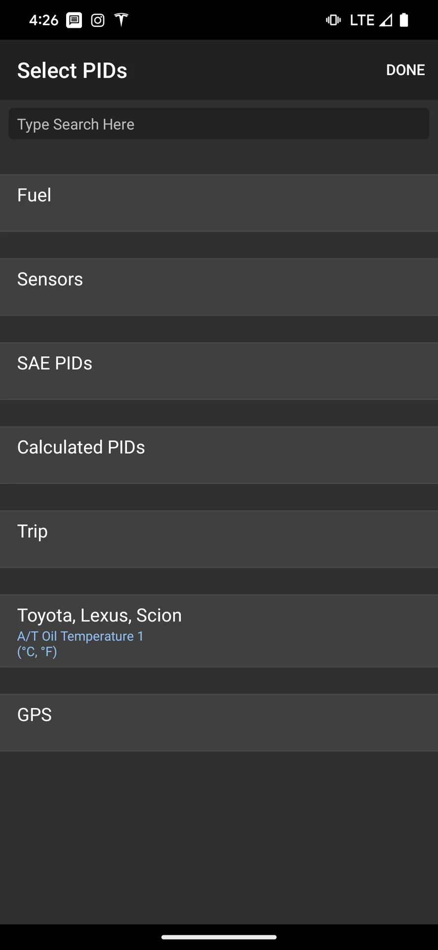

Also I assume you know you'll need to do the complex process to get trans temp on your MFI, or use techstream or OBDFusion to get trans temp readout to set the level..

..... Also I assume you know how to... on.. OBDFusion to get trans temp readout to set the level..
I have the OBDFusion ... could you please tell me how I get trans temp on it?

Trans temp via OBDFusion:
I dropped the pan it the last time I changed the trans fluid and I'll drop it again when I do it next time. You sure do not want to flush these transmissions, you want to just change the fluid . i.e. run the fluid through and out.
Most of the info is in the link above. IIRC, you'll need the Toyota PID add on. Search for A/T Temperature 1, and 2
Thanks .. I was looking in the wrong PID for it.
I Found one that says "Received A/T Oil Temperature from ECT" .. but I do not see the a temp 1 and 2.
Has a range of min -20 to max 210
Just want to confirm you did buy the Toyota PID pack? OBD Fusion won't show transmission temps without that $10 add-on
If you did but you don't see it in the menus, do a re-scan while parked... sometimes not all of the available PIDs will show up until you do that
Thanks, I was looking in the general PID and not the Toyota PID for it. I found it now.
