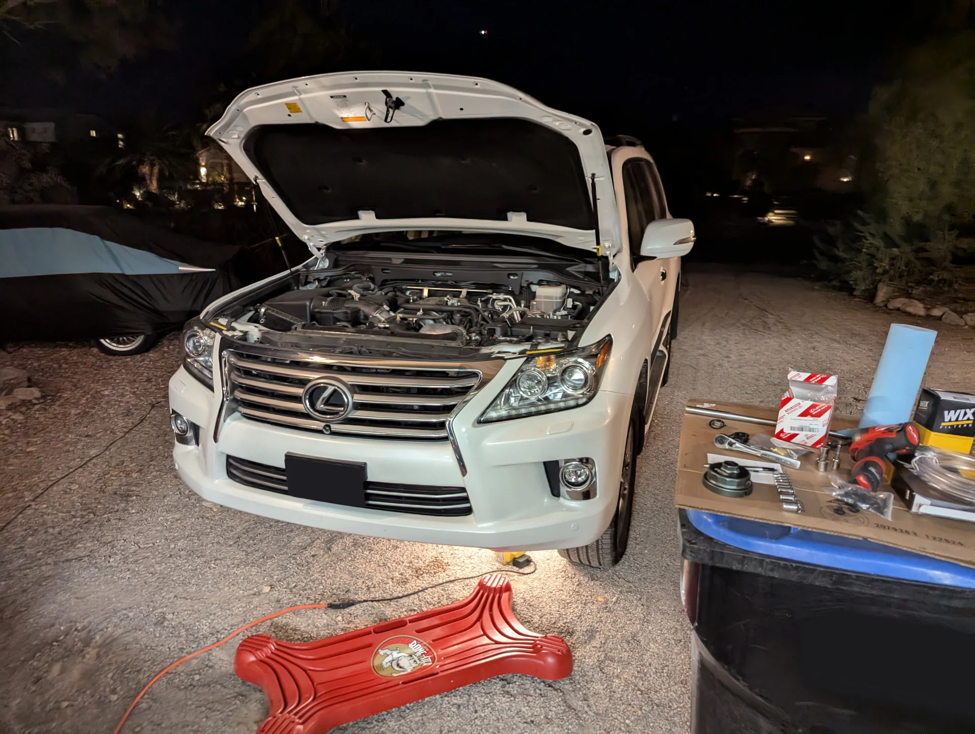

First oil change. Pumped out the oil from the dipstick tube, got 7.5 L, then got another 0.5 L from the filter. Slightly over capacity (likely the dealer had over-filled), but not too bad. Not a single drop came out from the pan drain, which I've never seen before (oil temp was hot, filler cap off, dipstick out). Since it seems like the pump + filter drain method will get all the oil, I declined to install the Fumoto, and plan to just leave the plug in place. Thanks to the wealth of knowledge here, I expected some of the shield bolts to be mixed up and over-tightened (check) and the filter cap to be on too tightly (check), and I was ready to go with the right filter wrench and drain tool. This was ridiculously smooth.
