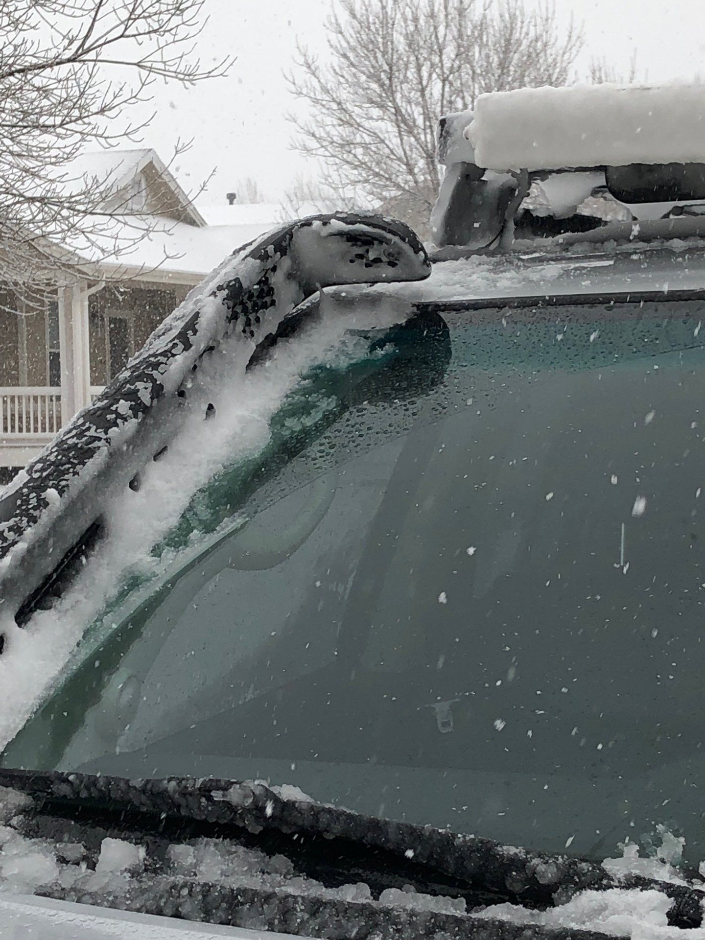

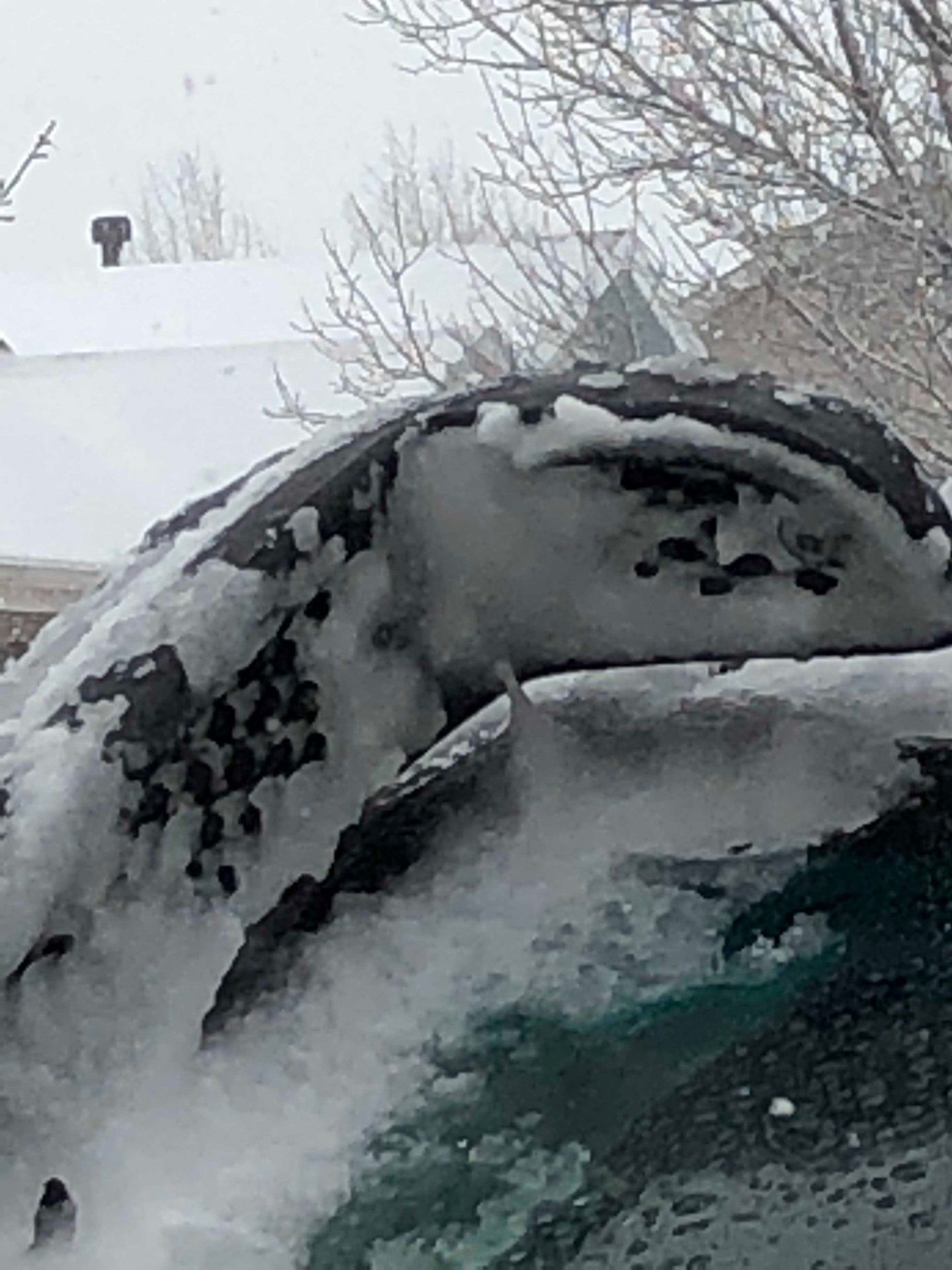

ok these pics are from going 5-10mph, and the wind and snow blowing from left to right...
View attachment 1926647View attachment 1926648View attachment 1926648
Wow… You read my mind. Last night I was about to post a question about wet snow accumulation as it sweeps upward in line with the wind shield. That does not look good.

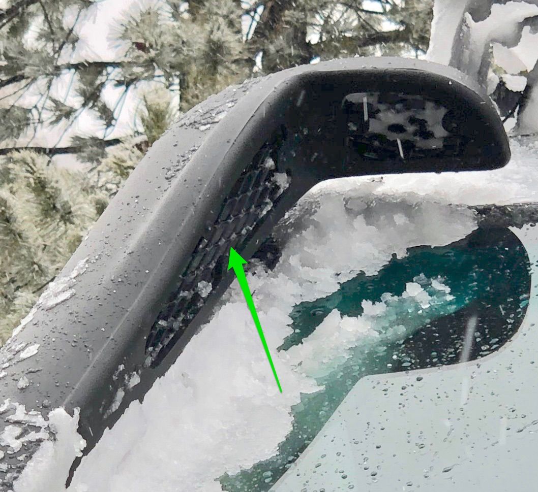

EDIT:
I was wrong. I couldn’t see the second vent at first. Brightened the pic and now see what I missed. Here’s a tweaked version that’s easier to spot:
1926686
this is seriously worst case scenario and when going faster it doesnt do it. if you look at my light bar you'll see 1/2" of snow on the lens. the wet heavy snow is no bueno for anything.
It has two vents, one facing forward and one on the inside facing left. the one facing left looks worse than it actually was, the top one was half clogged.
if you had an ARB it would have clogged much faster and has zero options of a second vent. Even if you reversed the head and the wind changed direction it would have clogged.
Thank you. Somehow I missed the 2nd vent.
Never seen it in person and in the photo it looked solid. I see now that it’s a grate on the left.

I tweaked your photo a bit so it’s easier to see the grated left-facing vent in case others missed it in the shadow like me.
I was only seeing the clogged top, and missed the side. Much better.

I had this snorkel on a 100 series for 6 years in UT, ran through multiple car washes and snowstorms never once had an issue. The vents clogging on these is a big nothing burger, don't sweat it.
If these photos are from the storm we just got on Wednesday I can vouch that this is truly worst possible case scenario. At times I couldn't even see to the end of my own hood and would have to just stop and let the wind die down enough to keep crawling along. I did get to use the Lexus to pull a Police Office in a Rubicon out of a ditch. And at one point I got high centered pulling another car out and was able to just pop it into Low Range, Raise her up and drive right out like nothing. Good times!
These photos are from just playing around bashing some snow drifts in my cul de sac. This is before it got really gnarly and I had to go drive 30 miles across town. After that my windshield and tires where about the only thing that wasn't ice and snow.
