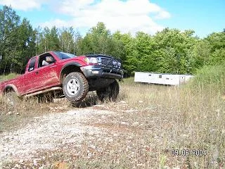

The BFG MT's that I have run in the past were on an '02 Taco and they were cut for racing, so they hooked up awesome compared to stock, but they wore quickly.
