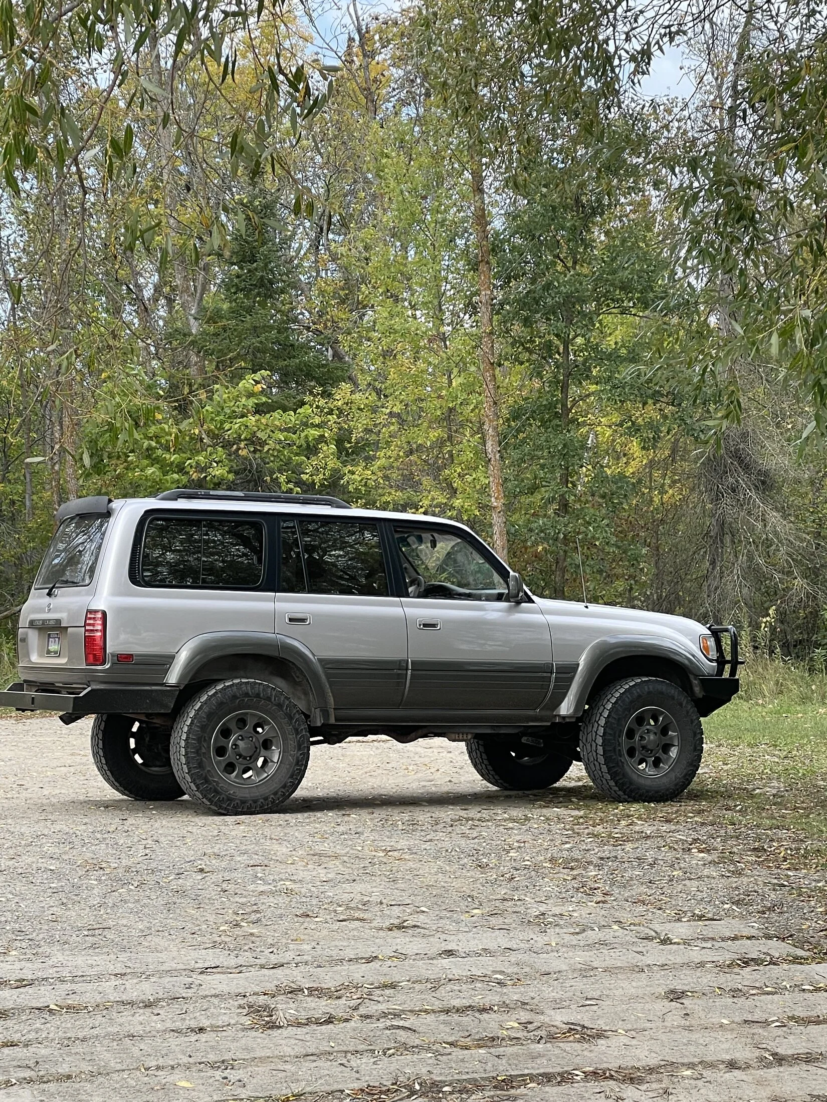

I run 4Runner steelies on my 80. I added 1" spacers to clear the rear sway bar mount and minimize rubbing in the rear (primarily driver side) under full compression. Note, my 80 is a 1994, so the rear sway bar mount is a sort of vertical strap bolted to the outside of the frame rail. The newer models have a sway bar mount under the frame rail, so it may have more clearance. Also, I have a 3" lift and didn't have panhard correction when I added the rims, that may have contributed to rubbing (the rear axle offset to the passenger side by the uncorrected lift).

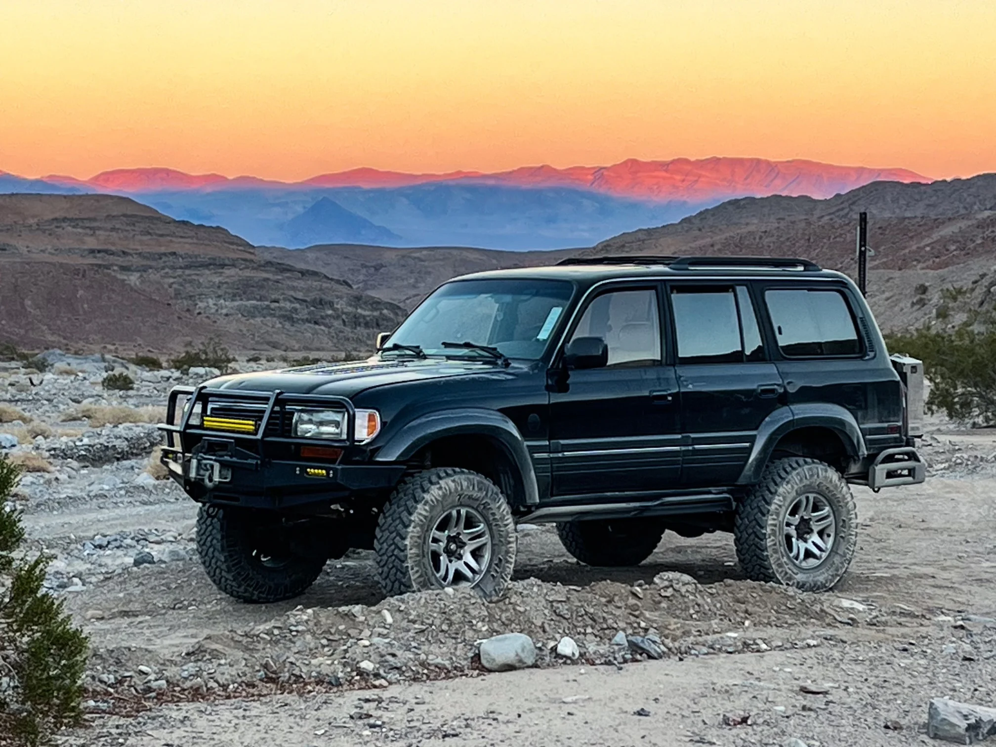

I’m running Tacoma/Sequoia 5-spoke 17” wheels.
I installed a 35x11.5 tire, not a 12.5”.
I utilized the Slee Spydertrax spacers, 1.5” I believe. Those wheels, with those spacers brought my 11.5” tires right back to factory spec width.
No rubbing & super happy now after several years.
photo from Death Valley CA 2 weeks ago.
