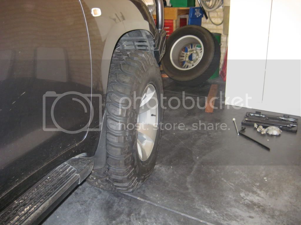

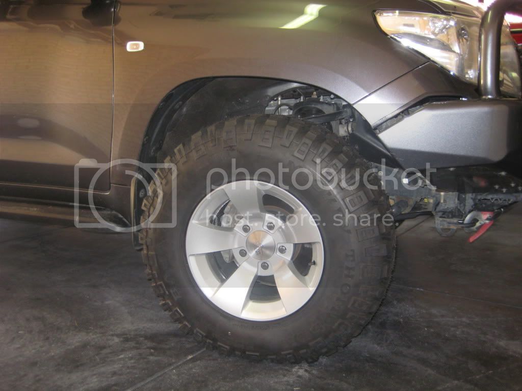

I have 35"'s, but it's the Arctic Truck model..
On these models the fenders have been cut about 4", but is it only due to wider offset on wheels..? Lift is only 40mm and bump stops bit bigger than originals.
I can try to take some close up pics tomorrow.
JBHorne,
See below 35's on shots pre any other work. You will need about this offset (+30-35mm) to allow full steering and to miss other components (easier without KDSS, mine has it!!). Then you will need Flares because of this offset (and guard cut to make use of full travel). See full build thread here LCOOL.org :: Log in (may need a log in?) and mag write up Modified LandCruiser

The Arab mod is a full Arctic Truck version (they will sell you the Wheels also, not Flares though).
Mine has full lock to lock steering on 35's (with KDSS) Arctic Truck said this was not possible??? Without KDSS, I would guess 36-37's were possible (more Guard work would be needed though).
Mine is also a daily driver (95% on road) and impact on ride is almost impossible to tell, yes road noise is up (due the big muddies) handling and feel is close to original, acceleration slightly down (but chip and exhaust and 800+ NM fixed this, diff ratio change would bring this back and/or add further improvements if needed).
The cutting is easy (will cost nothing if you are just a little handy) but you will need to buy the Flares ($1000-$1500).
Without the correct Wheel offset and other requirements done, you could drive it around but it would rub and not turn very well as you say!
I would do it again as it's good on road and fantastic off, it will take a little work and $$, so if you need and want 35's, do it.

JB,
Rims are Arctic Truck (branded and produced by/for them) 17" x 10" at 30mm offset per photo.
Tires LT315/70R17 (Mickey Thompson MTZ's) or 35" x 12".
Cheers
Steve
