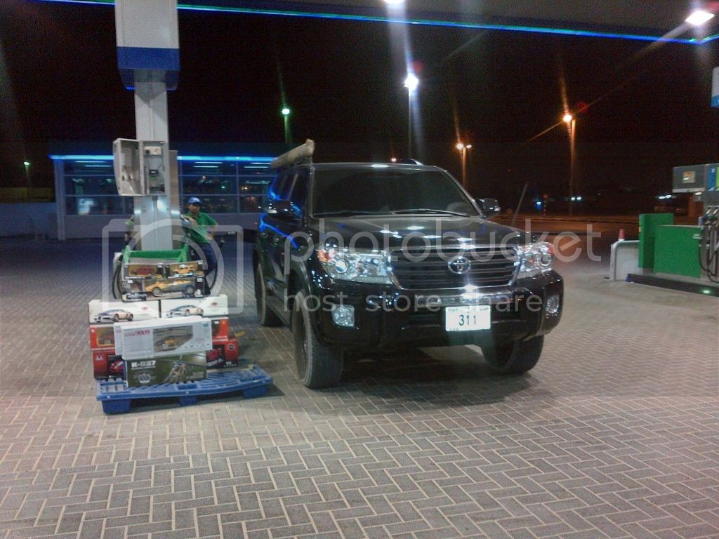

That's why in the end I told the salesman that I wanted a lift and wanted the front and rear balanced. If you see the desert safari 200's over here they have a higher lift at the rear so it balances when it's heavily loaded. He said the front are 50mm and the rear are 25mm as the front end is heavier and I won't be carrying heavy loads. Approx 100kg once a month. So I just told him I'll have it fitted and if one end is higher than the other I'll come back.
Also not sure if it plays a role but my cruiser is not equipped with KDSS
My cruiser is a GXR"+"

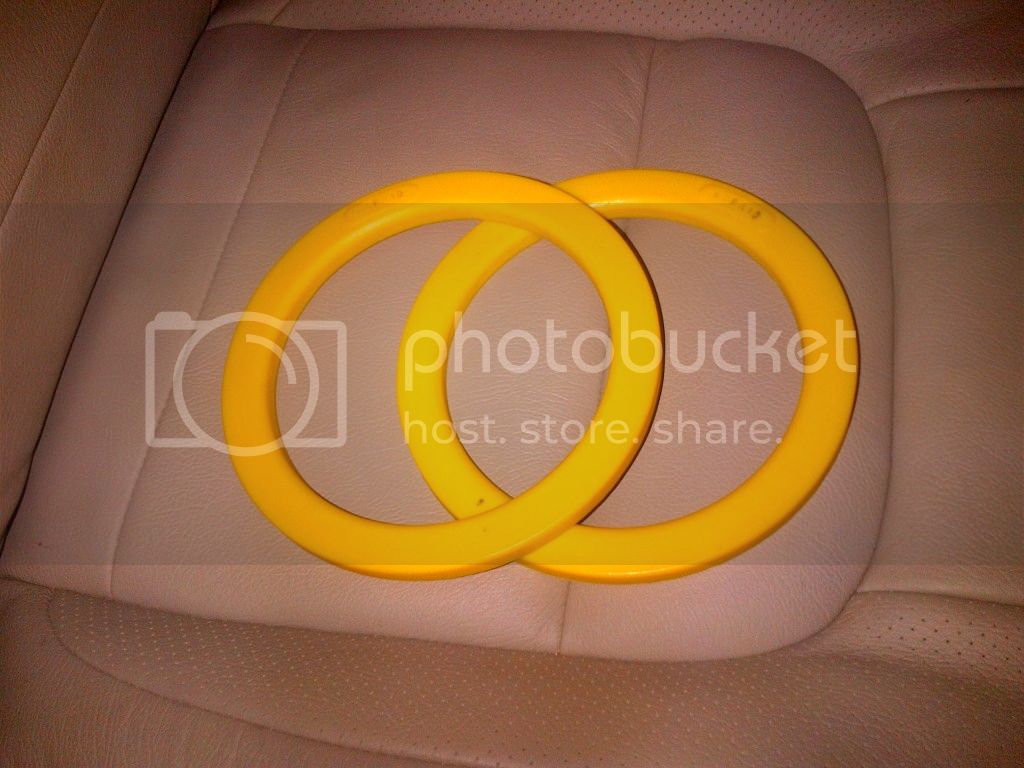

Had a talk with ARB. The rear springs will lift the vehicke less than 20mm and and aren't negative springs that'll lower the cruiser. With this setup the vehicle is levelled out but the rear springs don't sit in their housings and are very loose when the wheels are at full travel. So was given a set of spacers will fit them on wednesday and see if that solves the problem. Not a solution but hopefully will stop the springs clanging on every bump and hump.
*Edit: Still some play with the spacers on :mad:
** Did a 400km round trip to get down to ARB and replaced the rear springs with the OME721 (medium load) which sit properly in the housing.

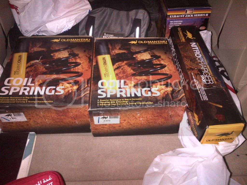

Finally! After long research what spring and shocks will be install. I decided to go with:
Spring
OME 700 front
OME 721 rear

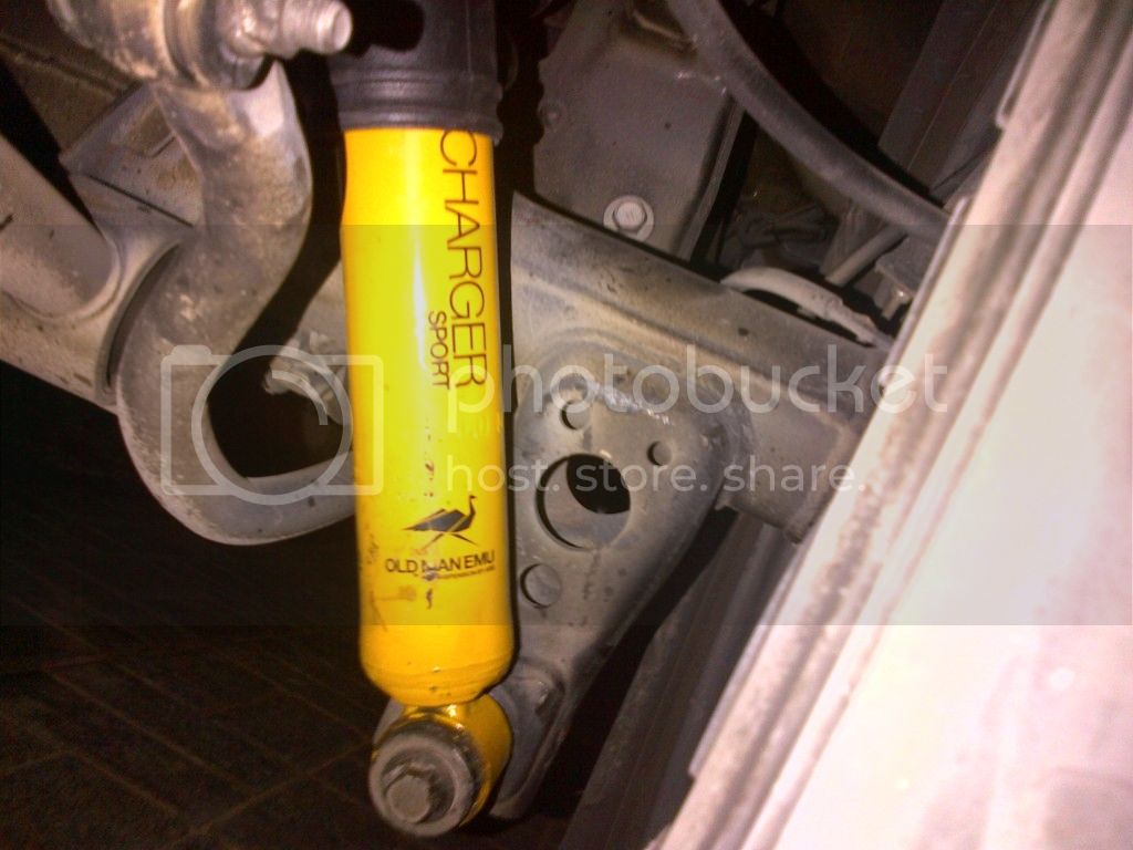

nitrocharger shocks only.
Some of my friends said that using the SPORTS shocks will give a firm ride as the non sport has soft valving.
I will feel and see the height and ride.

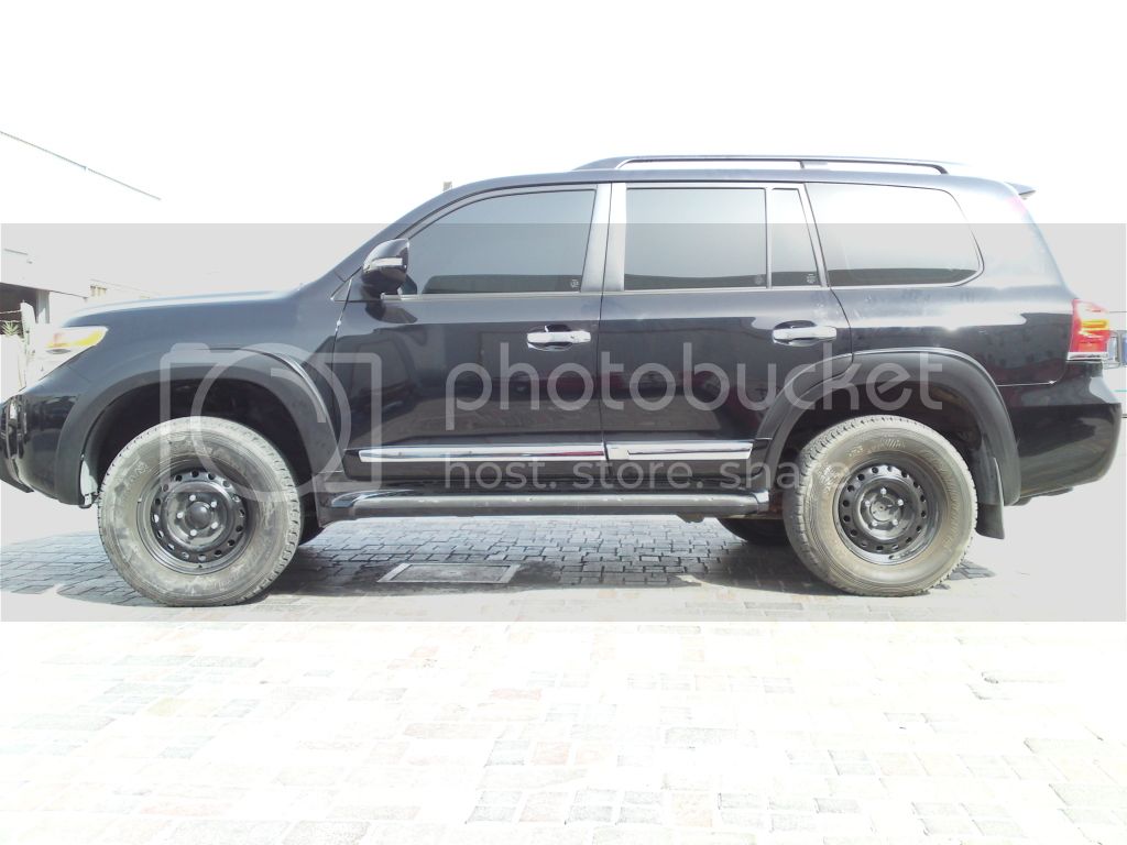

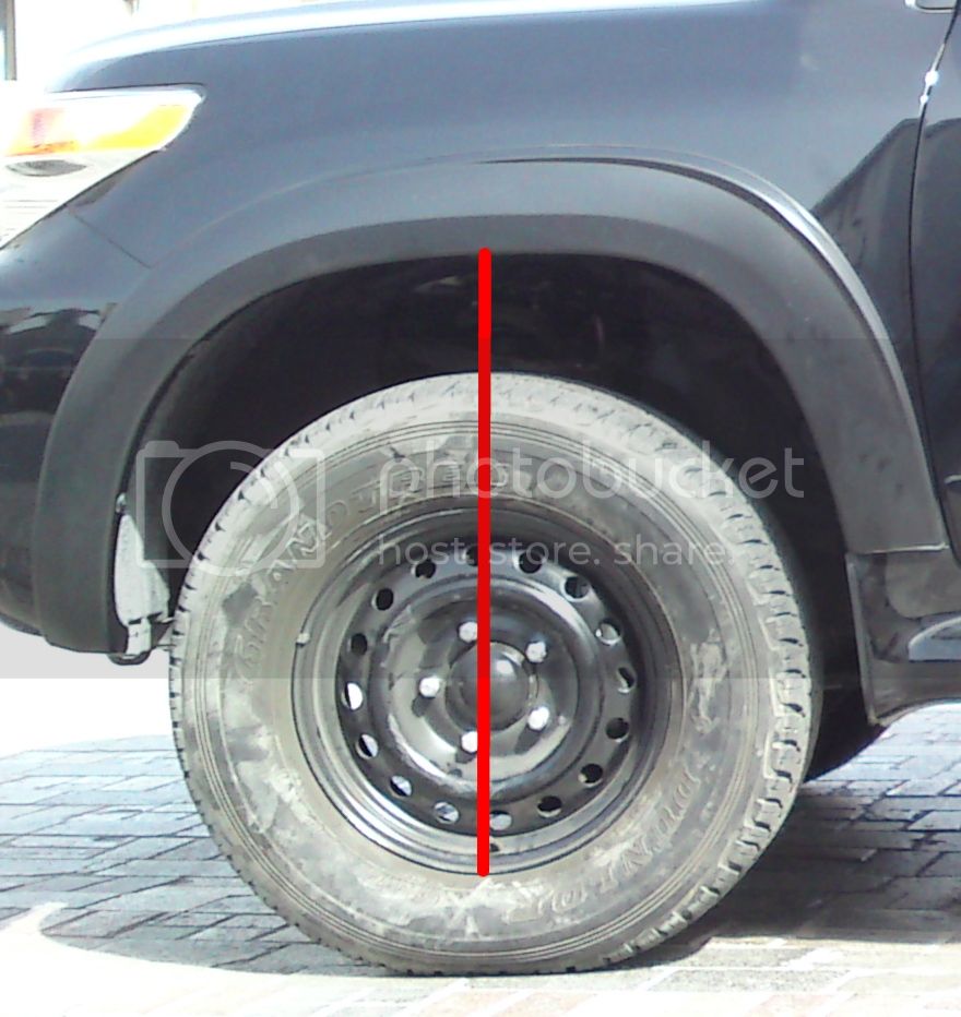

I'll get some pictures tonight, the rear end is slightly higher than before.
As for the measurement, you measured from the bottom of the wheel to the fender, I'm guessing like this
Desert Nomad, Thank you for the post. What spring did you use? OME721 for the 31.5"? and since you installed the fender flares is it the same level as the original fender?
Yes, I changed the rear springs to the OME721, and the fender flares come out very slightly not more than 5mm.

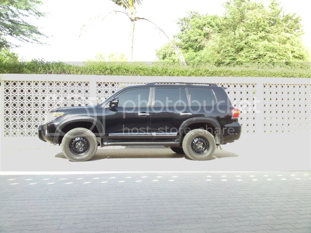

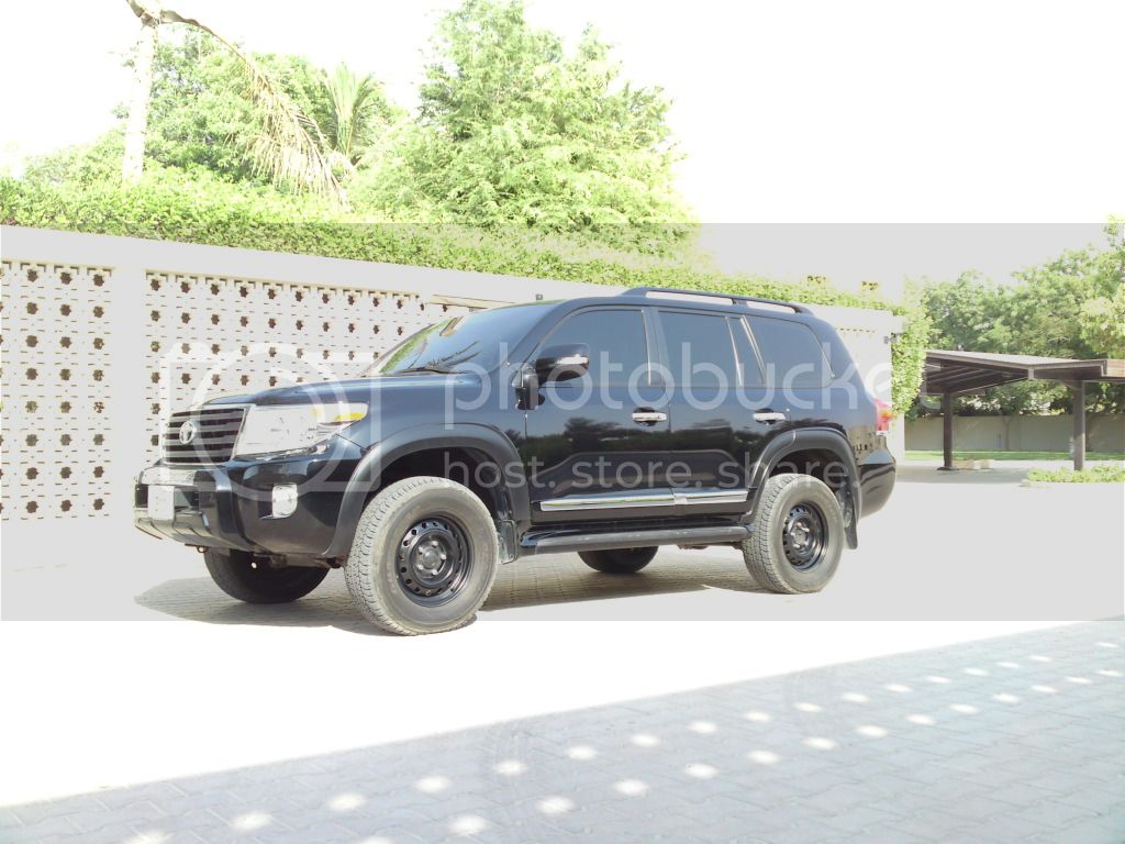

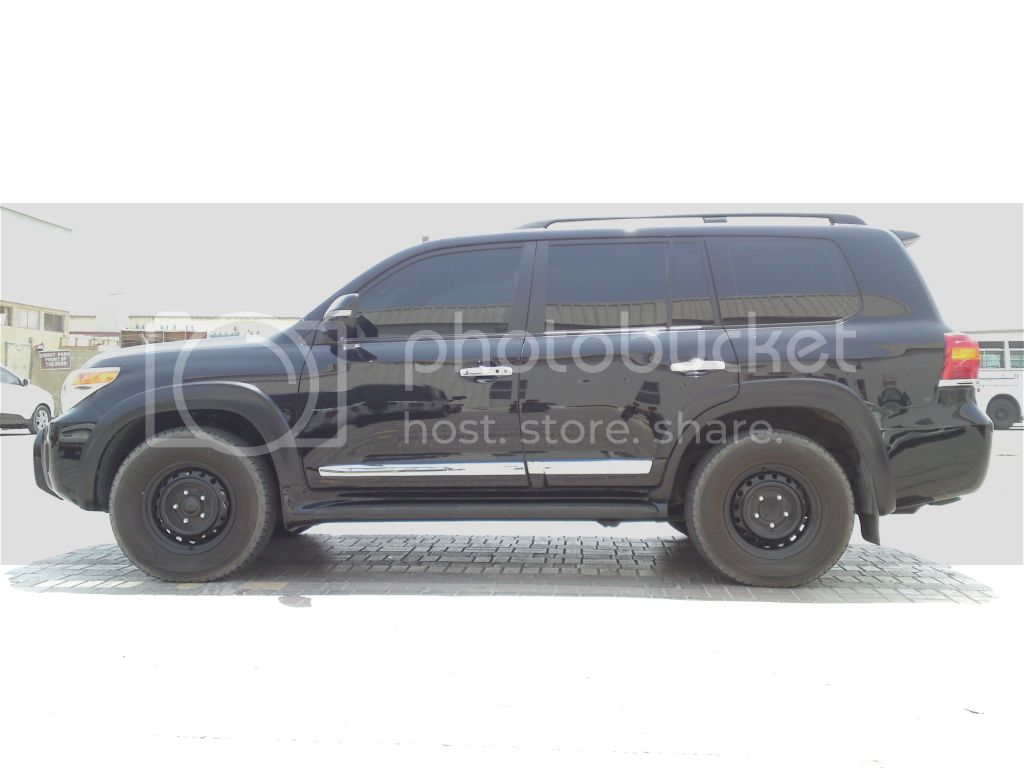

I finally got the unit with the spring and shocks installed and re aligned the wheel. everything is just perfect as what i wish to happen.
now was
front 30.5" 28.5"
rear 32" 31.5"
measured from bottom of the 17" wheel up to the fender.:bounce::bounce2:
now was
front 30.5" 28.5"
rear 32" 31.5"
Congrats! Looking good, my next step is to get larger tires. I think there's around 3” of clearance between the tire and mudflap / sidestep
