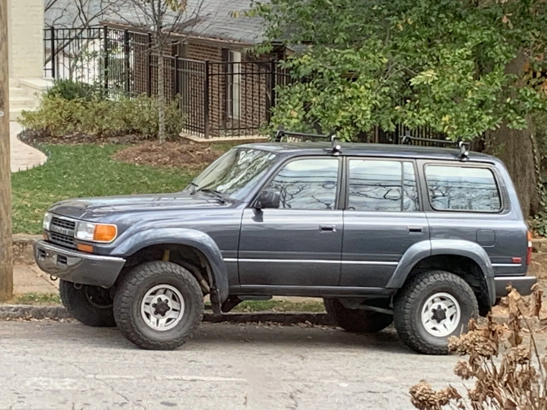

Here’s a pic my 92 with 33s 12.5 and a 2.5 inch OME lift. Really like it, but will go from the 12.5 inch to the 10.5 when it gets new shoes. Tires are really a bit too wide for the wheels
Thanks Rex! Good looking rig! At this point I'm leaning towards exactly what you are planning when you need your new shoes.
I think 33x10.5 is the ideal size for a 1991.
You are gonna like it and (even with the increased resistance of the wider 12.5s) the performance drop with 33s is not that noticeable. The 3fe is always gonna be slow but dead reliable. Keeping it in tune and desmogging (if you location allows) are the best thing you can do for performance

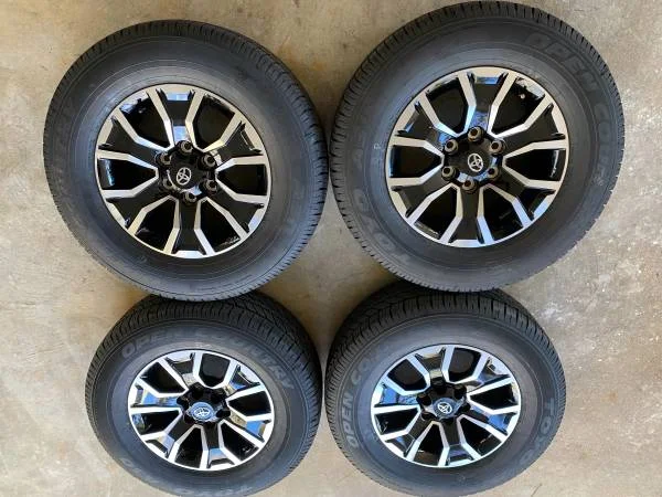

I found this set of dealer take off wheels/tires nearby:
Brand new came off 2021 Tacoma rims and tires 17 inch. 265/65R17 Toyo Open Country 6 lugs 6X5.5 comes with lugs.
Can anyone tell me if they will fit mt 1991 FJ80 with a 2-2/12" OME heavy lift? Modifications needed?
Or are these going to be too much for this motor?
Can anyone tell me if they will fit mt 1991 FJ80 with a 2-2/12" OME heavy lift? Modifications needed?View attachment 2564861
Those are tiny they should fit stock height
That should fit just fine. Might sit a little bit inboard of the stock wheels, but not by much. That's basically a 30.5" tire, so it might not accomplish your goal of "filling out the wheel wells."
They will fit, but the center caps may not. Different hub styles.
