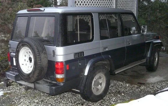

diff-locks? Looks like a nice truck.
You'll have slim choices finding rims but there are a few out there with the correct offset.
I hate wheel spacers so I would say research them a bit. You can buy some plain janes right from toyota.
They look half decent too.
Thanks, Unfortunately no diff-locks!!!!
I'm thinking of just using the rims I have - they are 16" and measure at 7" wide - even though they look wider.
The little studs around the wheels are coming out - thinking of just pulling all of them out and being done with them - anyone done this on these wheels?
