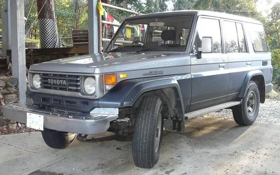

After a lot of thinking I decided on the 235/85/16s
A couple of things influenced the decision.
No turbo
Auto trans - geared a little taller than the manual.
So far, it looks like a great decision.
Overall handling in much improved.
Rain and snow traction is excellent.
And preliminary indications are that fuel economy is improved by about 1 liter less per 100 km. So about 10% - be interesting to see if this is confirmed longer term.
Here is a pic of the new tires - guess we all have different opinions on the aesthetics of tall and skinny.
