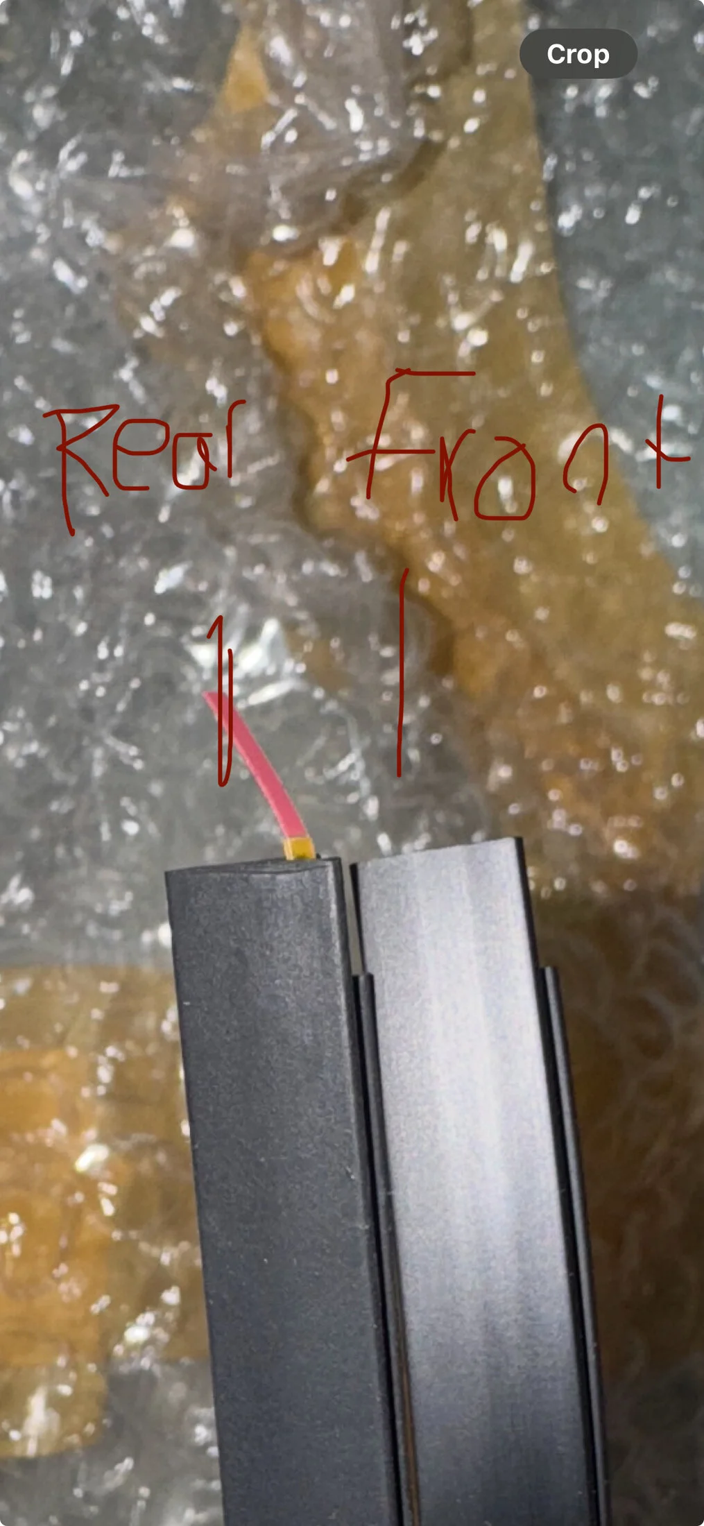

Hello,

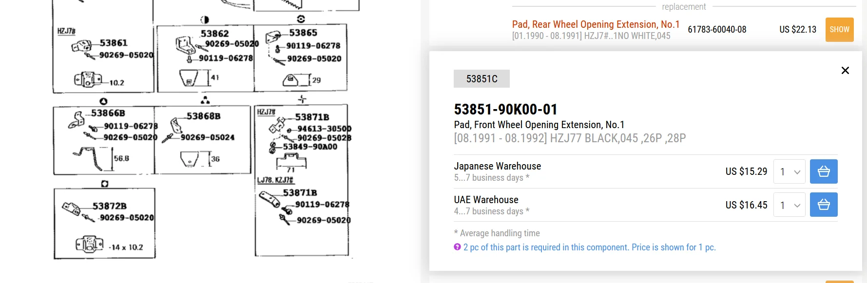

I was looking at replacing the fender flare rubber pads. There were many different options available so it was a bit difficult to narrow it down. But i ended up ordering #53851-9050001 for front (glossy finish)
#61783-60020 for rear (Matt finish)
With all the different options i was afraid this would happen but under the descriptions the both said “black 26p”. I would prefer the gloss finish all around but i just want it to match. Does anyone know a different part number for the rear or front.

Pads for a 77 Series truck are long discontinued.
There is a mistake in your front pad part number. Too many digits. It should be something like 53851-60170.
Front and rear pads have different part numbers. 53851-nnnnn for the former and 61783-nnnnn for the latter.
There was a design revision for these parts.
Older parts had a trim option. Current parts do not have it, or so the parts catalog suggests.
It is wise to find the part number for a post-1999 76 or 78 Series pad and use it. Some trimming may be necessary.

Hello,
The part number in the start message was 53851-9050001 or 53851-90500-01. A typo, I guess.
A new part number replaced 53851-90K00-01 after a design revision a while ago.
-01 indicates trim. Apparently, it is not in use after the design revision, or so the parts catalog suggests.
Last but not least, 76 Series flares are the same as 77 Series flares for the 1999 through 2004 model years. Post-2007 flares are different; pads may need trimming to fit.
