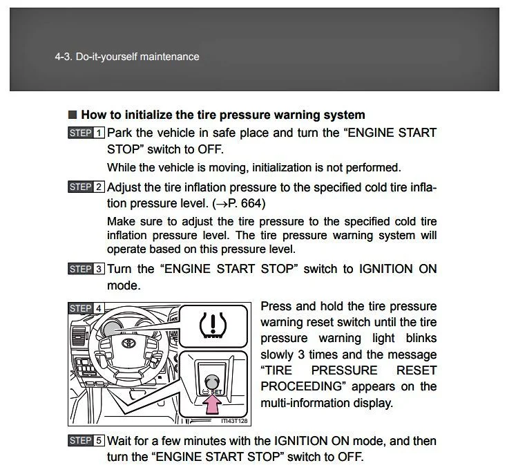

Just in case anyone needs a reminder, here's how to reset the TPMS:
With your tires set to 46psi, and the pressure warning system initialized at that pressure, the tire pressure warning will occur at about 35psi.
