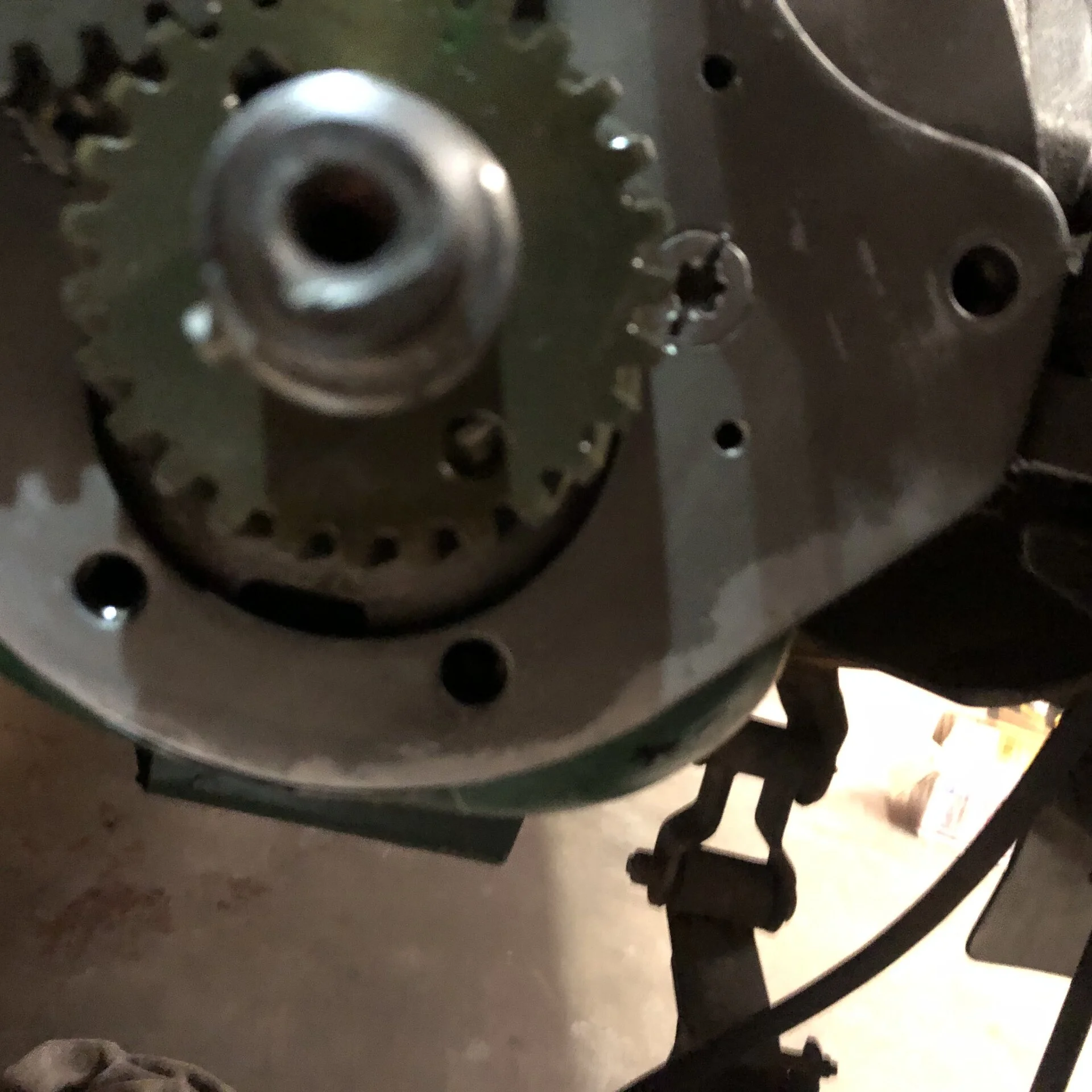

Got my newly rebuilt engine running, and noticed a slow drip coming from the timing cover area. There was a mix of coolant and oil, and after confriming the Hose of death on the underside of the waterpump was leaking ( PN 90910-05155) I assumed this was my only issue. I tightened a clamp and it stopped the coolant leak (but I think there's still a ruptrue somehwere and need to replace this hose anyway) BUT NOT the oil leak. I can't confirm exactly where it is coming from but sure seems its oozing out from underneath the bolts bottom that go on the timing cover. I'm pretty sure I used blue thread sealer on those big bolts, and I've already torqued down allt cover bolts anotehr half turn and it actually made the leak A LOT WORSE.
Not sure what the cause is, I've already read other threads like this one: Timing cover gasket....What am I doing wrong? - https://forum.ih8mud.com/threads/timing-cover-gasket-what-am-i-doing-wrong.811723/
Getting about a drip every two seconds, ONLY leaks when its running.
I've never had to diagnose leaks before and this is my first rodeo, and the last thing I want to do is go ripping stuff off without knowing what the issue is and how to fix it. So my questions and possible issues are:
1.) before I dive in I want to know how I can diagnose if the timing gear plate got warped from the mahcine shop overtigthening the oil nozzle. How can you tell this and how to fix it?
2.) I used gasketcinch on the timing gasket if I recall correctly, but after reading that other guys used ultra grey RTV i'm wondering if I messed this up!
3. The last potneital cause i've seen so far is from the oil pan, which I don't think I used RTV on the corners for the gasket....
Trying to do this the first try, and not have 3 or 4 tries like others have...
Thanks,
Dan

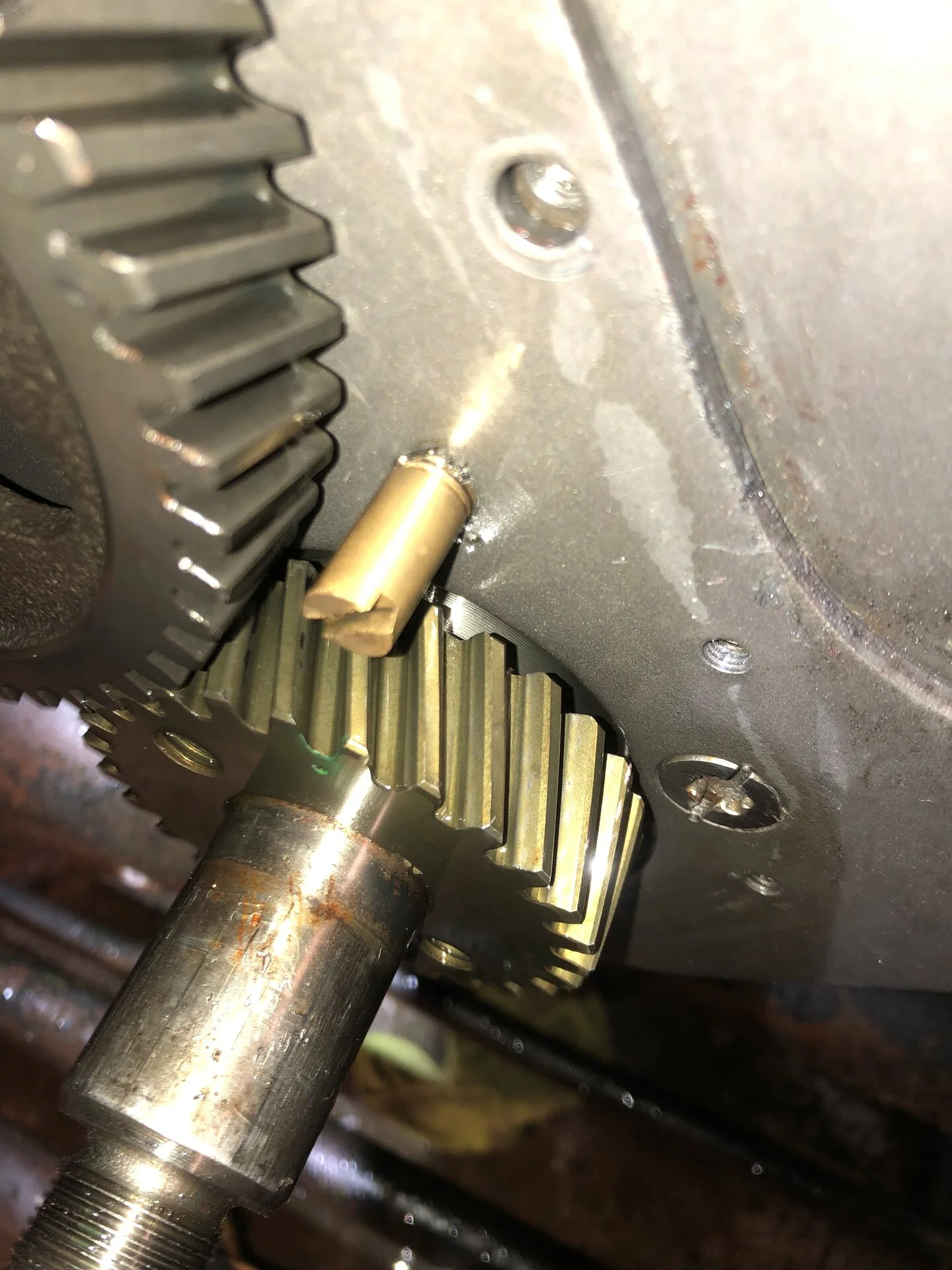

I had the same problem after putting in an engine. I would check out the cam oiler, if they tightened it down instead of staking it, it will push out the front end plate, as the cam oiler hits the hits the block and pushes it out.

it could also possibly be the gasket behind the timing cover gear plate. To get at that is an immense job. horrible. Not recommended.

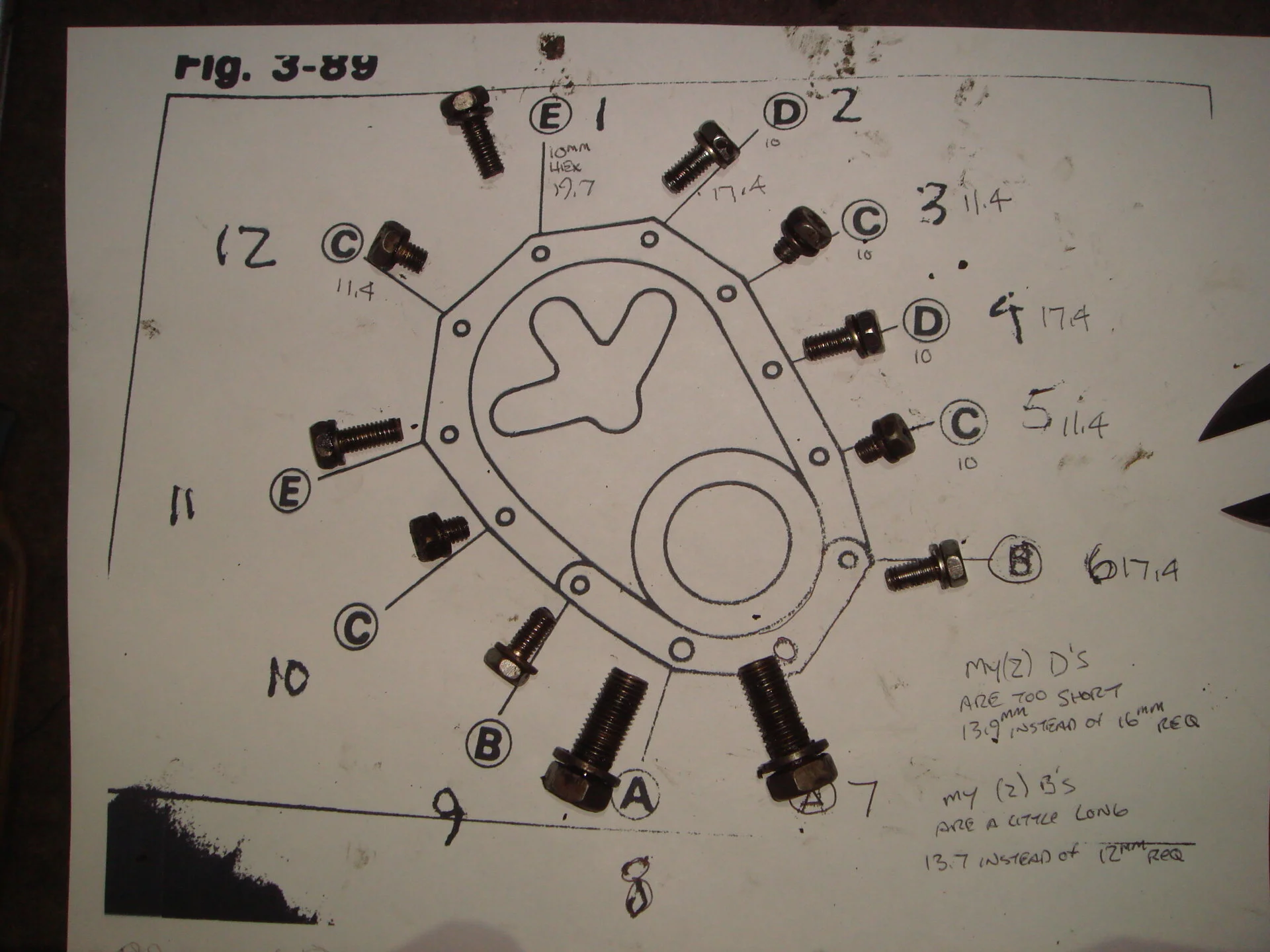

Anyone know the stud size
I think the 11.4 and 17.4 noted are my measured length of the entire bolt in millimeters.
My original “D” designated bolts were shorter than the spec: 13.9mm instead of the 16mm speced in the manual. Timing cover had never been removed before.
My original “B” designated bolts were longer than the spec noted in the manual: 13.7mm instead of 12mm
I reused them all. No problem.

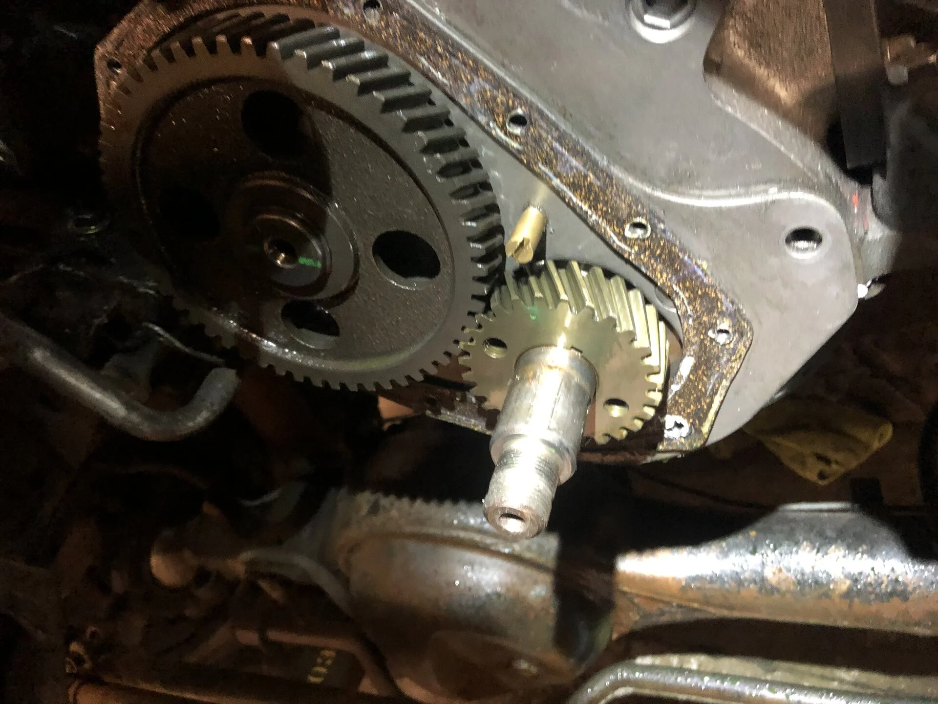

— If the bottom of the timing gear cover still drips oil even after resealing it , the leak source most likely is the timing gear plate behind the gears. Mine dripped a little bit but I left it.

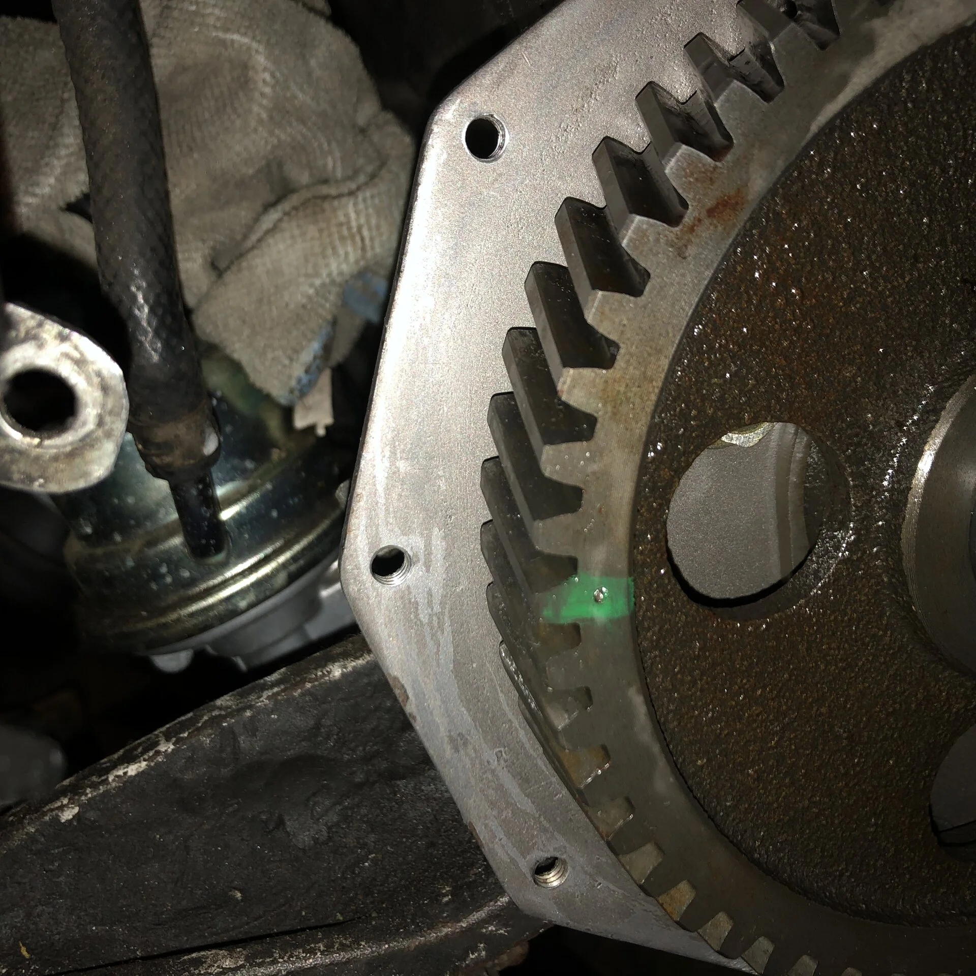

Did the job, all buttoned up. Having some post job concern, though, when I realize the last gasket, and the material wasn’t even stuck to the engine block at all. I thought that was confusing and just assumed it was because of a leak, but now I’m realizing the engine shop seems to have painted the surface. Will it not stick if there’s paint there, should I have sanded this down before fixing the timing cover? Here’s photos of what it look like.
This is also how far I put the oil nozzle in, I don’t recall if I fully turned it in but maybe someone can tell

I’m talking about the FIPG. In the prior gasket, I used gaskets inch. I’m saying what I’m concerned about is that the metal of the timing plate cover was painted over, does this cause our RTV/FIPG not to be sticking properly?
That doesn’t look so much like paint to me. Looks more like a stain from decades of oil being sloshed against the raw steel. Mine looked like that too. They didn’t paint the block. I’m sure they didn’t paint the timing plate too if that’s the case. Always clean the surface where gaskets and rtv will be used with acetone or brake cleaner and wipe until the rag doesn’t pull any more gunk up.
