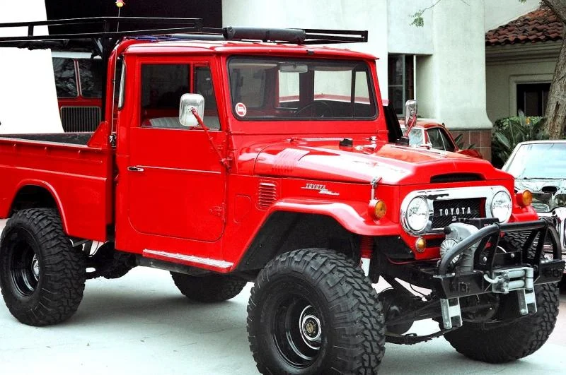

I just picked up a 67 FJ45 this past weekend. It runs like a top! Excellent sheet metal just a good base to build off of. My plans are to do a SOA,chevy V8,Lc 4speed and t case,Corbeaus,chevy tilt steering column,saginaw conversion,and various newer upgrades. With that said I will be getting rid of the motor,tranny and tcase and various other odds and ends. Here is some pics of the 45 and what i am wanting to transplant into it. All comments and suggestions are welcome!!!

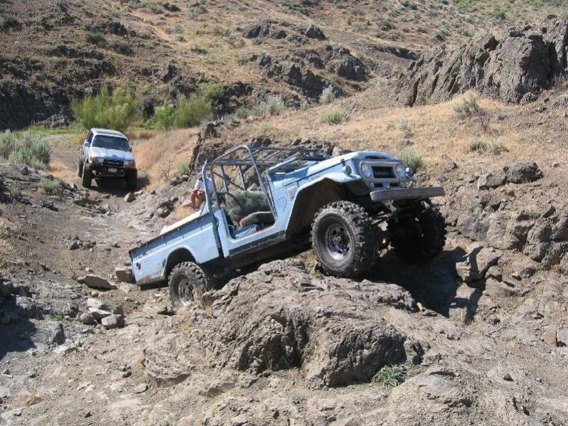

Here's mine, SOA, 2F, FJ60 axles, FJ60 front springs (puts the axle forward a bit), FJ60 4spd and transfercase...
What tire are you going to run, those swamper? I ran Q78s for a while, they're great and stuffed inside the wheel well, but developed a death wobble and I had to get radials. I have 37" MTRs now, about the same height as the swampers, but wider and they'll rub every now and then.
Dan

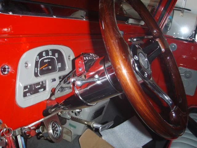

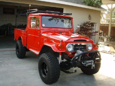

Should look similar to mine. 4" Alcans, 4-Wheel discs, 350 V8. T400 trans. Ididit tilt column.
Mike
I never get tired of looking at your rig Mike. I sure wish I could fit in an FJ45 pickup. If I could, I'd own one and it would look a helluva lot like yours - except with a white roof:D.
Josh

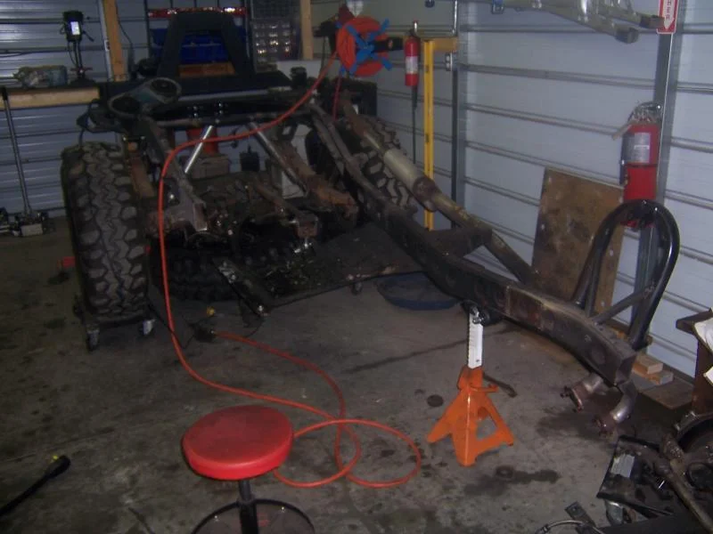

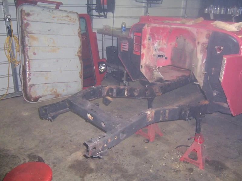

Some progress

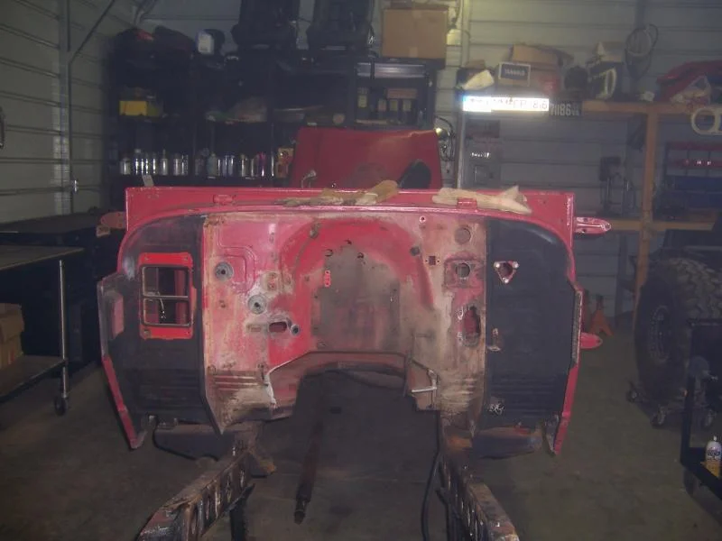

Well I have got a little bit done to the 45. The motor and tranny are gone and I started stripping the front frame. Next the cab will come off hopefully tonight. Some pics of progress.

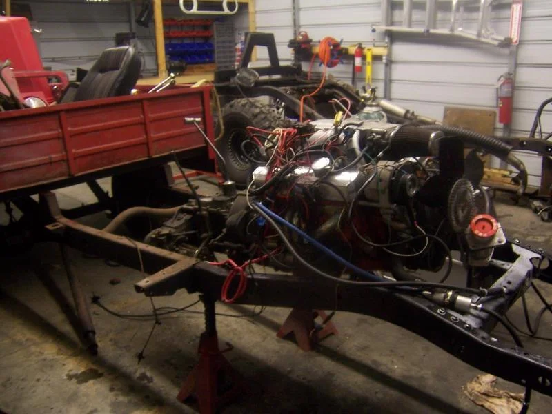

Mo progress
Well I have gotten the motor,transmission and transfer case installed today. Heres a couple pics plus one of the donor vehicle! Planning on getting the front axle installed tomorrow.

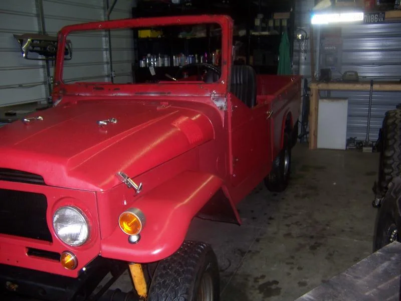

Sorry my build thread sucks! But Here is what I have got done this past couple of weeks. I have got the rear axle mounted, I swapped out the front springs to level the beast out. I have got the cab partially mounted. So here is some pics! Hope you all like it!!! The tires are 38 inch swampers and thats my 16 month old daughter next to it!!!
