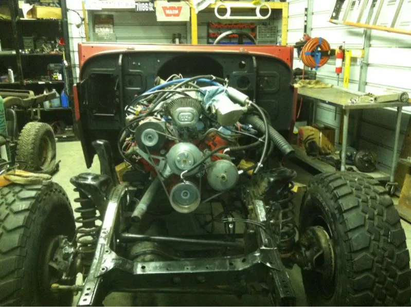

Got some more progress done. The motor and tranny is out of the old frame,cutting out what I don't need in the new frame! Post pics later,forgot to take some!

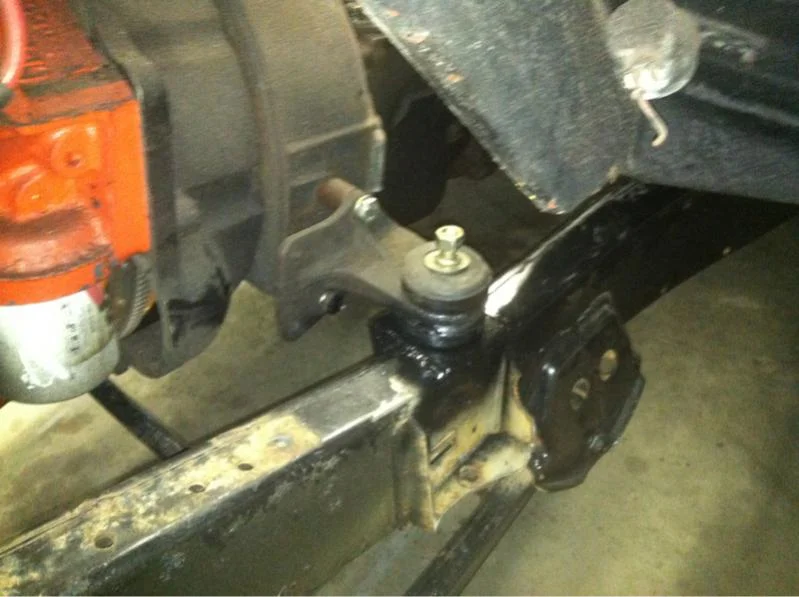

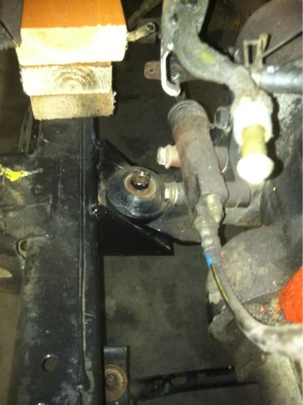

Got the motor sitting in the frame with motor mounts tacked into place. The tranny and transfer are sitting on the 80 crossmember have to figure out some mounts for it.
Got the motor mounts welded in and made tranny mounts, I just copied an original design and it worked! Also got a set of front 4 inch coils slung underneath it. Here is some pics
