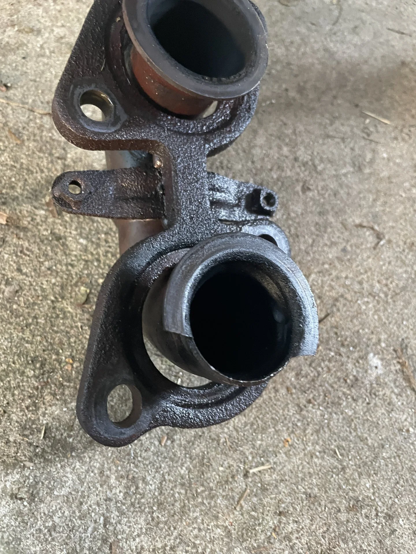

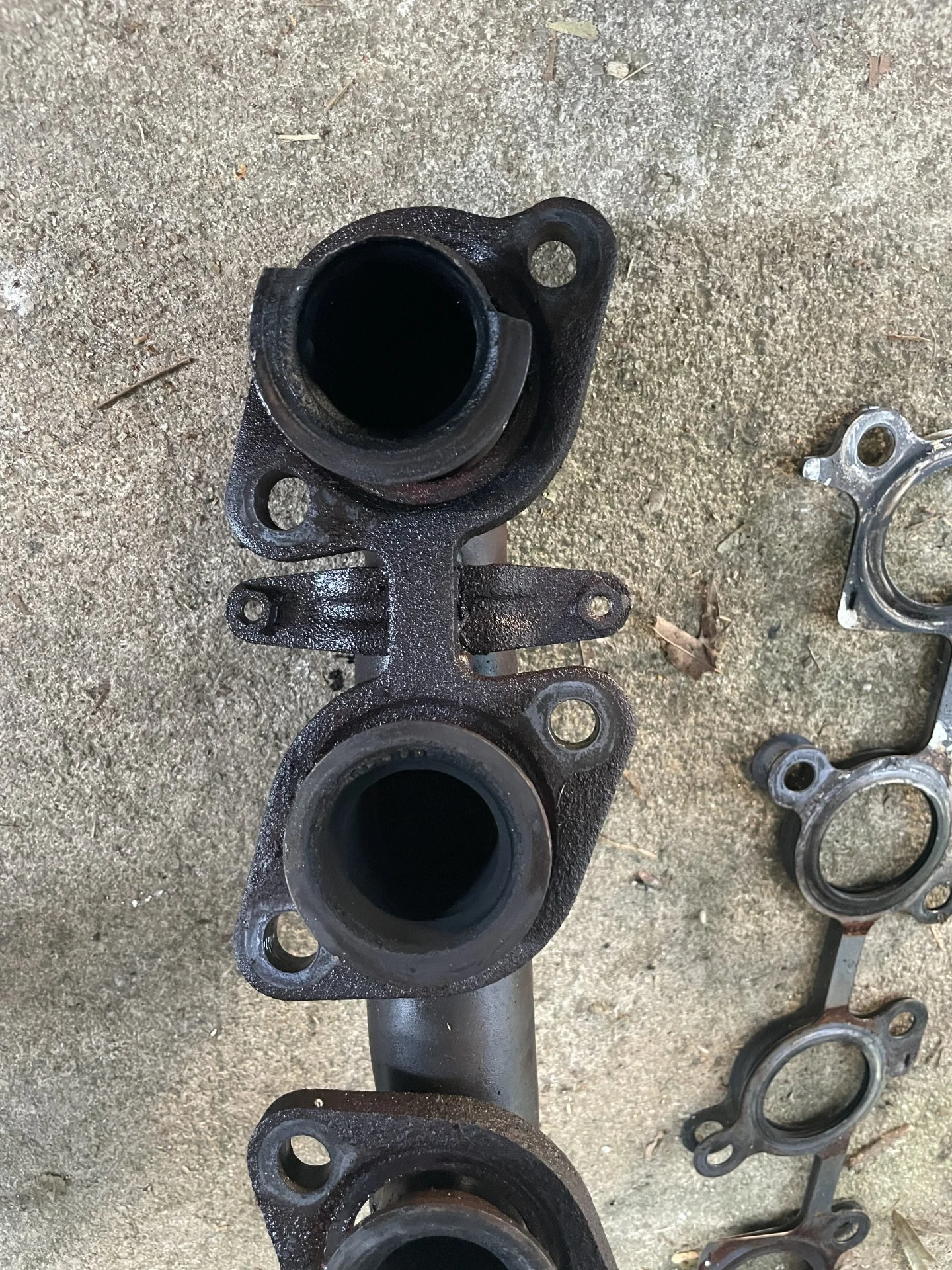

Slow and steady to get the old passenger (right side) manifold out. Tire off, thru the wheel well method. The lip had broken off the front cylinder (pics attached) manifold, which explains my ticking when cold for the last few years. Replaced all the studs and bolts while I was in there. Lots of carbon build up; had already replaced the plug and coil on that cylinder, so hoping everything will be good from here. 2000 w/ 251k.
