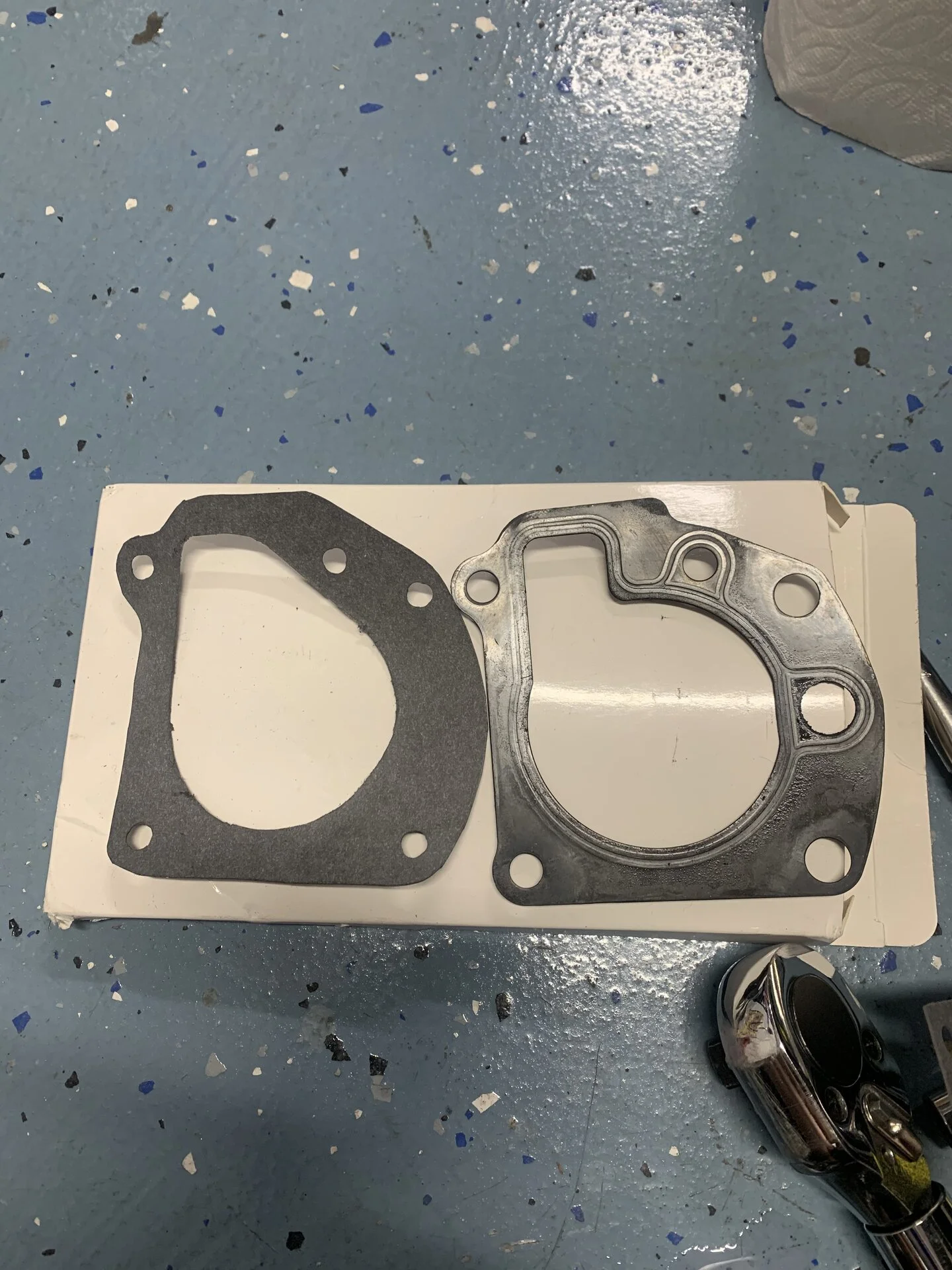

One on the left is similar to what I received from Jon Bond Performance. One on the right is the oem gasket from the throttle body to intake manifold. The first one does not have the extra hole. Which is the correct gasket for both supercharger to throttle body and intake runner to intake manifold?

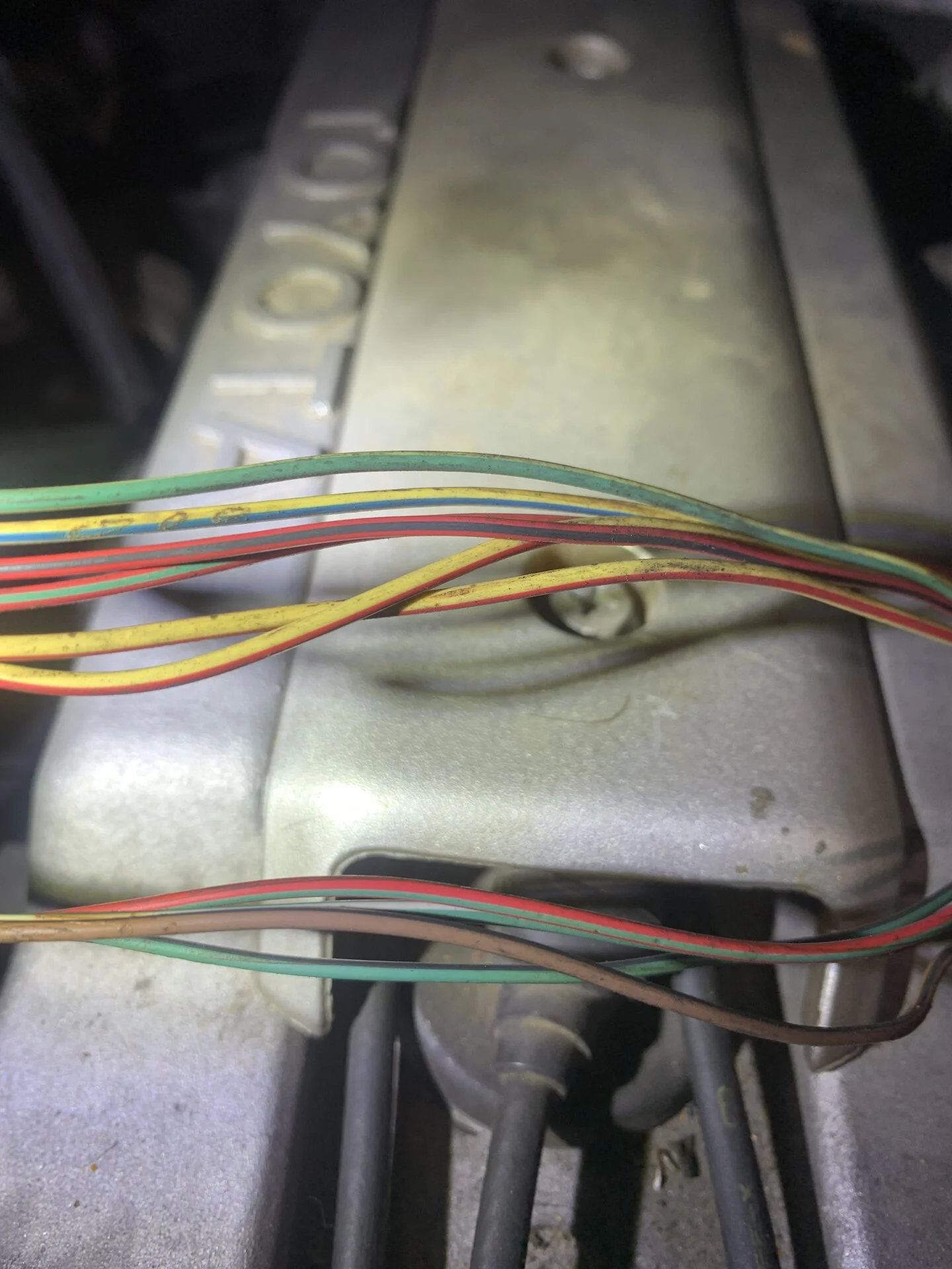

Also what is the correct wire gauge for the IAC / TPS wires? I tried extending the loom but it seems like I will have to splice regardless.
The intake runner to manifold does not need anymore holes than just the mounting bolts. So, the one on left will work.

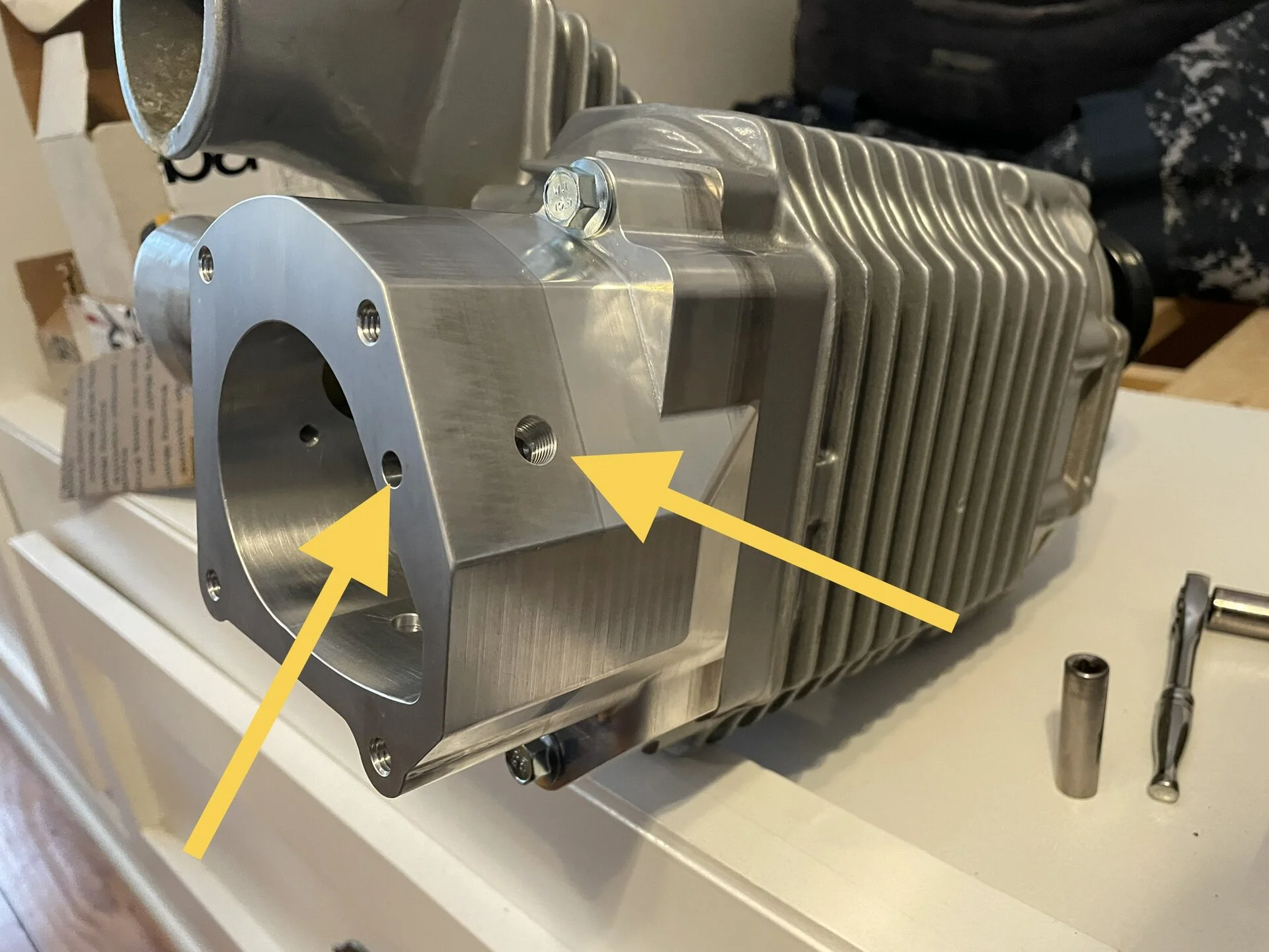

The throttle body adapter has an extra port for gasses to bypass the throttle via idle valve to control idle. The oem gasket is best for that.
You can also use 2 oem gaskets instead of Jon Bond provided one.
Thank you!
The one on the left will not mount to the upper intake as there are two hollow dowels used for aligning the throttle body and the holes associated with those are too small.
Use the factory metal gasket on the upper intake manifold and the other gasket on the throttle adapter.

Will the paper gasket obstruct anything in the throttle adapter since it’s missing a hole as stated by logicbyondreaso?
Ok great, thank you both. I dont have to remove the throttle body from the throttle adapter anymore 😬. Just ordered an oem metal gasket for the intake runner
