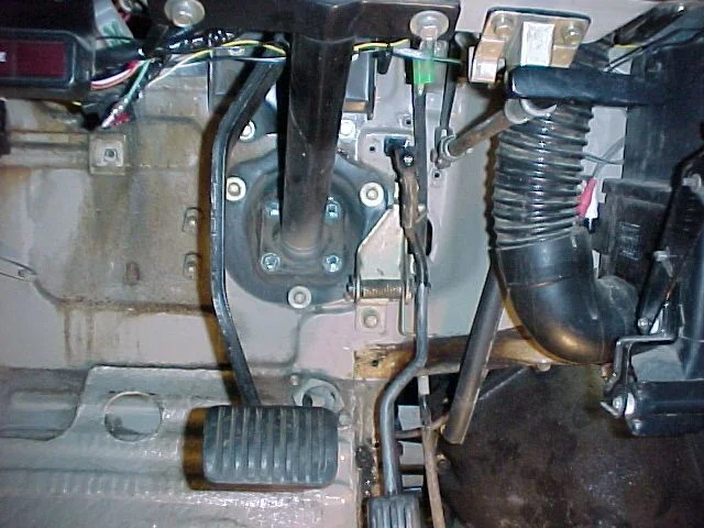

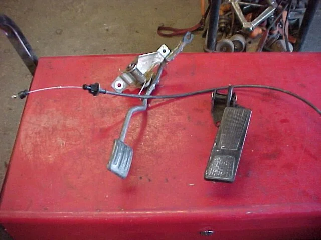

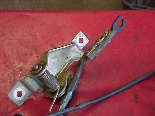

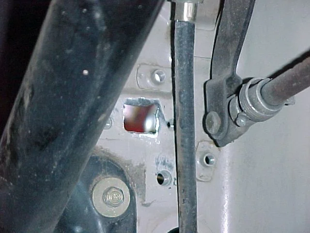

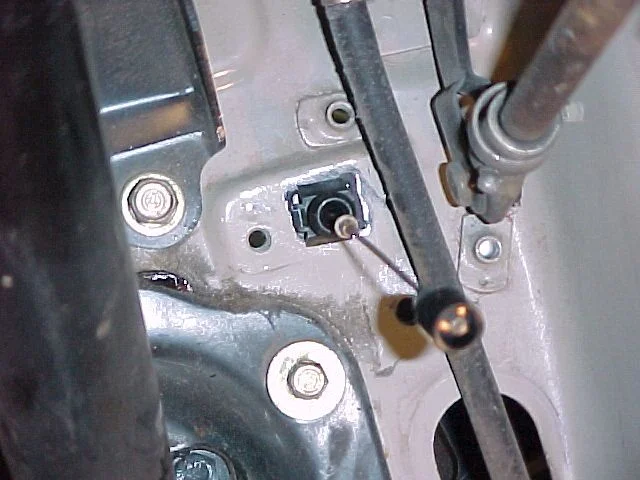

Throttle cable
Here are the components you will need, throttle cable 88 C1500 350 PU, LC pedal and an old GM pedal.....I used an older cable type LC pedal, but you can use the type that goes thru the firewall, just cut it and weld the GM end on......the GM has a plastic grommet that snaps into the hole, you could fabricate the hole and slot but this is easy
attachment.php
attachment.php

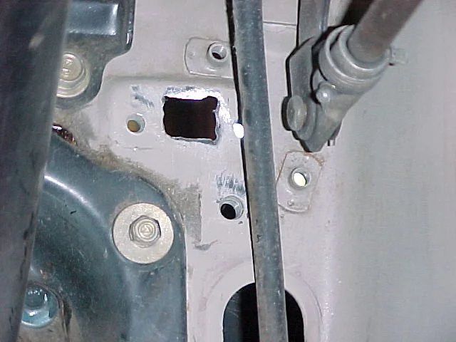

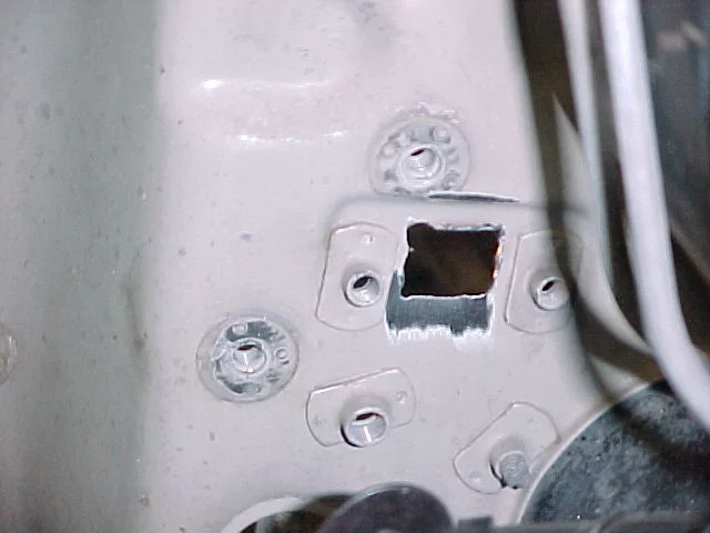

Next position the pedal and mark where you need the hole for the cable, it is a rectangular hole, I drill 4 1/8" holes at the corners then a 1/2" in the center, using a die grinder I connect the dots........first pic is the engine side, other 2 are under the dash
attachment.php
attachment.php
attachment.php

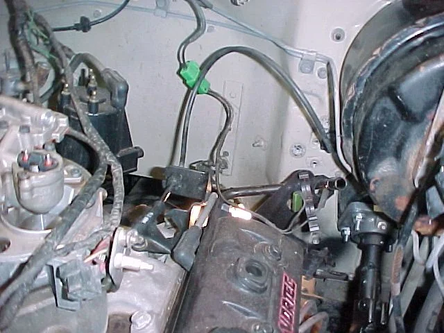

First pic shows the cable snapped into the firewall....then the engine connection, don't get smart and try and find one without the loop, it don't work well......don't ask how I know.......last one is all hooked up under the dash.....
attachment.php
attachment.php
attachment.php
