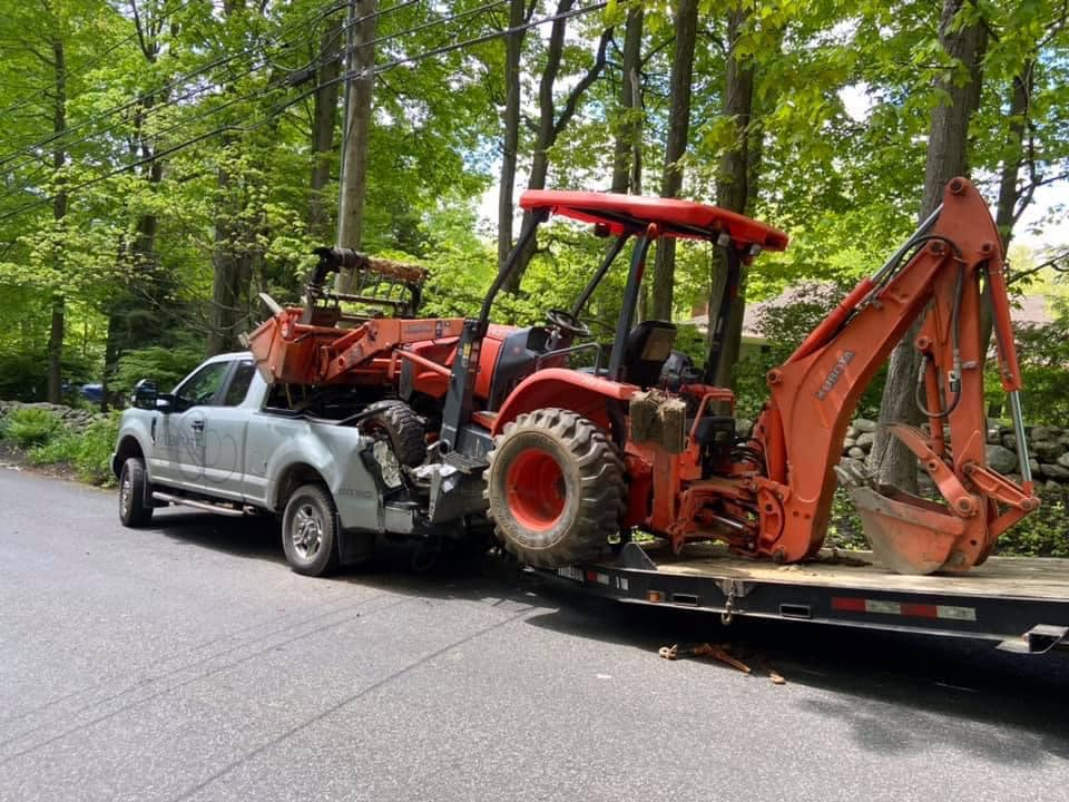

Solid job with the tie downs:
Not so much
