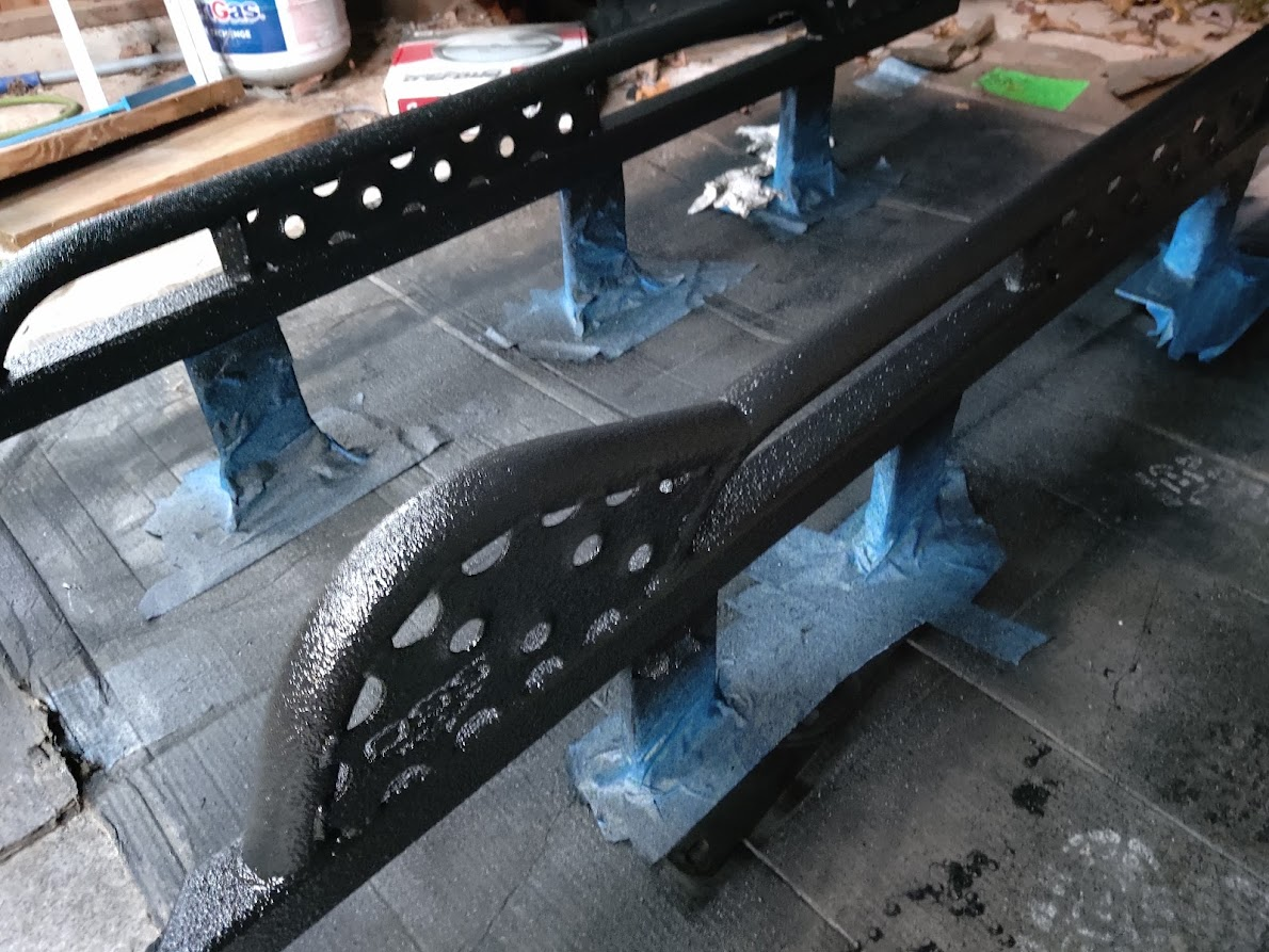

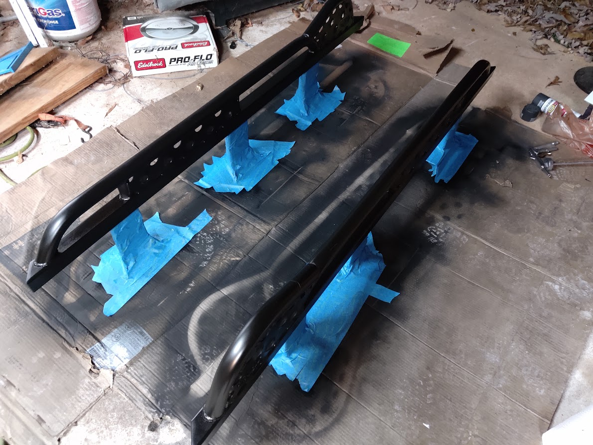

Tape is off and one last coat of paint is on the legs. Time for bed.
It's welllll past beer-o'clock but I'm still getting after it. Bed liner is on. Awesome stuff.
Now we have to patiently wait.
In other news, the Diode Dynamics light bar is going to be here on Friday. Perfect timing.
That bed liner should give you good traction from mud, snow, ice, etc. when standing on them!
