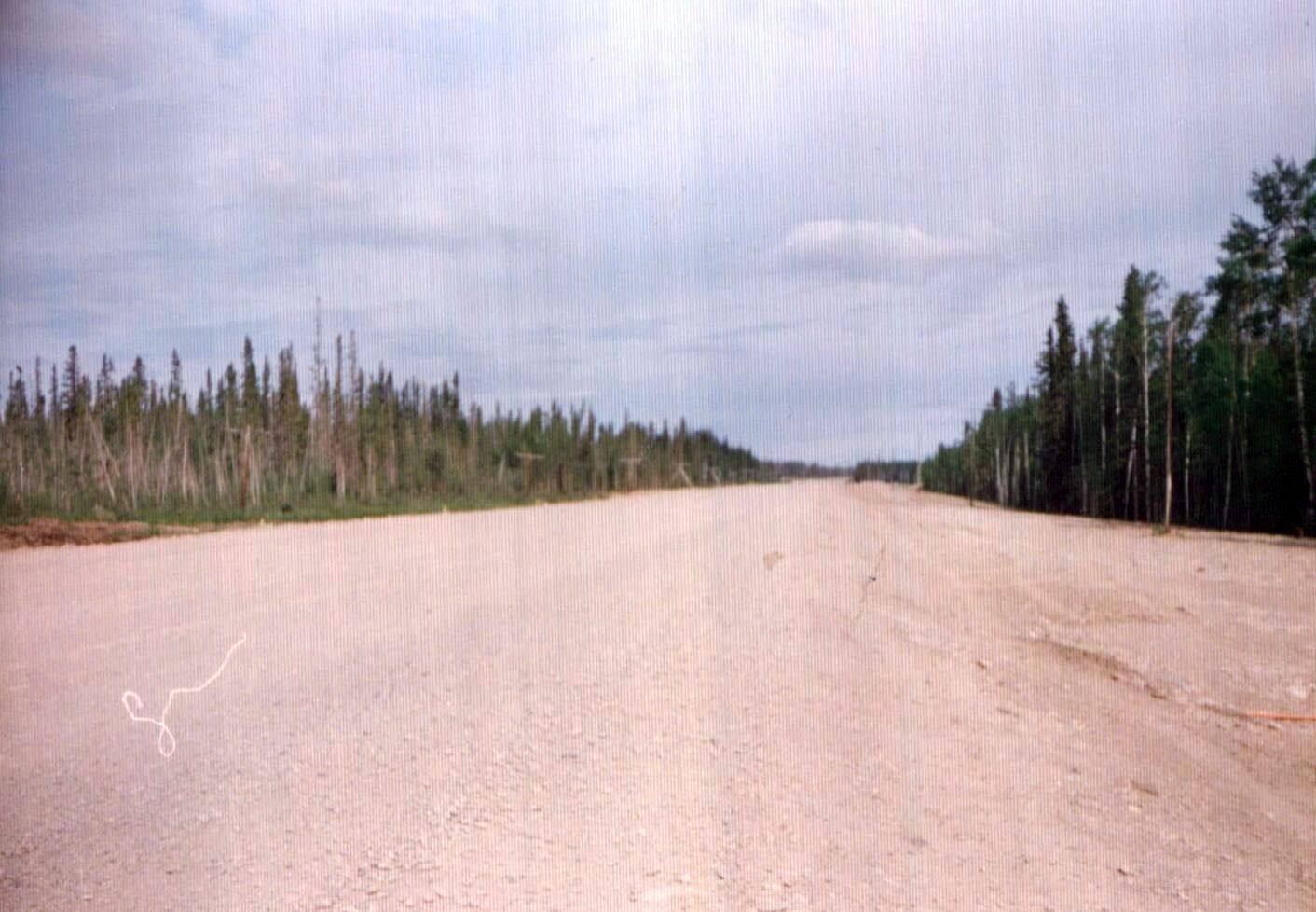

My dad and I did this back when it was just dirt, in a '62 Studebaker Champ.

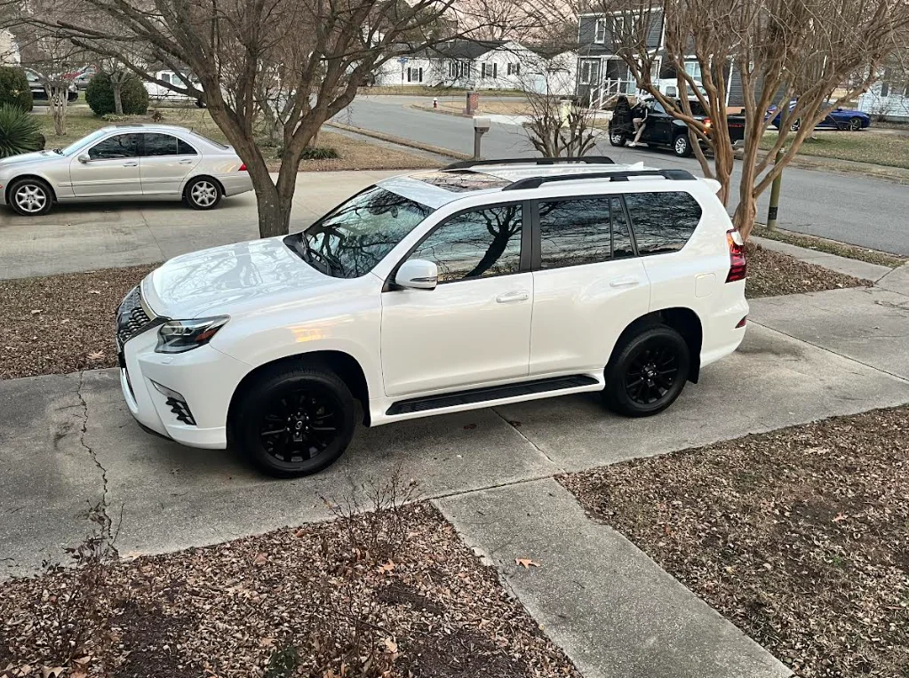

Wow - thanks to everyone for the input. Sounds like I'm dramatically over-preparing. I'm looking to spend no more than about $2k in prep (besides, of course, the trailer or camper), and sounds like that's real attainable.
Just ordered the OEM hitch from Bell (20% off + free shipping - thanks, Cold!) Truck came with brand new tires, but as you can see from the pic, they're nothing impressive and certainly won't hold up under any off-roading out in AK. I'll steer clear of studs and start to shop around from some cold-rated A/Ts as we get closer to departure time.

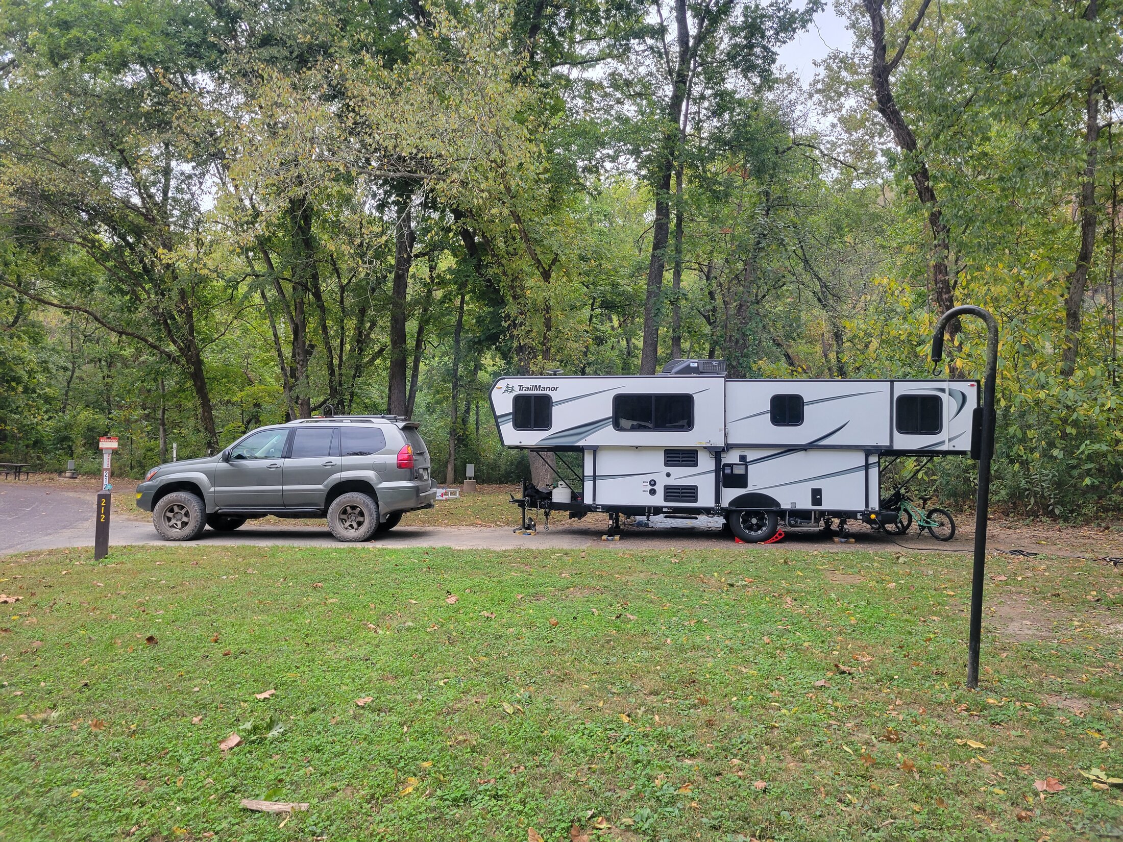

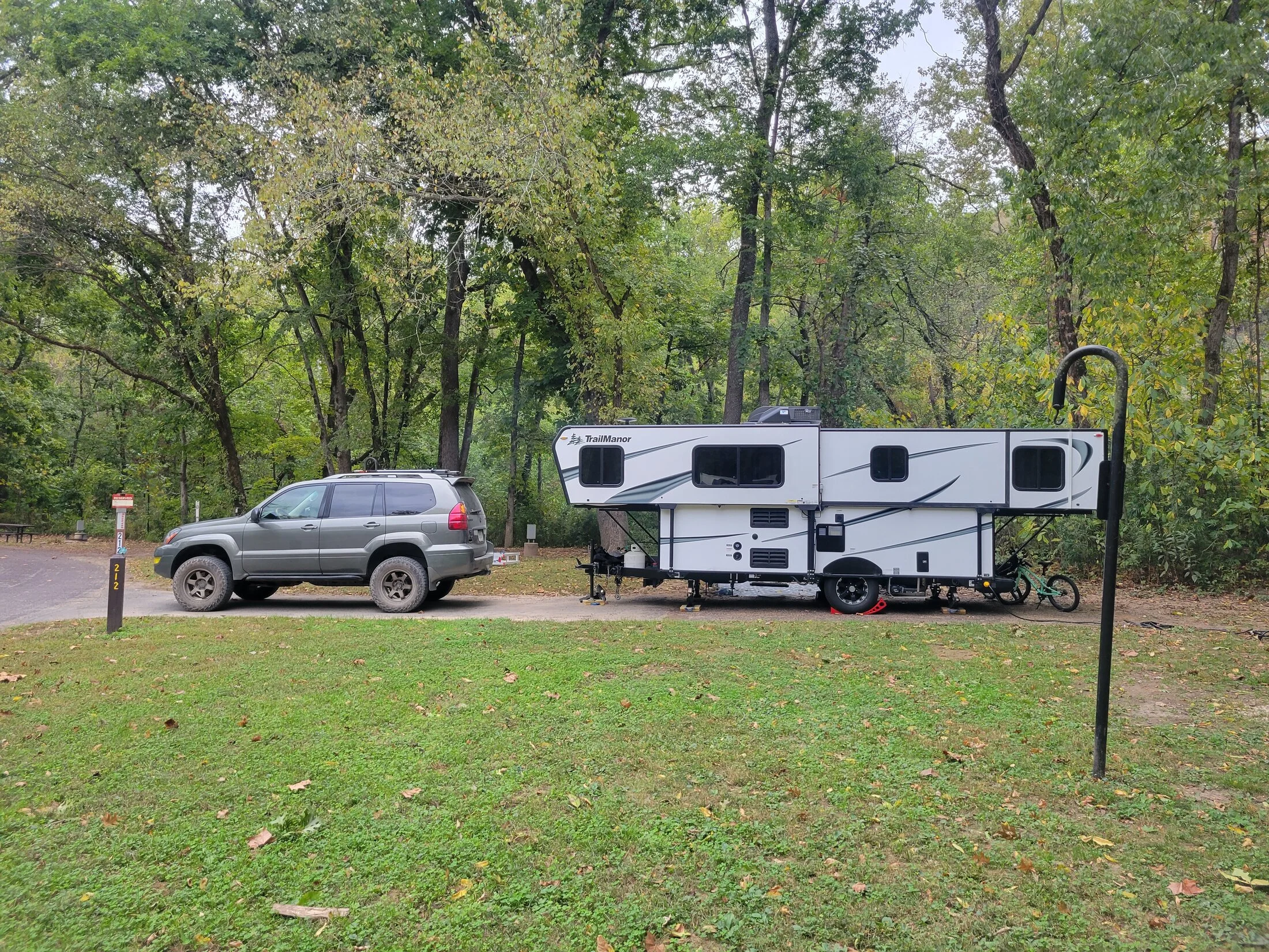

I did the break-even on our camper vs. Airbnbs and found it was 17 days per year of use over a 7-year period. My analysis considered cost of the camper and insurance, campground fees, reduced MPG towing, and resale value of the camper at Year 7 etc. But, it didn't consider ROI we missed out on from taking the $$$ we spent on the camper and putting it in a interest-bearing account instead. Ours is made by a Hutterite colony in South Dakota (seriously), rather than sketchy people in Indiana, so it's pretty well built. It also tows great behind our GX, and we get around 11-14 mpg, depending on speed. Being solid-sided, it's also acceptable for use in bear country. But, it's also a 3-season camper, and not something you really want to be in below-freezing.
You'll never find a real way to financially justify a camper purchase unless you work on the road and live out of one. A lot of guys who work in construction drag theirs across the country, from job to job, and pocket their per diem/living allowance. That's not most of us, however.
The reason to get one is that you'll camp 3-5X as much once you have it, and get to visit a lot of new areas. That's been our experience, and we've had no problem hitting the break-even days per year. The ROI on our camper is memories our kids will have when they are older. In July we're towing it to Yellowstone, Glacier, and the Black Hills. It's already been within eye distance of Canada and down to the Gulf.

We have friends with that type of camper (pop up and pull out, or is it pull out, then pop up?) and for an overnighter or weekend, to me, seeing them set it up, seemed like more trouble than it's worth. But considering the OP will be living in his and constantly opening and closing, it may not be a bad choice aside from it not being 4 seasons.
